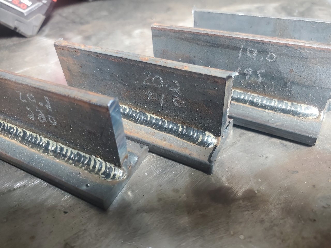

    So I keep finding myself running too cold.
    It's like shooting long range and forgetting to make "bold" adjustments.
    1st T (long one up top) I was at 18.5 180IPM (wire speed)
    2nd T 19.0 195IPM
    3rd T 20.0 210IPM
    4th T 20.8 220IPM but also moving faster compared to the first three -
    Last one is a good deal flatter since I ran it 'hot' enough

    If you're consistently running too cold, you're probably running too fast. Slow yourself down with the same wire speeds and heat and see how it look, forget about burning through for a min.

    Does your class break/bend test the welds? Sometimes what looks cold isn't.

    I should record myself; 2 people watching me said I was going too slow. I mentioned that when I run at a slow, consistent pace I can be really steady and even (glad that's not an issue).
    My flattest pass was also my hottest, and quickest.

    good point
    even cutting through it for a cross section would help judge that

    Yes but we have a substitute today so no testing welds.

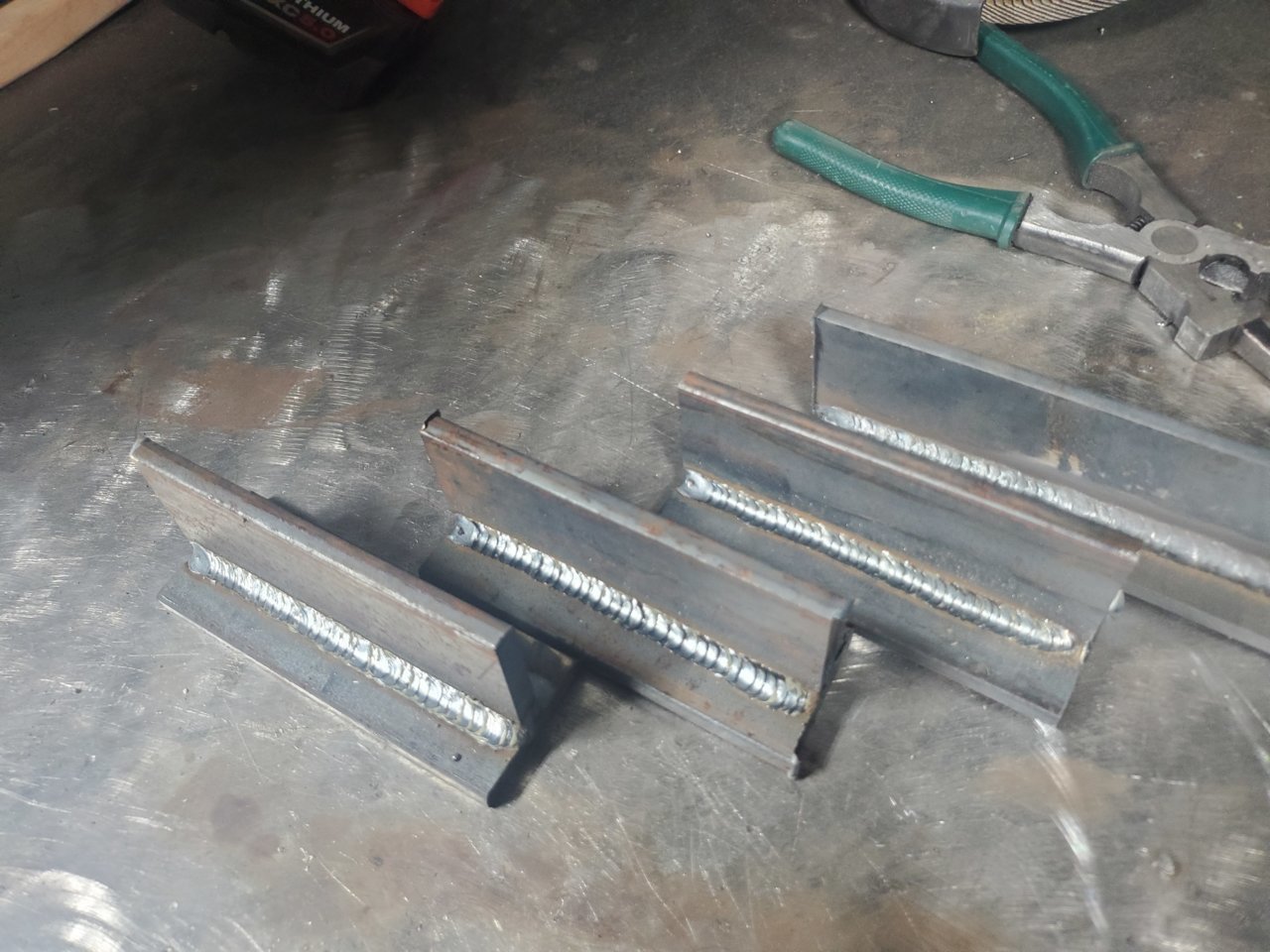

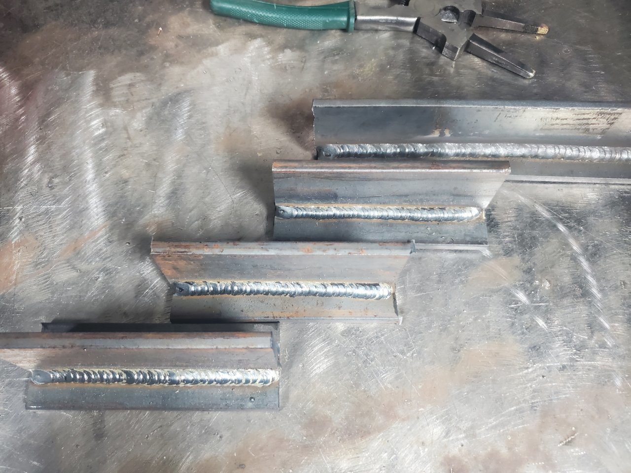

    A close-up comparison

    You know what though, my untrained eye is telling me I'm a bit cold when really I can't tell unless I cut it.
