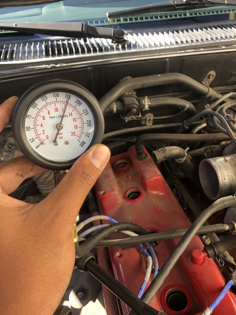

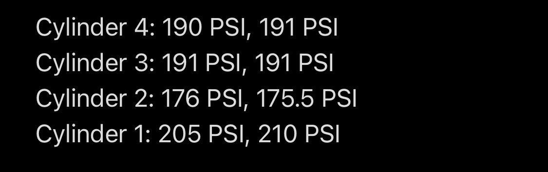

    Ran a compression test on the truck. Thoughts? Am Concerned about Cyl 2.

    How long since your last valve clearance check?

    Never been done. 130k-ish miles.

    better fix it before you burn a valve :luvya:

    that said 175+ across all is good to go in my eyes :burp:

    After Timmy’s 5VZ valve clearance check video I’m really paranoid about my 99. I know the 4 cylinders are more likely to have issues though and need more frequent checks.

    It bit mine at 200kish miles. I have pretty complete records from the previous owner and I didn't see any valve clearance checks in there, so I dunno when it was checked.
    Recommendations I've seen are to check every 50k.

    There is a variance between them though. I thought a 30 psi difference between cylinders was the tolerable limit. I can't remember.

    Maybe there's still some blue shop towel stuck in #2
