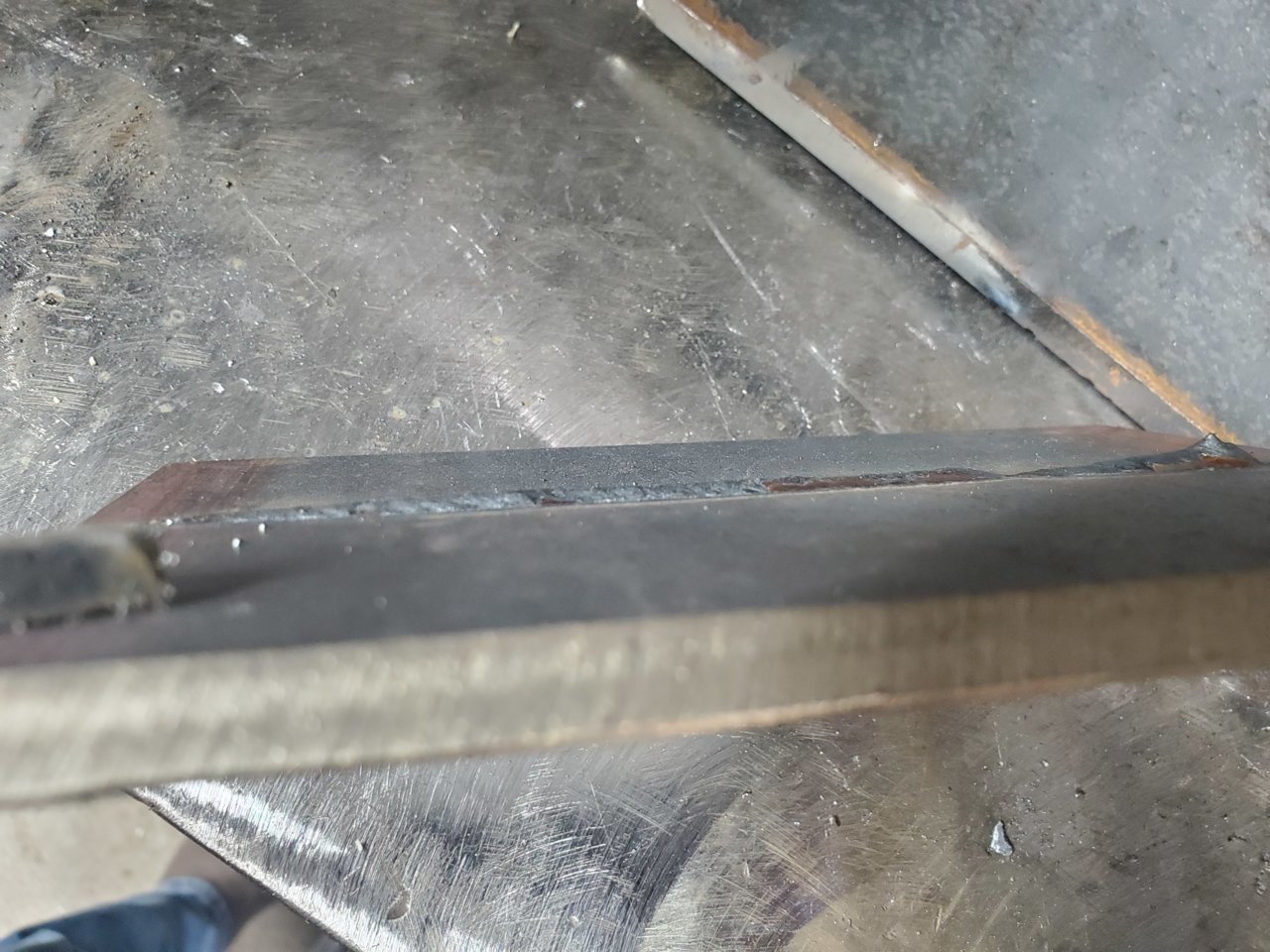

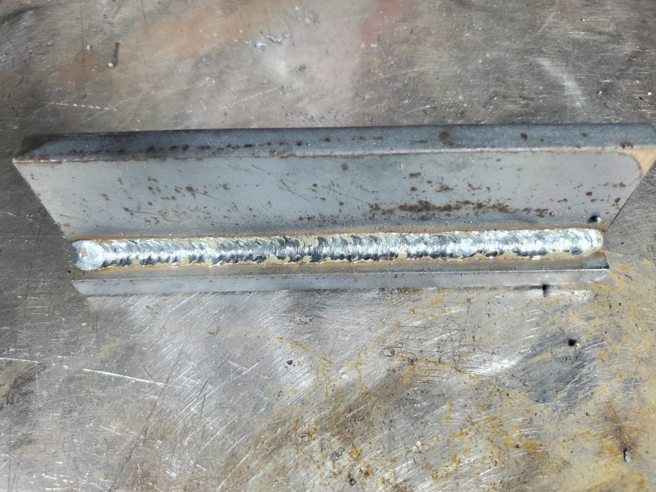

    4 run, 2 don't
    Learning more and more.
    Some would say weld #2 is better than weld #1 (which, is pretty consistent)
    But #2 is toed a bit too much as shown below
    Versus #1

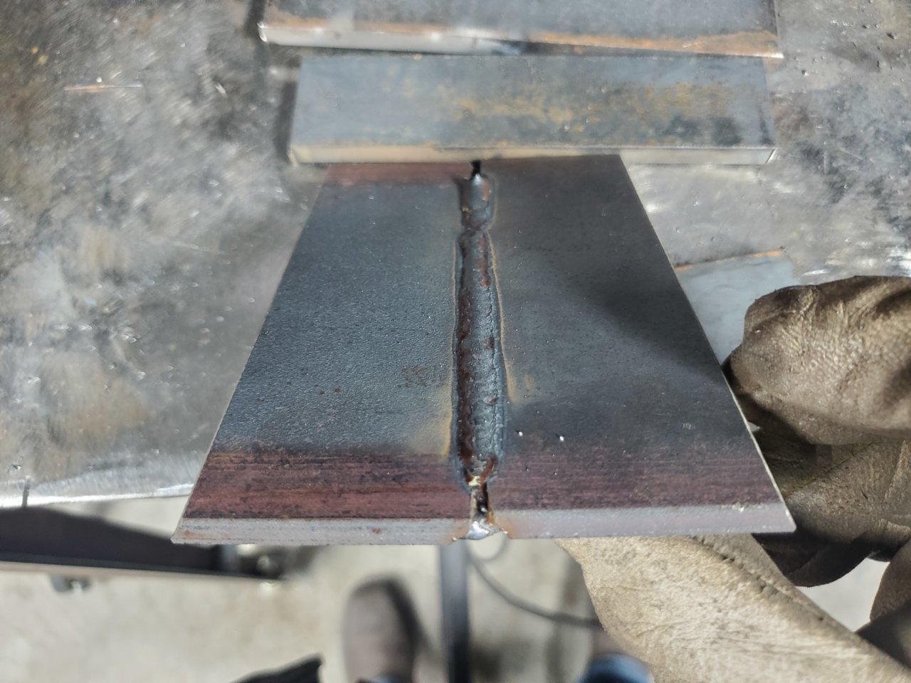

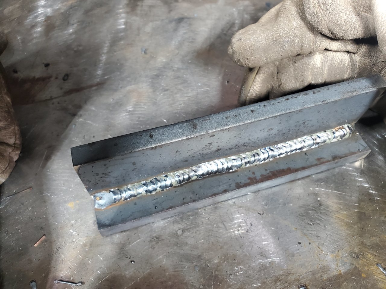

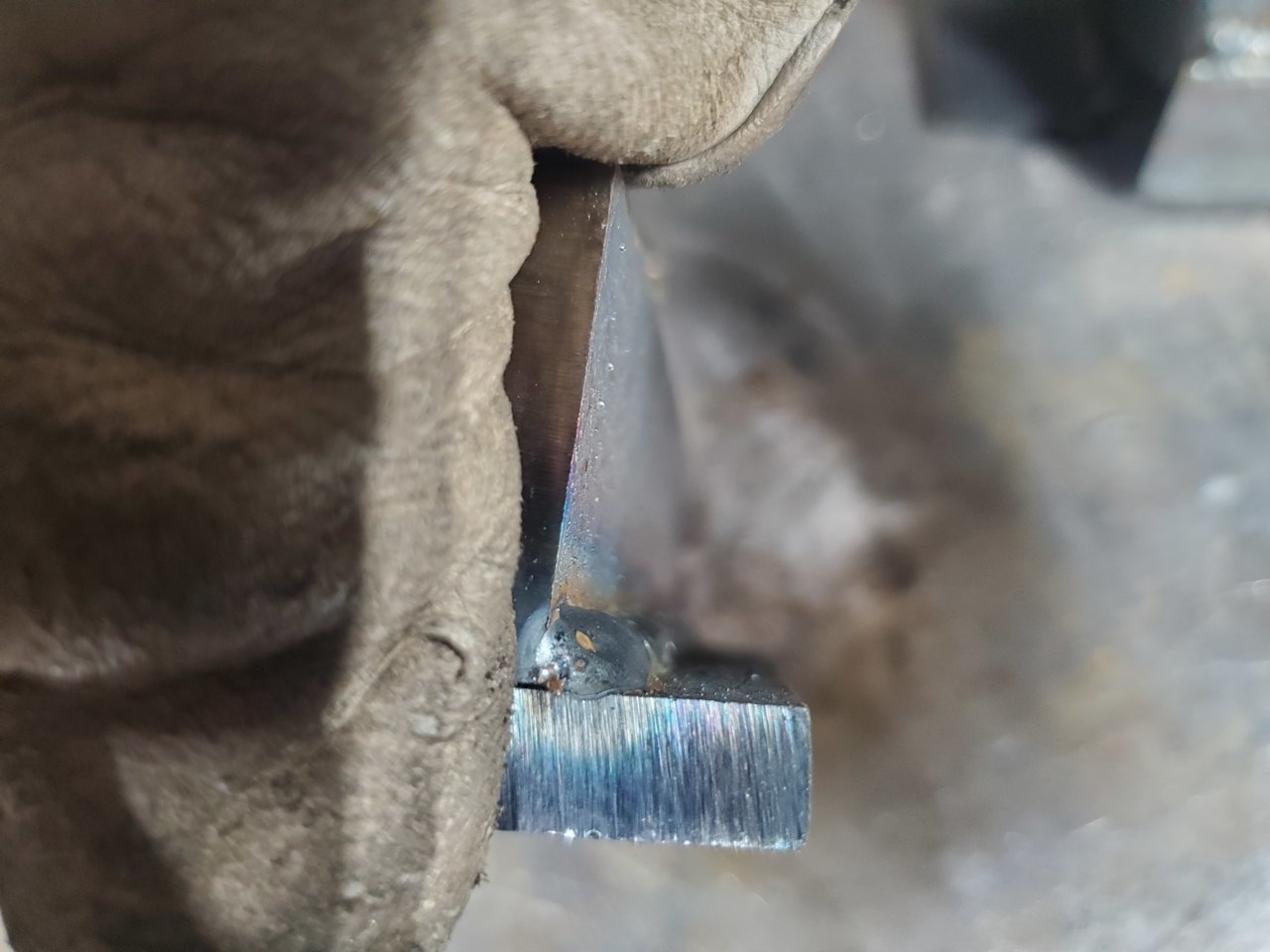

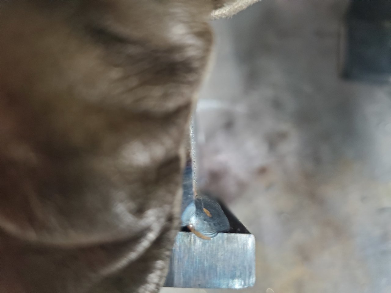

    4 run, 2 don't
    @Speedytech7
    @Blue92
    First time running on a v groove; figured out pretty quickly I was running way too hot, and I need to run a longer arc.
    Consistent though, no?
    At least it stayed well under 1/8" on the backside with good penetration
