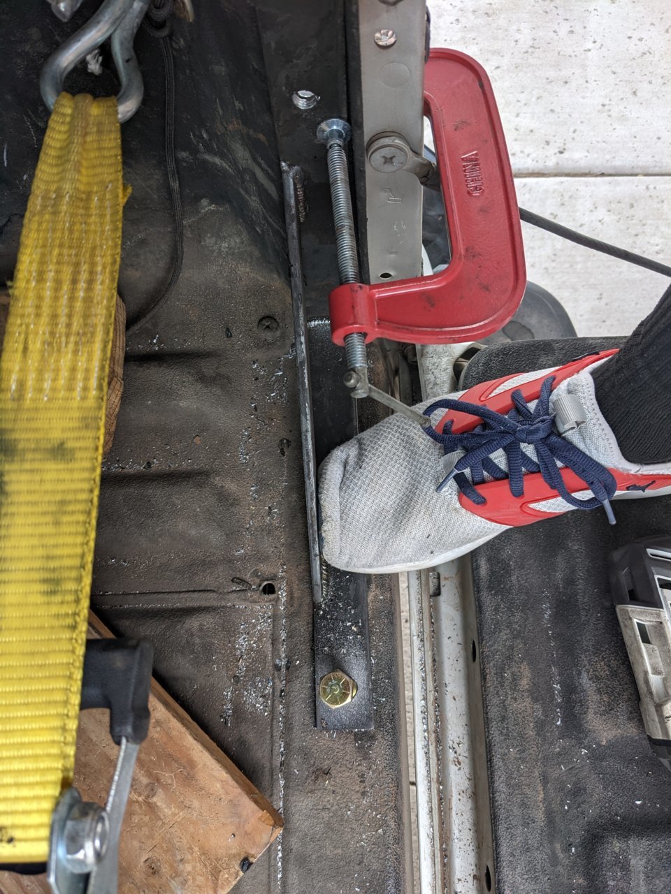

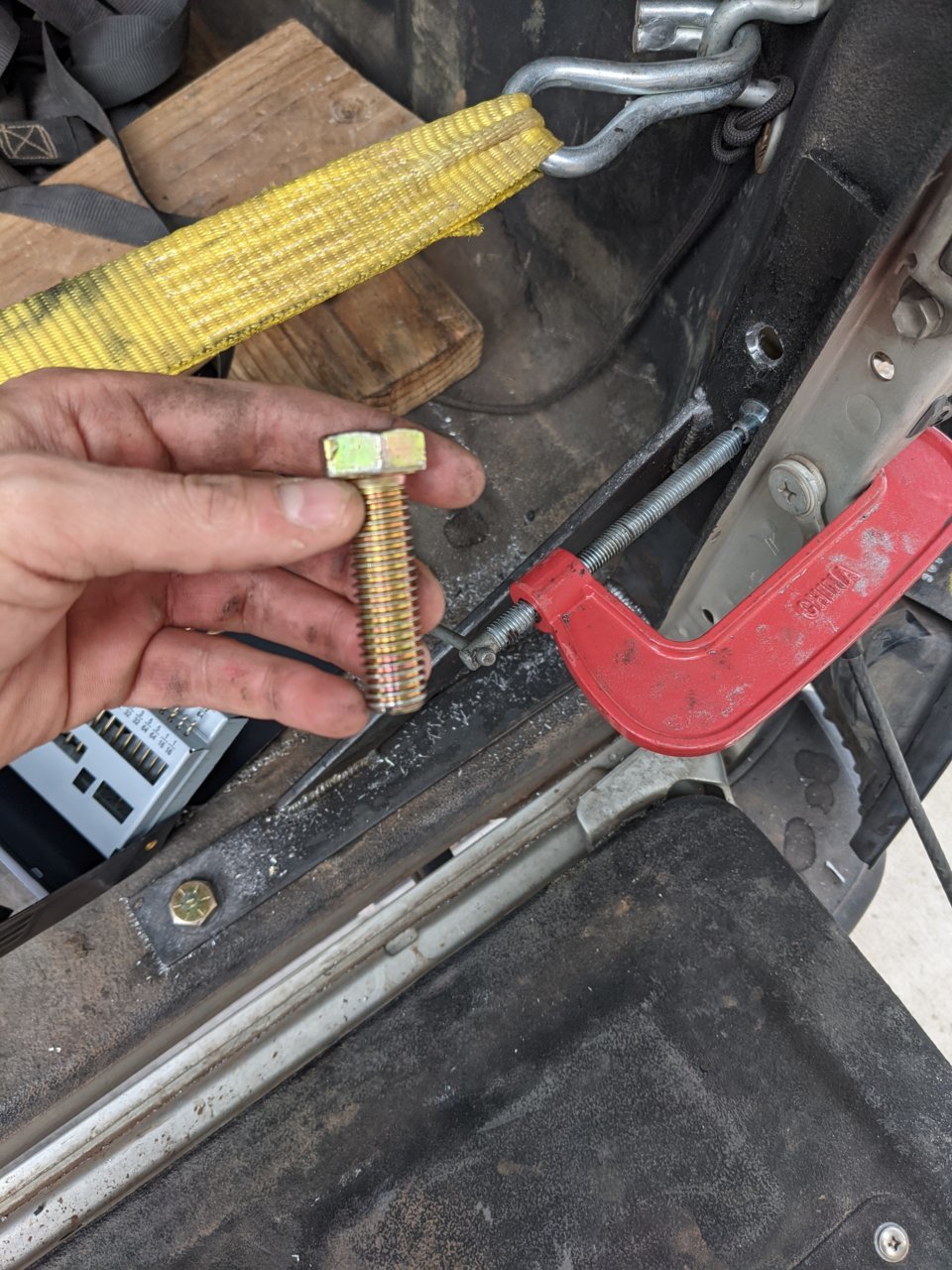

    Did not realize how thicc these bolts were until i started working to make them fit. Pain in my ass, ate my batteries already.

    Why not just block the stock bumps?

    It's all in the drill bit
    And proper footwear :anonymous:

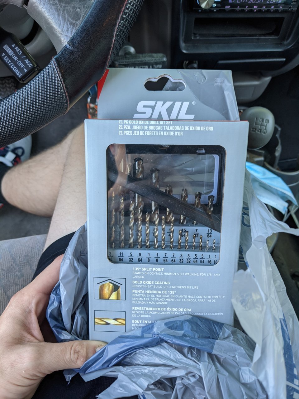

    Shits like 1/4 inch steel, takes a min to go through it with a power tool regardless lol. Did get a new set on sale and they were Minty

    Ya those are shit
    Get a decent set of steppers, you can go through 1/4" in 30 seconds and it won't wear out if you mind the heat.

    Push behind the bit enough and it gets the job done :luvya:

    Also helps if you have a drill press and punch to do the top piece first. More direct force, no wander, not battery powered lol
    But that probably should have been done by the fabricator :boink::D

    Don't know how far forward/back he'd need holes, not to mention the underside of the bed and what's below it.
    A hand drill, the right bits, and fluid will make quick work though.

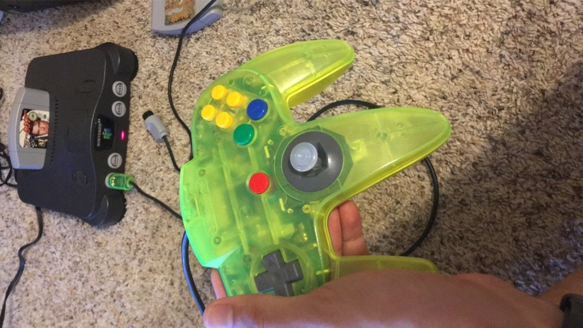

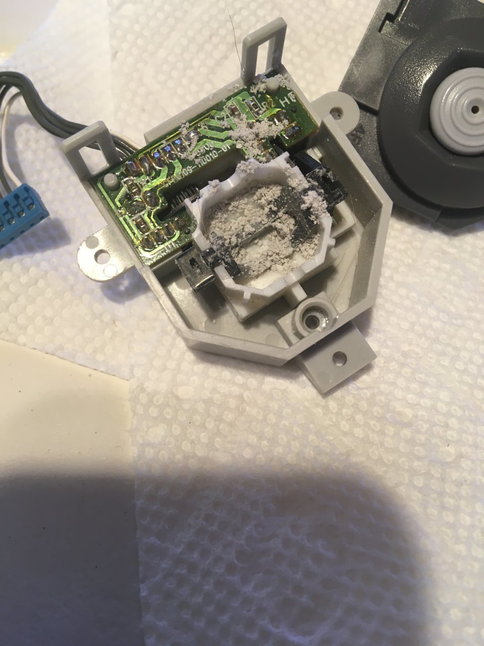

    Repaired some original N64 controller sticks for some friends. Used a company called Kitsch Bent to replace the bowl, pivot gear things, and stick. But you get to retain the factory housing, sensors, and board. Feels a lot nicer than Chinese full replacement units.

    Nice!
    Its those joysticks that end up giving the ghost.

    Almost done with one side, ears are ringing. Break and recharge time again

    It's less Tacoma and more mod
    I think you might have dull bits from using them wrong, that should have taken like max 15 secs per hole

    Thinking about nabbing a step bit and taking an l
