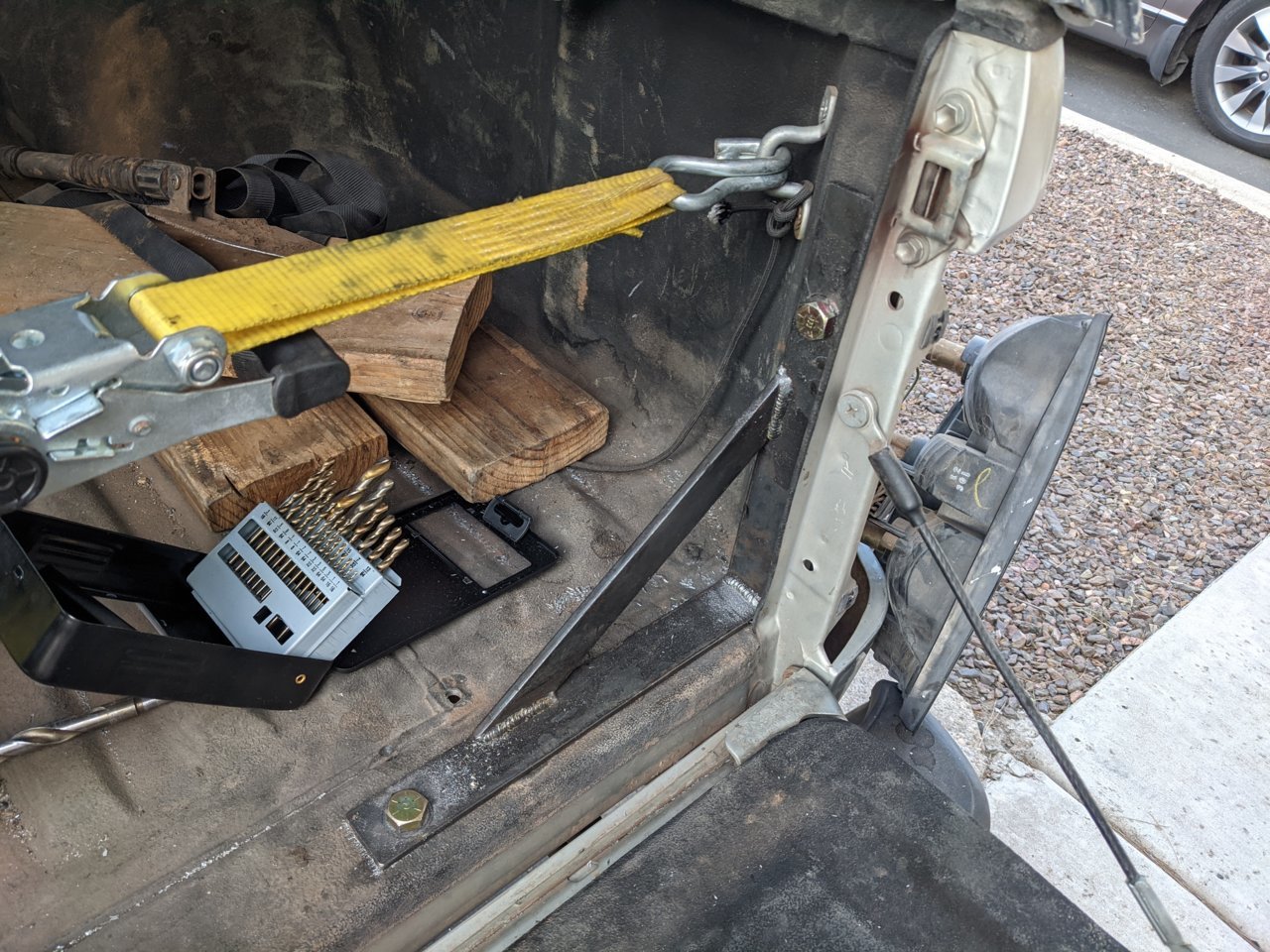

    Lol damn, a 9/16 is way over kill for that and only one per side isn't enough to combat flex, three 3/8 would have been more appropriate or maybe two 1/2. You need to spin larger drill bits slower, can't be full sending them or they'll dull from too much surface speed.

    I like to hit it with a punch twice to put a nice indentation so the drill bit doesn't walk.

    And use plenty of pressure. Too little and they just slide instead of cut.

    Yup exactly, less speed more feed

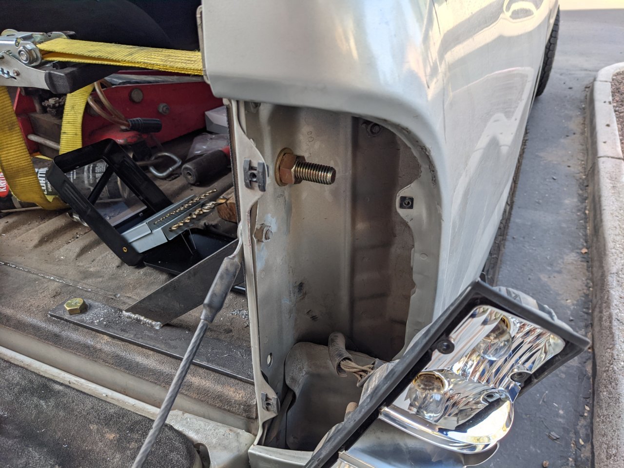

    Shit so u think one per side with a nut and washer impacted down wont hold? Ill need another? Yeah i was going slow at first but the old arms were dying hahaha

    It's easy to start spinning the drill faster once it starts to bite, but really it's the slower speed and downward force that'll help cut through the metal.

    For sure! need to cut off maybe a half inch from the bolt to fit but one side is done

    That came out well. I guess you lose a little space at the corners of the bed for sliding stuff in/out but if it keeps the bed from splitting and splaying outward then it's a sacrifice worth making

    That's the cleanest that's been in a long ass time

    It's only cause of the bolt used for the D ring he has, otherwise I marked them for the brace to be towards the tailgate for minimal loss of space.

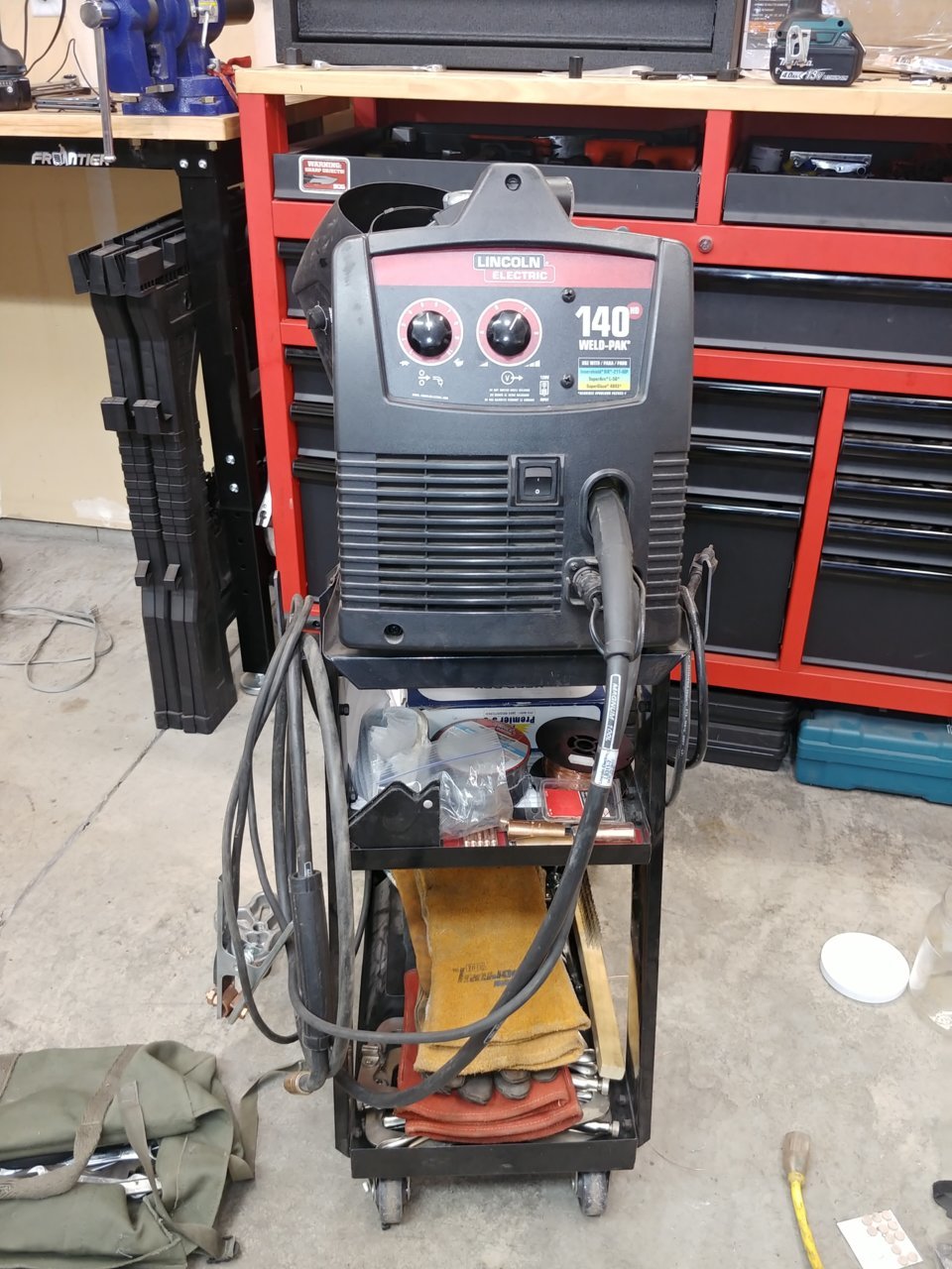

    I found the smaller Lincoln welders are a little finicky, but the big ones are nice.

    I've never really had an issue with Lincolns of any kind. I really just have issues with Harbor Freight units, usually they start with poor inrush current and breakup for a second. I'm eyeing a Miller 250 next for the garage. But also kinda thinking I want to get a bigger multiprocess so I can justify having TIG around too. This Lincoln and the one at the shop however have been great from start. I think they might be annoying to someone starting out because they don't give a lot of fine adjustment for power so they expect you to tailor your usage of the gun to make the in between.

    Tbh I'd do two more - about 1.5 to 2" from the corner as well on each face

    Also, I'd use crush washers to prevent backing out over time.
