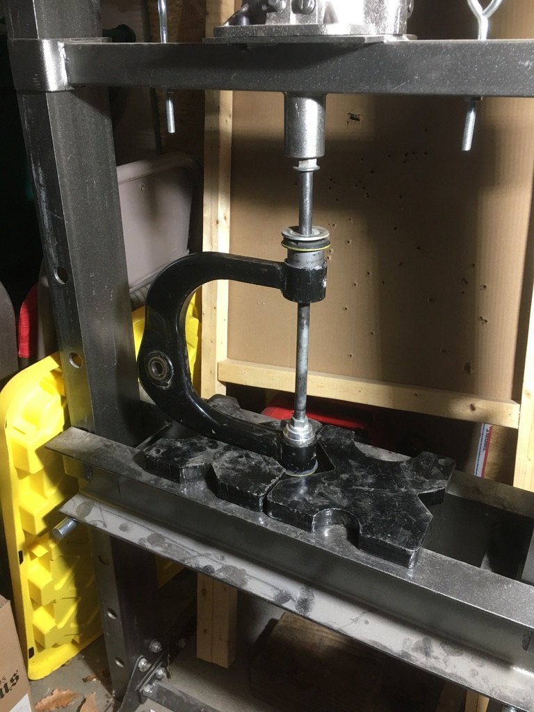

    Ya. I think I’ll just file them down and call it good. I think there’s enough thread on the bolt to take up the slack if the entire arm was made a little narrow.

    Do you have a shop press? If you greased the bushing sleeves before installing you can use the UCA bolt as a press adapter to push things back a bit. There's a risk of bending the bolt (that's why it'll only work on freshly-greased bushings), but it worked well enough to extract my good bushings after the shop messed up the control arms installing them...

    Hum. I do have one. Maybe.
    These are new ucas and they came with bushings installed. The one that was too wide popped into place with a pretty good bang so I don’t think they were greased much.

    Yeah that's iffy... you can always try and back off if you see the bolt deflecting more than you're comfortable with.
    Judging by the picture, you might even be okay as-is if you can get it in place? The rubber is designed to give anyway.
    I'll defer to the more experienced mechanics/mekaniks on that...

    Judging by how loose the oem ones fit, I don’t think this is a precision fit. As long as all of the surfaces are square it’s probably ok.
    I’ll sleep on it, I mostly assembled the suspension on the other side and it’s looking good.
