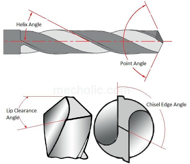

    No there isn't, check the side profile of your bit. What's called the lip clearance angle in this picture
    If the leading edge of the clearance angle is lower than or equal to the trailing edge you won't cut for shit and it'll need resharpened.
    When you get good enough, you can put a 135 degree back on the tip with a hard disk hand grinder in the middle of a field. I'm not that good, but I've met guys that are lol

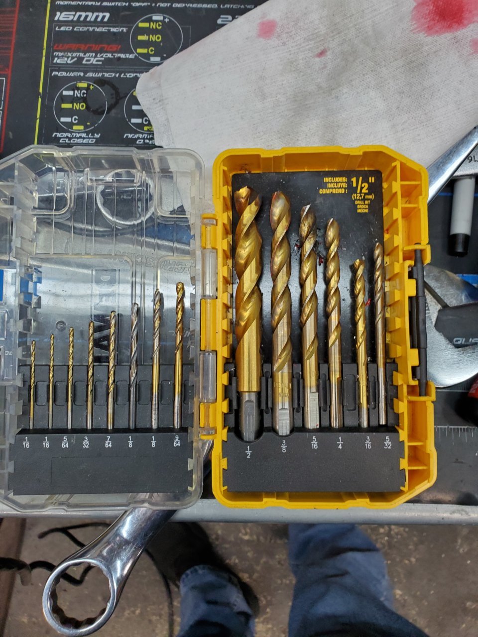

    @Das it mang I second this recommendation, I use this kit everyday for work. I think they're the cobalt vs the black oxide 20211109_113512.jpg

    I've been abusing a set of these for years
    Great purchase for $15 or whatever they originally cost
