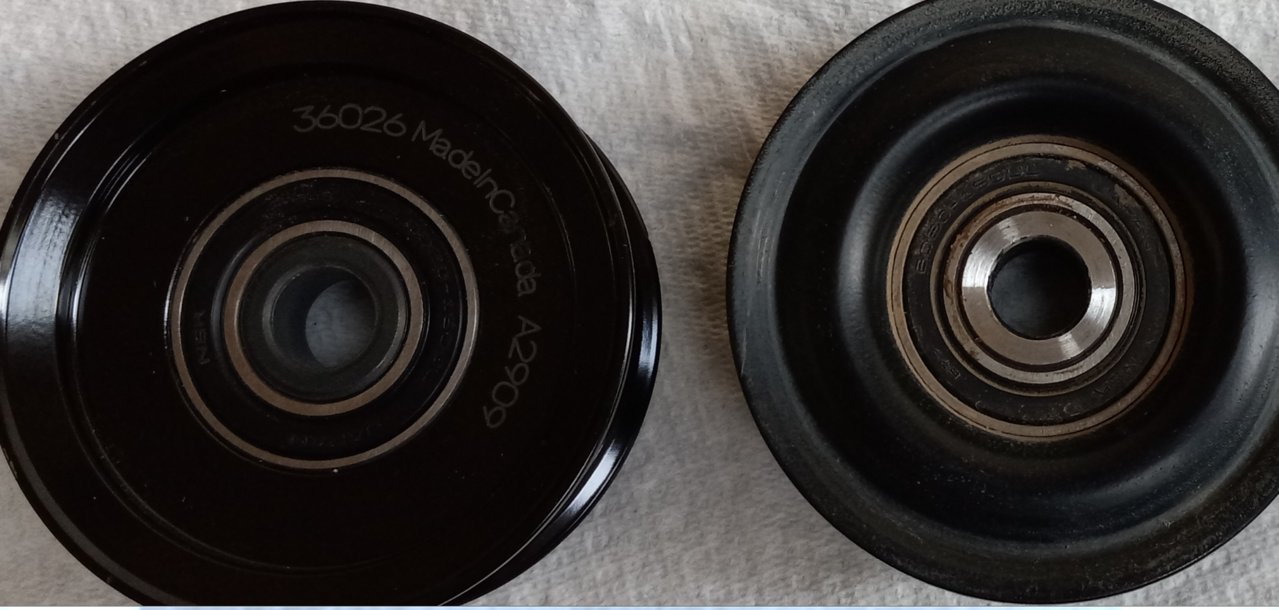

    Idler Pulley Differences
    The top center OEM Idler pulley likes to fill up with mud and start making noise. I found a Gates (made in Canada) that has a slightly different design that is flat on the surface area around the bearing.
    The center idler pulley is a one-year-old OEM. The one on the far right was on the 4.7L when I bought it. The new Gates is on the left. I think it cost around $69 - not cheap.
