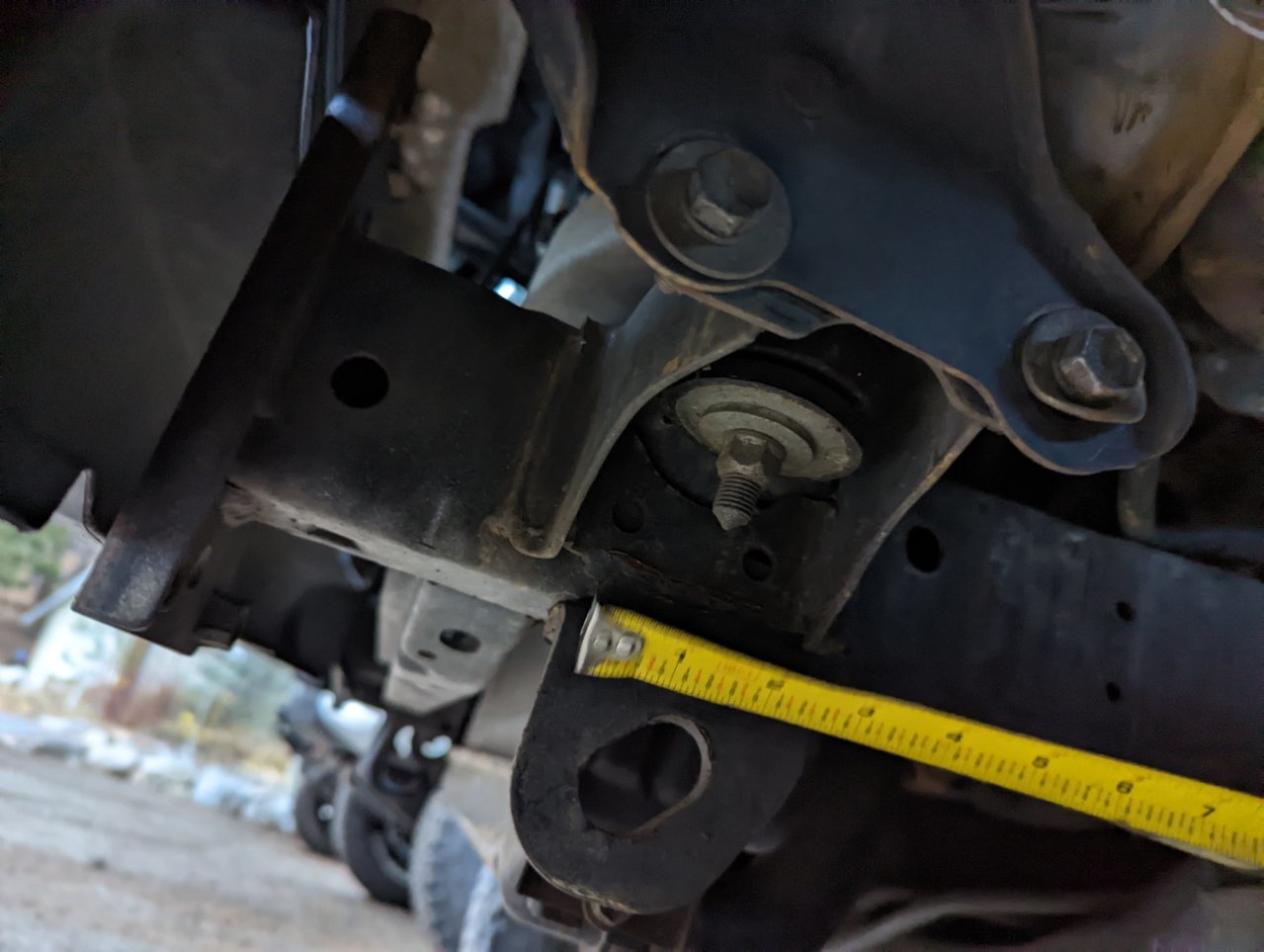

    So he said it's available; lots of interest but no commitment from anyone.
    He said he'd help me install it this Saturday; he did add that the previous owner of the 4Runner said the bumper was made for a 1st Gen Tacoma...I'm not familiar with the difference in the frame horns exactly. Is it that the 4R's are wider or something?
    Here's his 4R -
    I'm thinking it has to do with a tab or something that maybe needs cutting off. I can take my angle grinder and cut off discs with me.
    Better yet, if I have time I'll just remove my bumper tomorrow after class.

    Early 4Runners 96-98. Have the same style frame horns as 98-00 Tacomas.
    99-02 have the flat plates at the end.

    The frame horns are the same width, but the bolt locations are slightly different. When I put a '98 4Runner bumper on my '98 Tacoma, only two (out of four) of the mounting bolts lined up. Does the bumper you're looking at use the original mounts?

    I'm trying to remember... I think bumpers like that usually bolt in place of the crush cans and tow hooks. The original bumper mounts might not be used at all.

    The frame ends, whether they're the triangular pieces on early models, or the flat piece on later models, are removed for the use of this bumper.

    Ah right, that's the Trail Gear bumper? It uses the tow hook mount points. Looks like it might also use the bumper mounts, but the instructions aren't clear about that.
    https://trail-gear.ca/pub/media/trailGearInstructions/tacoma-front-bumper-instructions.pdf
    I was thinking of the All Pro Apex bumper, which also uses the frame ends. With that bumper, you weld in new frame ends after cutting them for 98-00 Tacomas. For 01-04, it bolts to the factory ends.
    Apex 98-00 install guide: Apex 01-04 install guide:

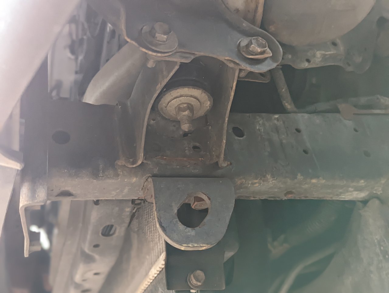

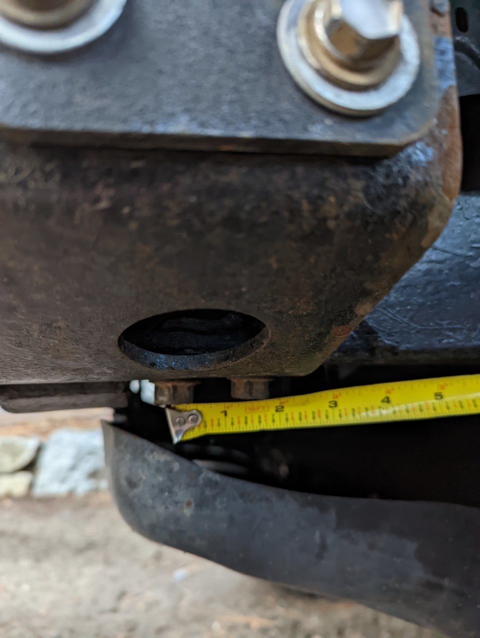

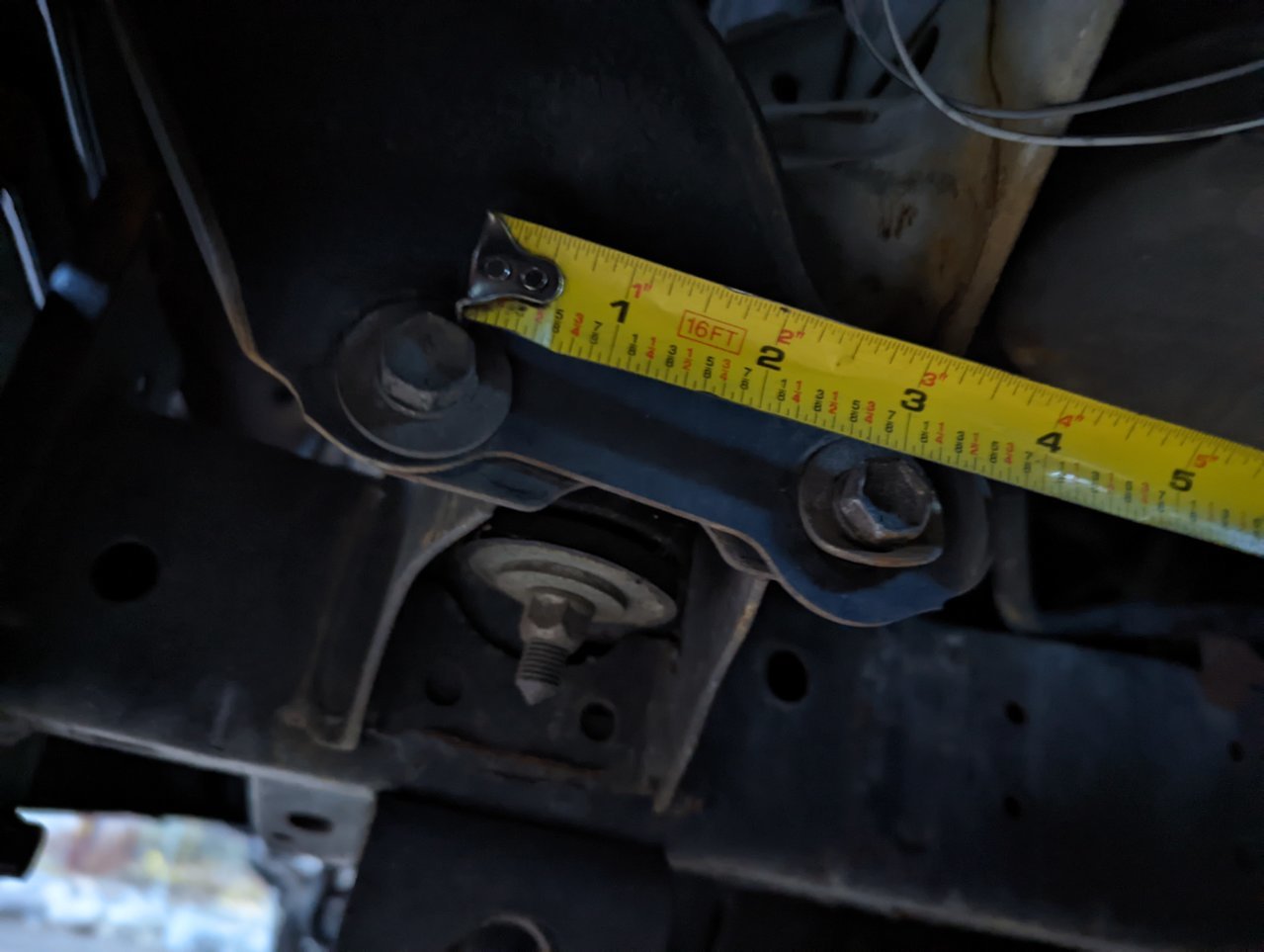

    Here you go. I took some quick photos this morning to compare.
    PXL_20211115_145501557.jpg PXL_20211115_145530798.jpg PXL_20211115_145547809.jpg PXL_20211115_145622770.jpg PXL_20211115_145633188.jpg PXL_20211115_145719439.PORTRAIT.jpg

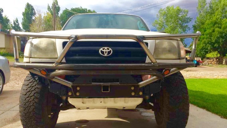

    I think I kinda like it better when the frame pokes through the mounting plate

    I welded on new frame caps with thicker bolts. When I get the time I will make some plates for the bumper and bolt it in there too.
