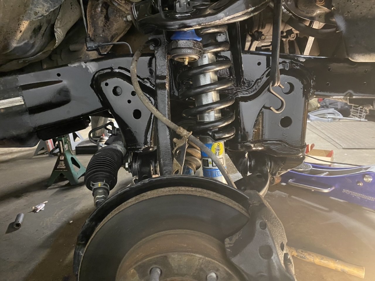

    How’s your day going?

    I believe you’re missing something

    It’s all there, but brake line need to go on the other side of the spindle…

    Oh shit
    I don’t see the spindle at all

    Haha I did that the last time I removed my UCAs to grease the bushings. Got it all back together, long UCA bolt through and torqued down and then realized the fucking brake line wasn't on the right side. Pulled it all off again and put it right

    I’m just gonna disconnect the brake line and move it, then bleed it. I don’t wanna take all that apart

    luckily with SPCs it's pretty easy to disconnect the ball joint and I never had much trouble getting the big bolt in/out. But yeah I considered doing it that way too but didn't want to mess with bleeding the brakes.
