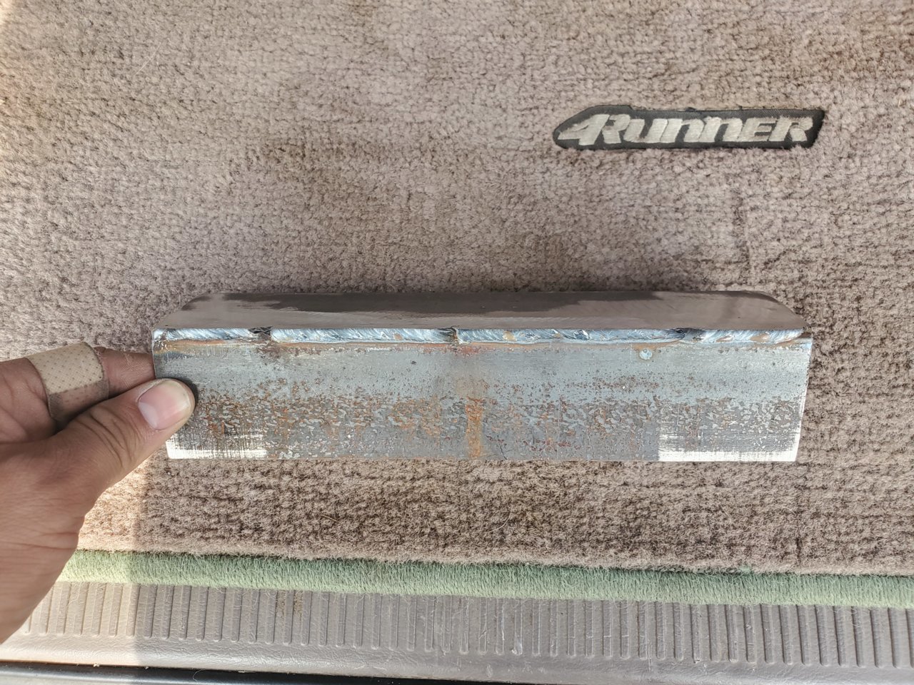

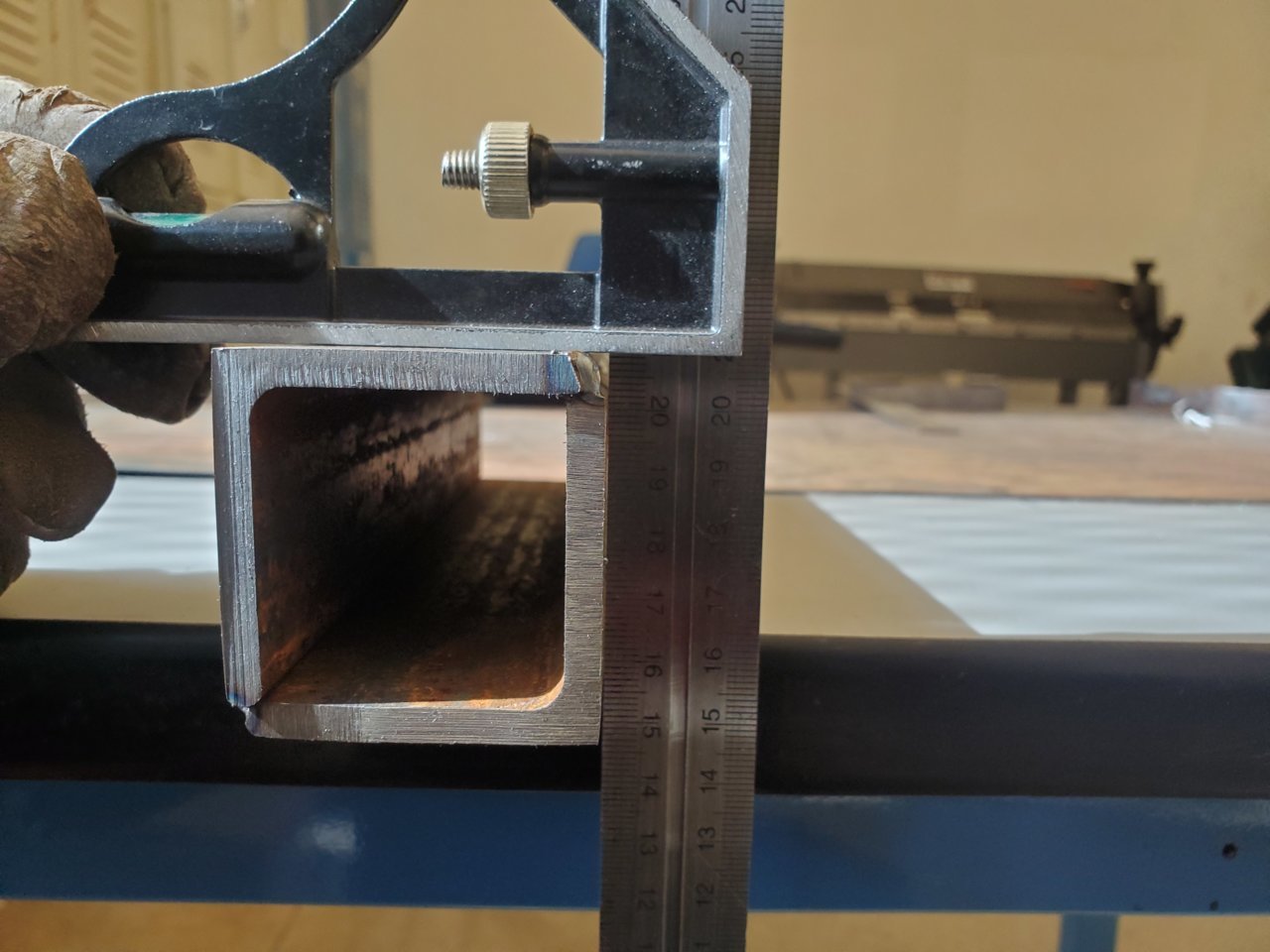

    I haven't been able to find square 2" square tubing locally without buying in bulk.
    Took 1 3/4" angle, 3/16" thick, welding an open corner for a 1 15/16" square tube.
    This will serve as the hitch insert for my FIL's hitch flag holder.
    Heat management is the real enemy here in keeping everything square; glad I was able to get it done right -
    There is some undercut as I laid 4 beads, alternating sides for said heat management -
    Really I should've created a landing before starting each new bead that's alright. Easy to grind and weld to fill in.
    1/16" of play is alright though because this doesn't need to hold anything but a light weight flag pole. The vehicle will be stationary.

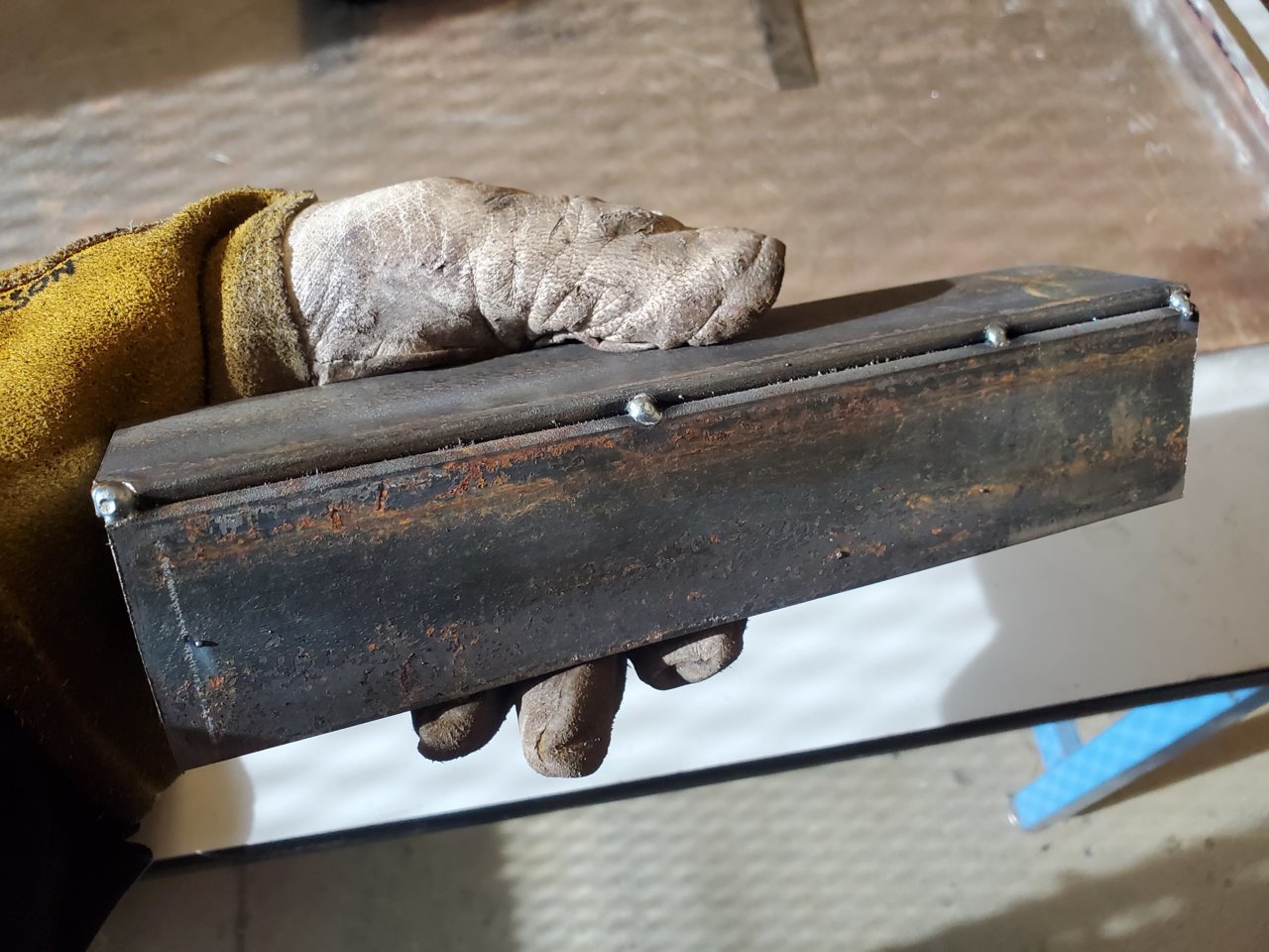

    And @Speedytech7 I forgot to mention, I did run 6013 before I posted that picture of my 6010.
    That's because I asked "what's the most difficult rod to run? 6010 is easy"
    The answer was 3/32" 6013.
    Holy shit I can't lay a stringer with that for shit. It never stuck, or had issue going out or anything but it's the equivalent of running cold with a fast wire speed. It just likes to lay out and freeze (hence freeze fill).
    When I stitched with the rod though, it easily laid out nice and flat on flat steel.

    I ran that 6013 pretty hot with an old Lincoln tombstone DC welder, i found 7018 the easiest to run, 6013 was toughest

    I should've tried that, then again I didn't stick with 6013 enough to try different heat settings.
    110-115 amp with 6010 on 3/8" was about perfect for me on the Miller.

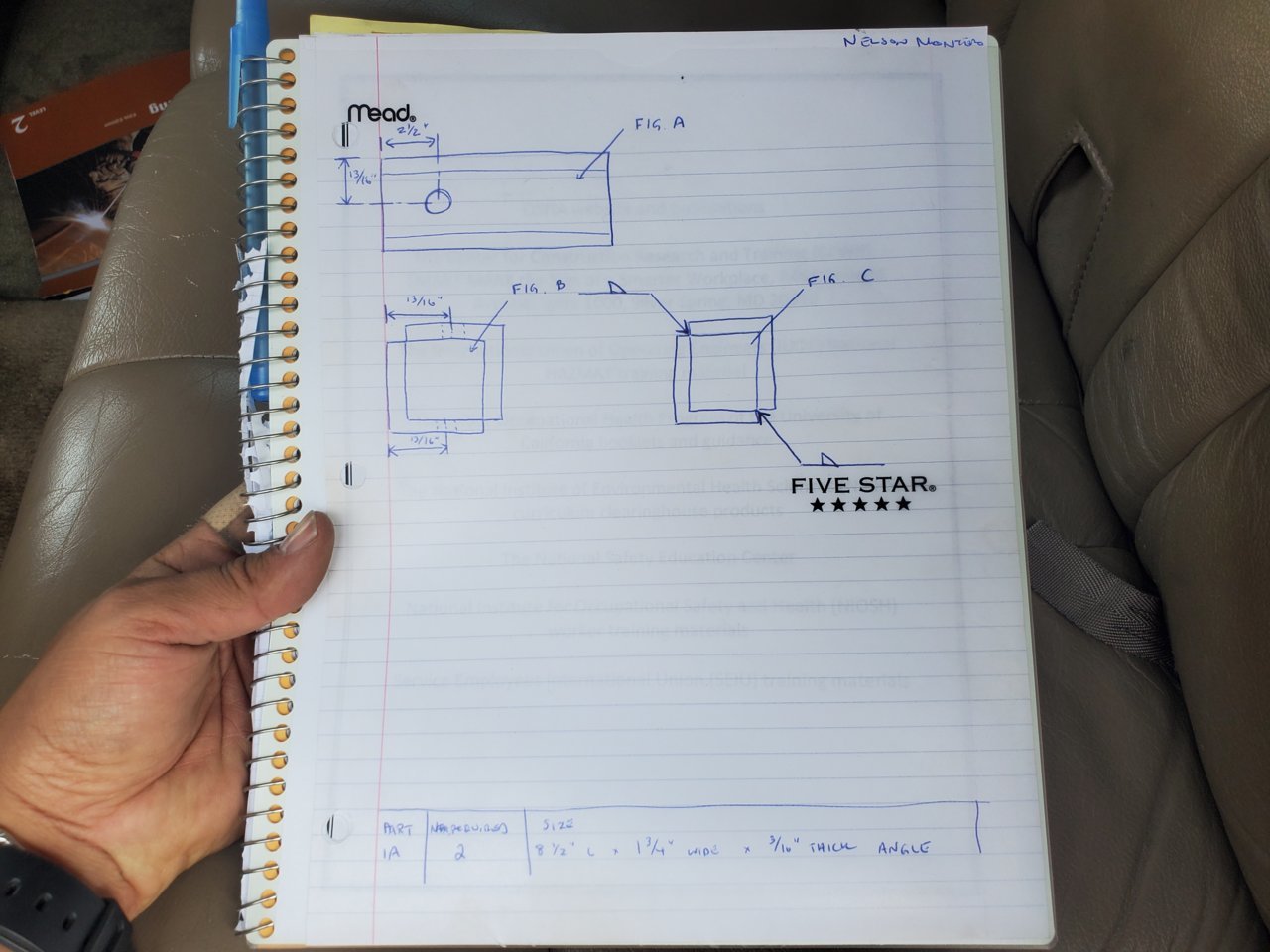

    To add, I was made to do a blueprint/diagram as we're allowed personal projects, but they will be graded as a real project.
    I promise my hand writing is better than this; was too lazy to take my cutting glove off :anonymous:

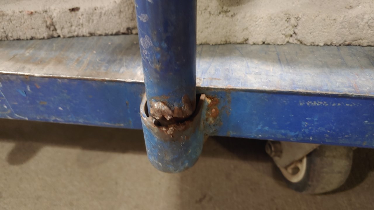

    Someone put a bad tack on that and said I'm out

    I had a bit of a stumble when I went to pull on the rail to move some cinderblocks and the whole thing came out lol
