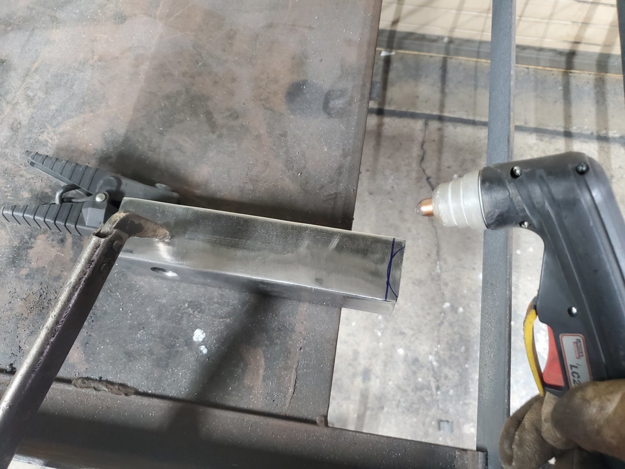

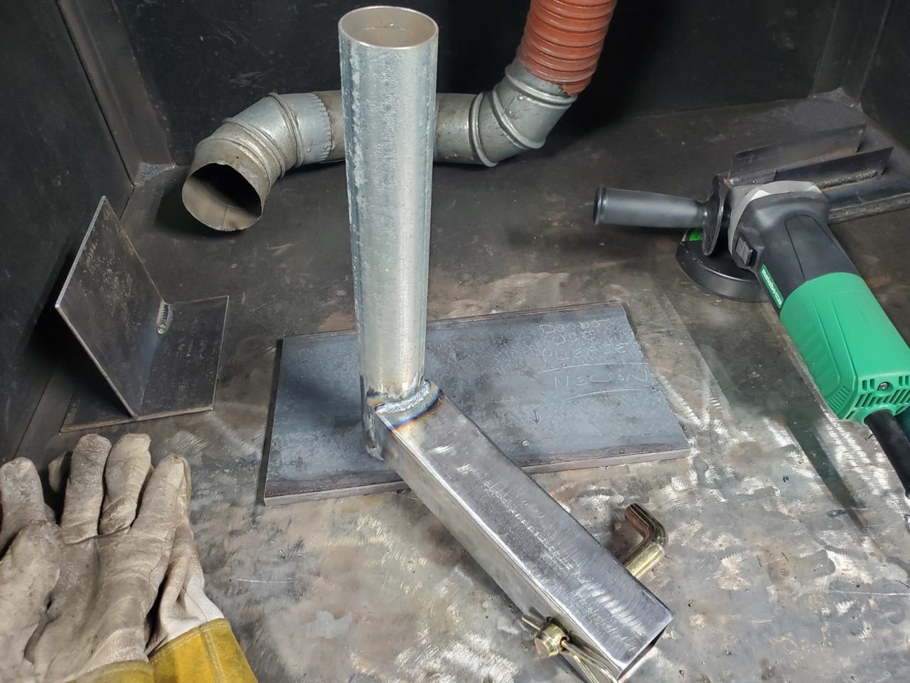

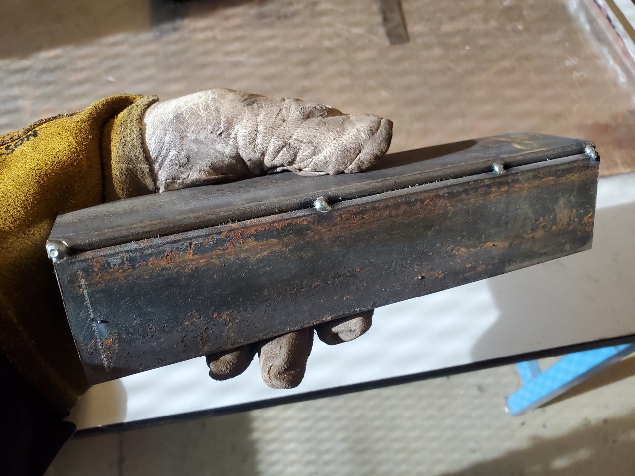

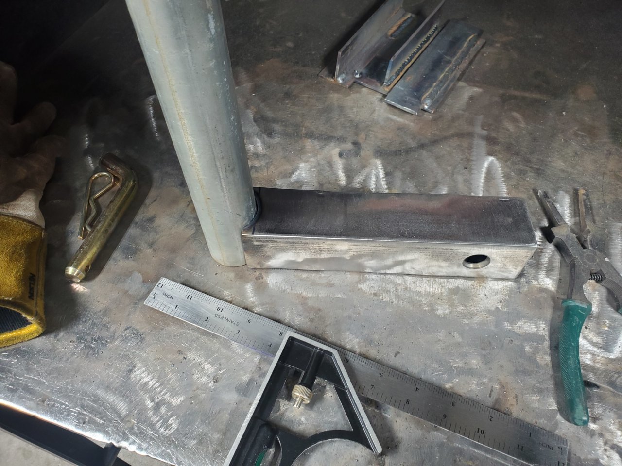

    Started with 2 pieces of 8" long angle steel, tacked then welded to make a square tube, 1 and 15/16" square.
    Ran a 7/8" hole, 1 and a 1/2" from the end.
    This will fit a Class III hitch.

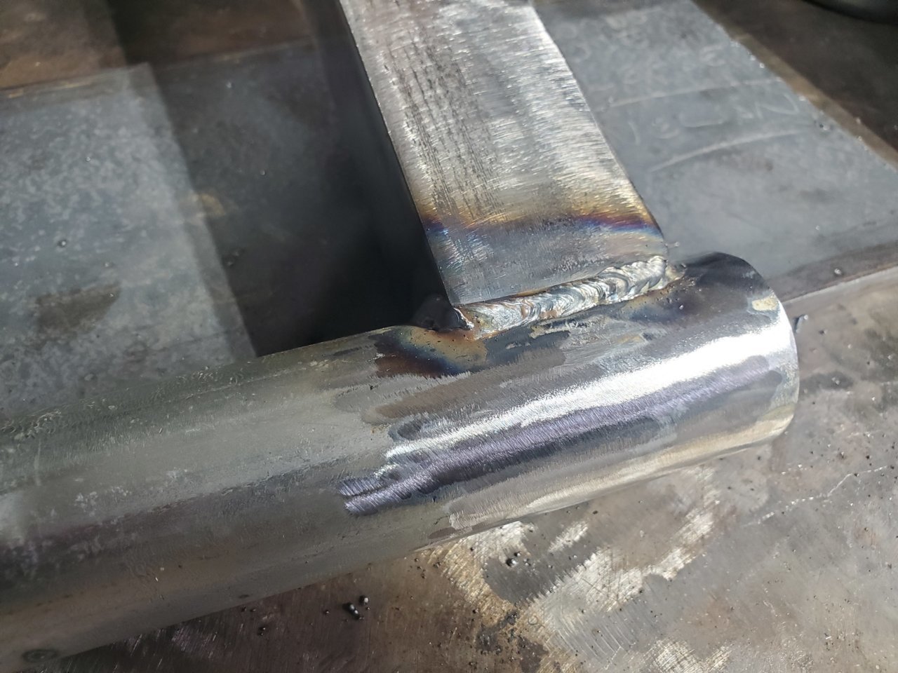

    Took 9/16" OD piece of round tube, 12" long to use as the flag pole holder.
    Notched the other end of the tube 3/8" from the end and welded the pole in place.
