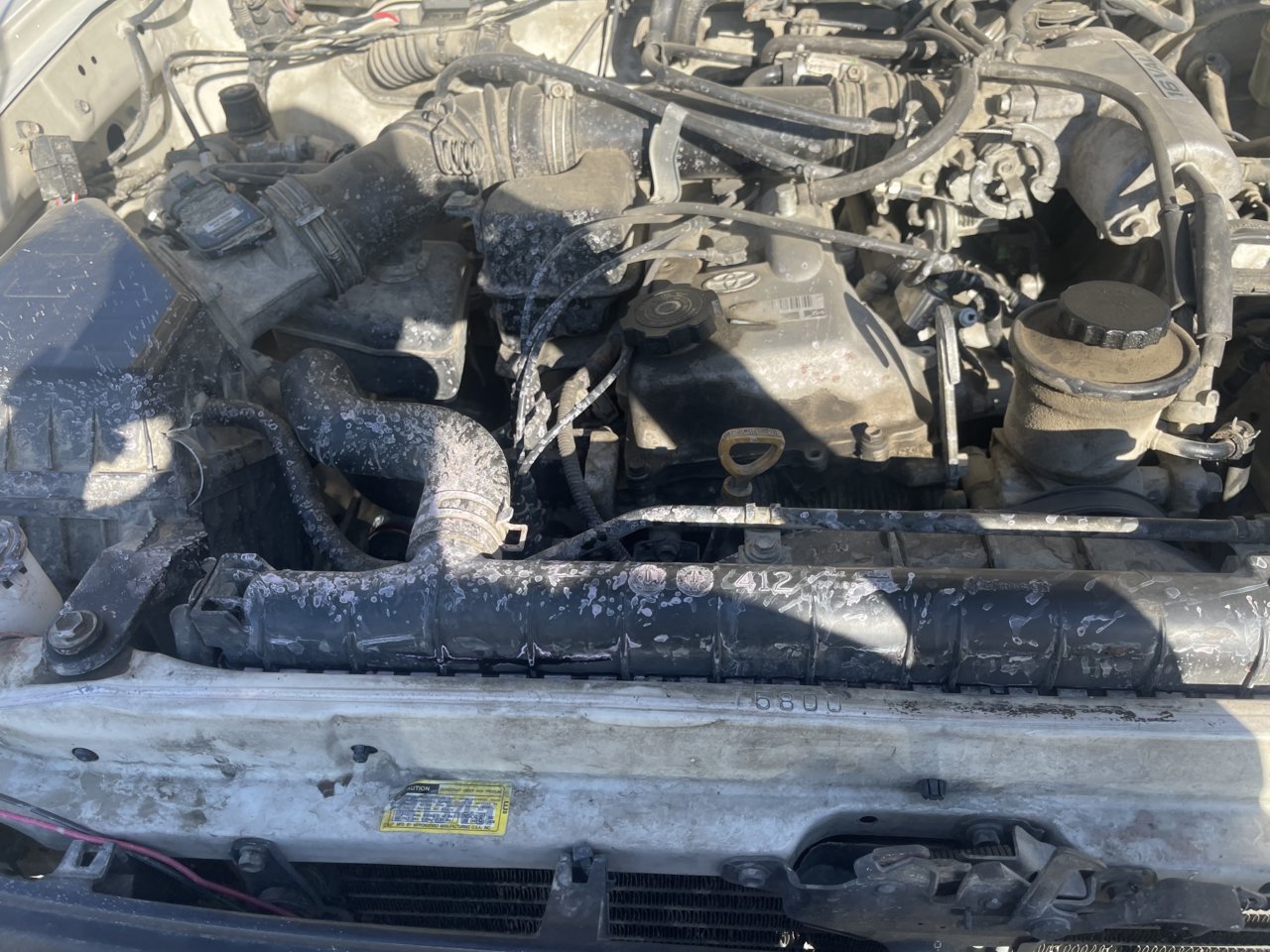

    fucking milkshake got me (cracked at the top of the seams, 30k miles) ….. time to call the dealer for anotha one

    Milkshake would normally refer to coolant+transmission fluid mixing due to an internal failure in the radiator.
    My engine bay looked like that when my 250k radiator finally split at the plastic end tank.

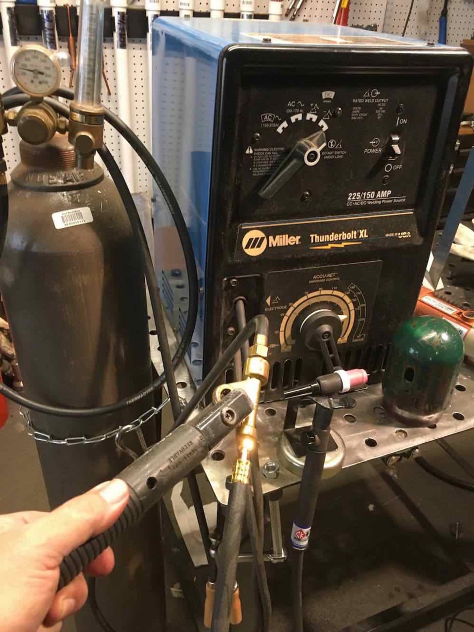

    Get yourself a cheapo DC inverter stick welder and rig it up for scratch tig so you can practice at home. I think I have maybe $600 in my setup not including the argon.

    Just get a stick welder so you can do tig (you'll want to do that more once you get good at it, its also much safer in a garage at home with no sparks flying around). If you need to do something quick just use the stick functionality.
    My Stickmate 160 runs on 120v or 230v. Its the size of a lunch box and can weld 3/8" plate no issues. Its also a Hobart so finding consumables is no problemo.

    Well they have gone up a little due to inflation I imagine, I paid $350 for mine a few years back from the same place. https://store.cyberweld.com/hobart-stickmate-160i-500570.html
    As far as setup, you setup the rod holder on electrode negative, clamp it to a power lug which is what you connect the torch to one side of and the gas hose to the other.

    Heres a pic of it courtesy of Jody at WT&T.

    The biggest thing missing from the titanium is pulse (DC square wave) and pedal. It's a scratch start, unlike expensive models, which means you scrape the electrode on the plate to ignite, then back it off. I find it can be easy to ball the electrode if you're not precise with it (it can stick pretty easily). If I were to do it again, I'd get an AC MIG and DC TIG - two machines
