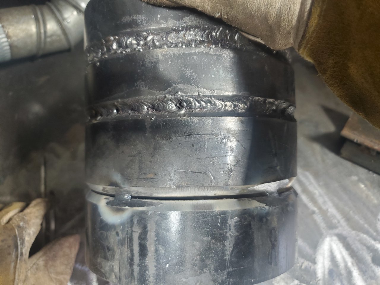

  16. Dec 1, 2021 at 8:48 AM
    Kwikvette
    Feb 27, 2019
    #284735
    82,032
    Fresno County
    4 run, 2 don't
    Nemesis :mad:
    Least my bevel and tack welds are legit.
    Will come back to run a root pass after break.
  17. Dec 1, 2021 at 8:50 AM
    Speedytech7
    Feb 20, 2014
    #123587
    58,271
    FCQM+VG Cheney, Washington
    It's less Tacoma and more mod
    Porosity, take this man to the dungeon
    0xDEADBEEF and Kwikvette[QUOTED] like this.
