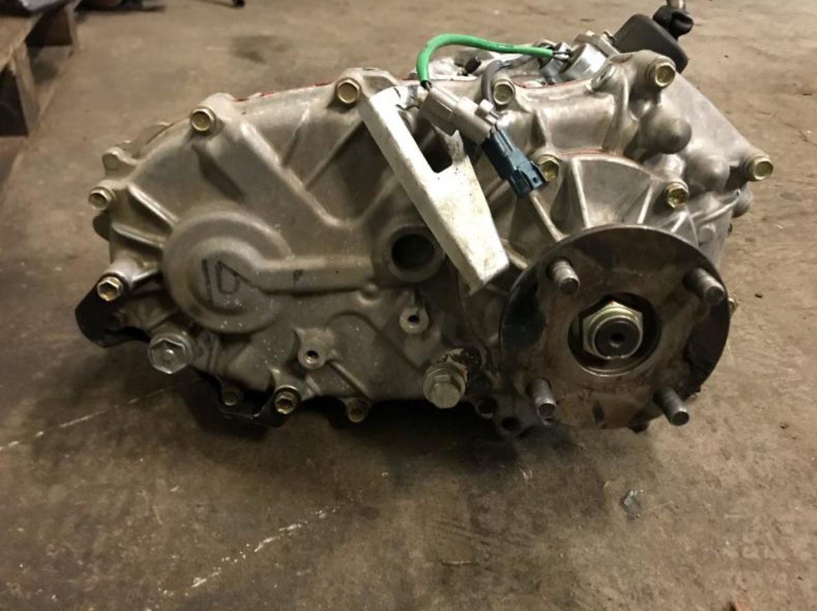

    In your experience, what's the best way to evaluate a t-case prior to purchase to ensure (as much as possible), success/smooth functioning?
    I found this one, which looks interesting: 2000 Toyota Tacoma Transfer Case Assembly-Stock# 1KE036 (car-part.com)
  17. Dec 12, 2021 at 9:23 PM

    fluid condition is a good tell tale sign of things inside. and if it goes into the gears. past that not much you can check without installing it and driving it, or completely tearing it down

    The one I posted, appears - to me - to be missing the fill plug entirely, which I assume means no oil in it at all. If that's the case, stay away?

    That one honestly looks really nice. If it were low miles of course. The fatal mistake I made on the transfer case donor I grabbed two years ago was just checking to see if it shifted and the output flanges spun. I didn't look at the input shaft at all which was fully seized. And like @Empty_Lord said the fluid inside.

    they drain them at the yard. but the theyre never empty empty. it appears to have a plug insalled. albeit its not a stock one. that massive hole isnt really a hole, just the casting where push button t cases would have an actuator
