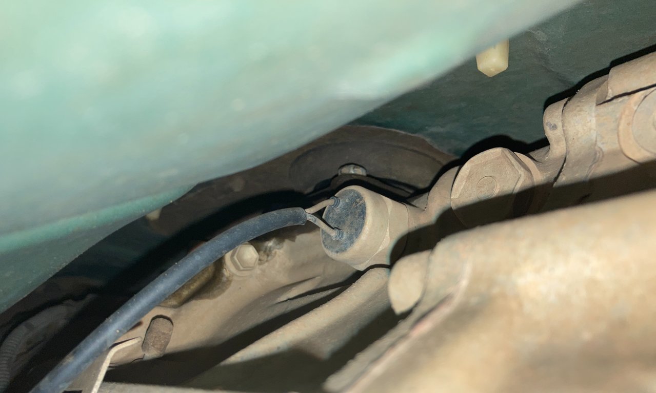

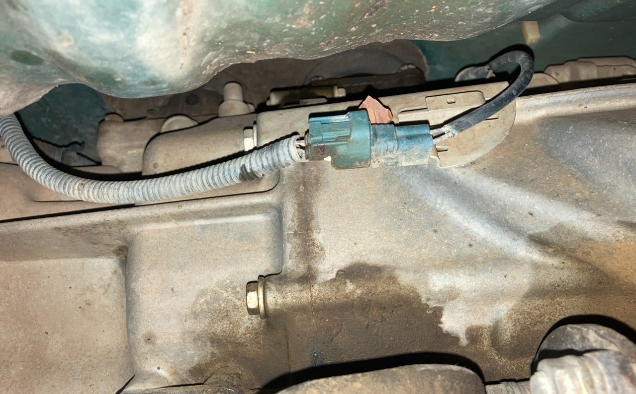

    So, interesting plot twist here.
    In a move that can only indicate my ... stupidity, I suppose ... I finally crawled under my truck this morning to verify the various sensors before I ordered the one missing (84222-35090) from this t-case that I picked up yesterday. Partly I just wanted to verify its existence before I bought a new one, and I was also curious about the green-ness.
    And now I'm confused. Here's what my t-case looks like; as you can see, I have only the forward sensor on the driver side. Yet, it's certainly an ADD, w/rear diff lock, w/ABS truck. Thoughts and ideas? What does each of the three sensors do?
    • fwd driver side (84222-35080): function?
    • rear driver side (84222-35090) green switch: function?

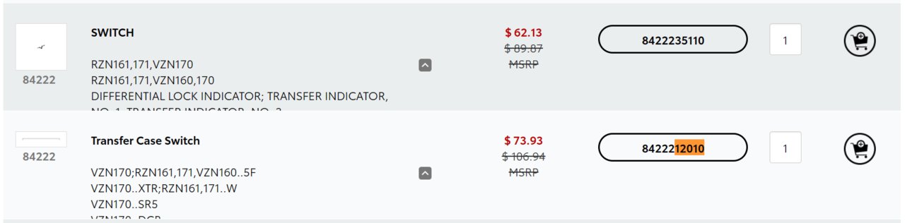

    • passenger side ($62 - 84222-35110) or ($73 - 84222-12010)*: function?
    * is there a difference in these (passenger side) switches besides price? Both are labelled as "84222" in this diagram

    • fwd driver side (84222-35080): 4WD
    • rear driver side (84222-35090) green switch: Neutral
    • passenger side ($62 - 84222-35110) or ($73 - 84222-12010)*: 4LO (I could have this and the 4WD switches mixed up but that's what they are for)
    04Pre_Runner likes this.
