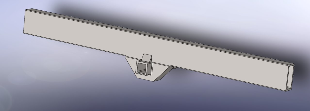

  8. Dec 20, 2021 at 7:18 PM
    Speedytech7
    Feb 20, 2014
    #123587
    58,271
    FCQM+VG Cheney, Washington
    It's less Tacoma and more mod
    @Kwikvette
    Something like this brace under your bumper and then the diagonal braces you drew earlier...
    The big bar is your bumper (not to scale)
    Kwikvette and Wulf like this.

    Braces the entire receiver. I may have to cut something like that at school but it'll be simple.
    5 pieces; 1 front and 1 rear, then 3 small plates to enclose the brace and make it "boxed"

    Or you can use a piece of box tubing and cut a 2" square out of the top and mitre the edges

    The wedge from the top of the hitch tube to the bumper body is a good strong option you can do on one side or both if you got the clearance
    Kwikvette likes this.

    2" probably too small since the hitch tube is 2", I modeled it with 3x2 rec tube

    @Speedytech7 that's a legit ass brace, something I think I've seen on custom flat beds but never considered until now that you posted it.
    Thanks :fistbump:
