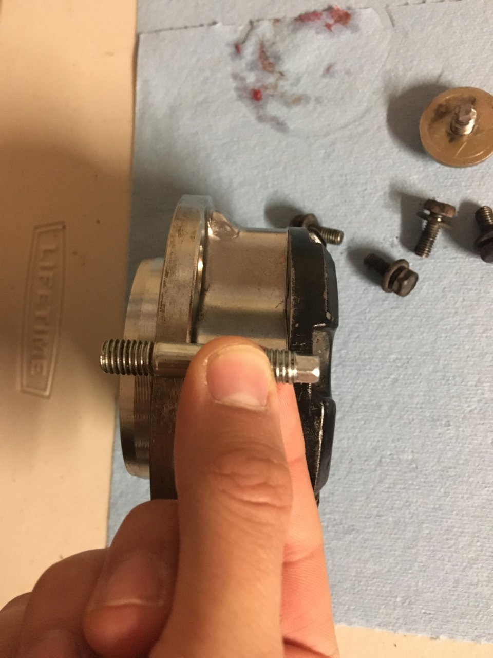

    Do you need OEM from Marlin? I picked up a bunch of hub studs, cone washers, and flat washers from a Yota parts place on eBay last time I was in a pinch and I think I had them in 2~ days. They were aftermarket but I haven't ripped the hub off with 35s and the ARB so there's that

    So it seems the hub studs listed on eBay couldn’t get here until the 15th of January or later. At this point I might as well order them there. OEM is finally discontinued with the rise of popularity with 4WD/manual hub swaps.

    It's less Tacoma and more mod
    Do land cruiser studs fit, they're still an open part in multiple countries

    I think the solid axle ones are way longer. I have a set from a solid axle truck and they won’t fit.

    What about ones from pre tacos and runners with manual hubs

    Interesting, I thought I have ordered and used LC ones but maybe I got lucky. Are you sure they are hub studs and not third member studs?
    Even the third studs should be able to work if the short side is short enough tho, all 8mm studs

    Looking up the third member studs and IFS hub studs. As far as I know these are solid axle studs. Got them from Trail Gear.

    Oh yeah those prob won't work if they're not threaded all the way like factory
    The third studs are the same as the hub studs, 8mm and same length as the hub studs on one side and threaded all the way to the middle ring just longer on the other account for the added thickness of the third member housing. If you like I can dig through my shop later and find my box of spares to check

    Those aren't for mounting the hubs that's for sure, I have nothing like those. I have ones like them for mounting the kingpins

    Oh fuck, yes depending on the dia those might be for the steering arms. Especially with a wide shoulder between the threaded portions
    TG does make a hub stud kit tho.
