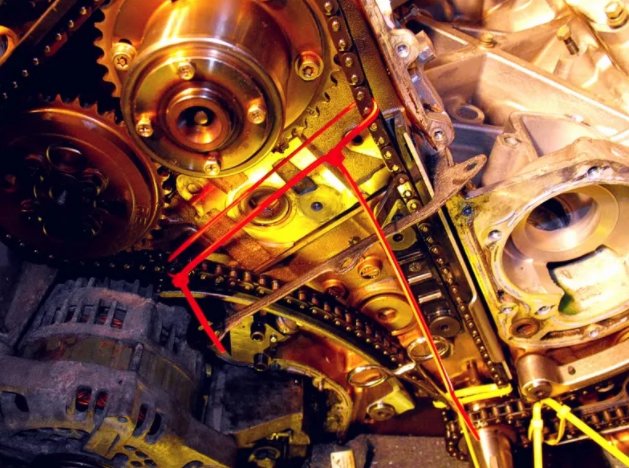

    It was very loose when I found it, yes. I changed this timing belt 4 years ago and never took this cam gear off to do it, and service history doesn't show it ever getting a valve cover gasket (gear must be removed to take off the valve cover) so I think it finally loosened from the factory torque. He had a collapsed VVT actuator and it was causing an almost impact gun like movement of the cam as spring pressure and the internal chain slammed it back and forth, that might've done it too. Either way I used some loctite and torqued the new gear to spec on the new cam haha. It was $35 for a gear, cam, and actuator from a fresh wreck in the junkyard.

    That's not too bad, price wise at least. Sounds like it was a pretty straight forward fix, although a PITA to have to do for that reason.

    Yeah, it was not bad at all. I cheated and used zipties to hold tension on the belt to the lower timing sprocket since I didn't wanna take more apart than I had to. From there it was all under the valve cover, both cams, the internal chain (drives the intake cam from the vvt actuator on the back of the exhaust cam which is the only cam driven directly by the belt) all came out. Then it was just tough to find info on how to phase the cams during reassembly, this is not an enthusiast engine... there is no community dedicated to enjoying it... even the factory information on AllData was pretty bare bones. All said and done probably had 5hrs into it and that includes running back to the junkyard haha.

    I've done stuff like that with zip ties when I didn't want the chain or sprockets to jump timing while I was changing guides.

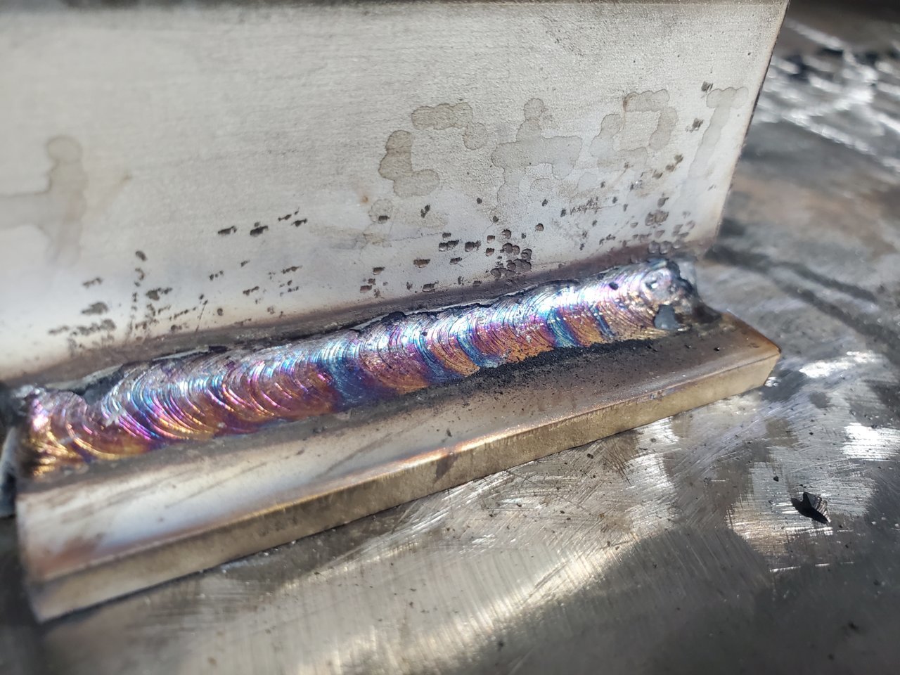

    ArE yOu A wElDeR oR a GaMeR
    Those RGB welds; doing stick welding on stainless steel.

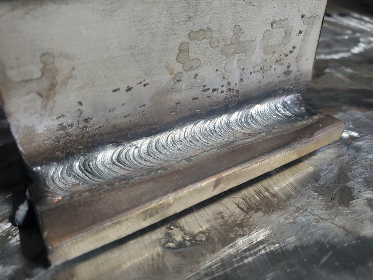

    The result once wire wheeled
