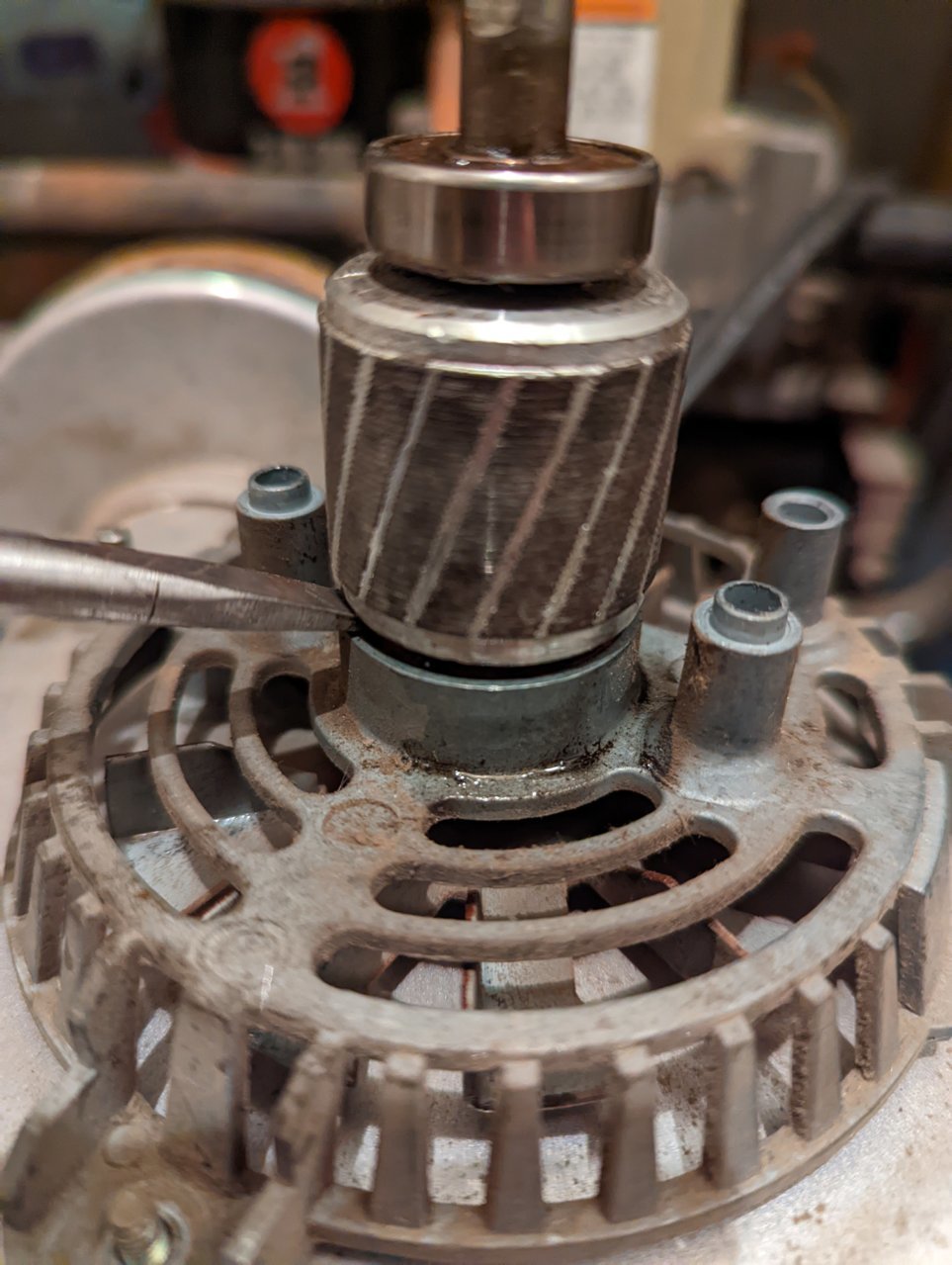

    do you know what it needs?

  8. Jan 10, 2022 at 10:25 AM

    Mine started making a noise on and off for a few days. Guess it was the bearing running out of grease. If you have a warranty have them replace the complete blower motor or you may be calling them in a month.

    It needs a new exhaust fan. The bearing that froze up is the one between the motor and the casing where the screwdriver is

    haha no warranty it's a 20~ year old furnace. Gonna replace the complete motor. I know it was done at least once in the last 10 years but I don't know if it was a good motor with bearings or cheap one with bushings lol

    oilite bronze bushings are good for motors like this usually they live longer than non sealed bearings
