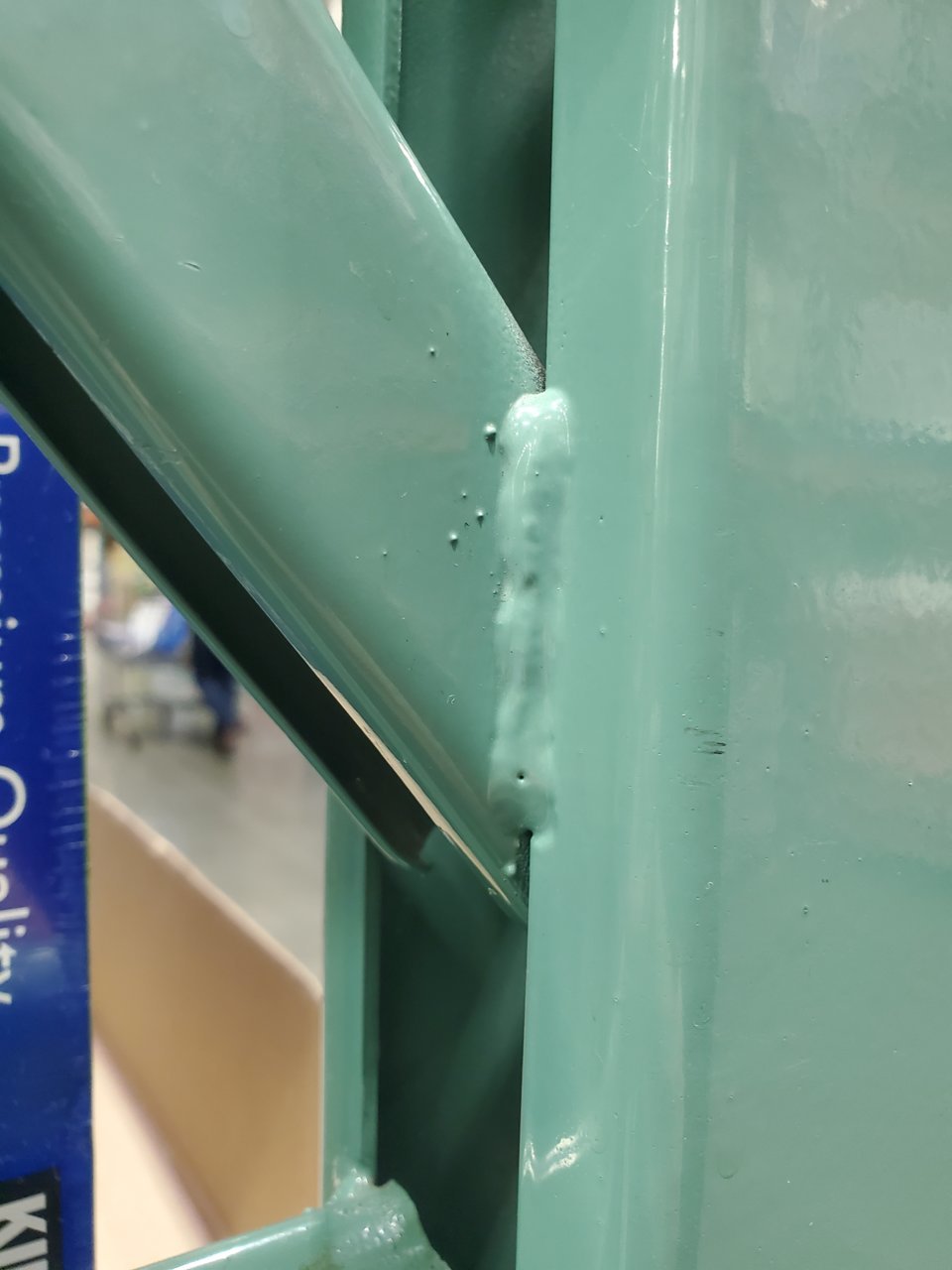

    @treyus30
    Damn welders
    This is a shelf at Costco. Freaking porosity and spatter. Didn't even fully tie it in either.

    There's a 100% chance that was laid by a machine. Have you seen the machine welds on Toyota frames that came out of the Dana factory?

    No sir
    Hate to say that I assumed robotic welding would've produced consistently good looking results.

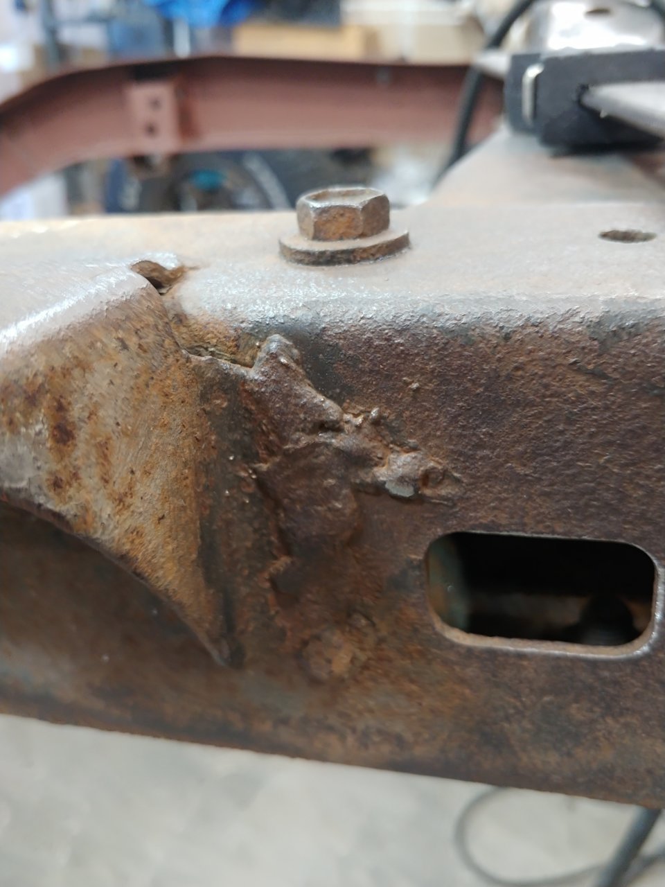

    I'm going to go take a picture of my truck that'll horrify you. And yes machine welds can be absolutely perfect. Takes time to dial em in and your materials have to be pretty consistent too since the machine can't really adjust itself. So what that weld is that you were just looking at is it certifiably good enough weld lol

    Its still holding stuff up though isnt it? And yes, nobody is getting paid to weld racks together for retail. Thats all robotic. Probably does a million of those a day. Some "issues" are to be expected. That one spot of porosity is likely from pulling the gun away too quick at the end of the weld.

    "Good enough"
    Common trend in this thread :laughing:
    Yeah that weld was bad but really, it doesn't need to hold a ton of weight so it makes sense.
    The undercut at the bottom was really bugging me though.

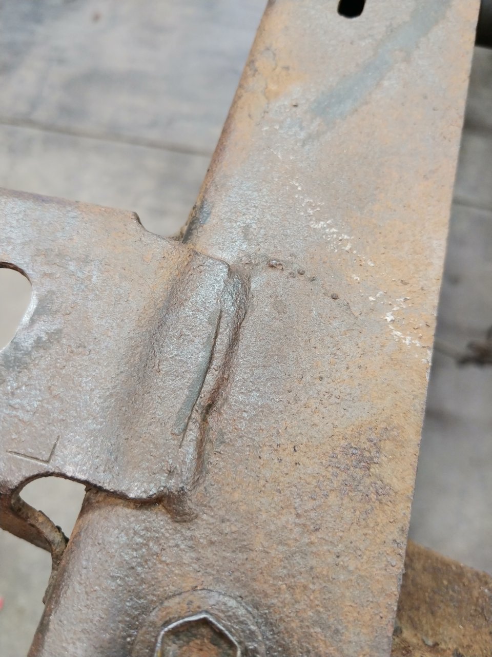

    Tell me your truck was built on a Friday...
    Those are factory, and yes they're good enough, in fact they're probably better than they need to be. But it is still a poor show.

    Damn :rofl:
    But yeah, automotive industry uses robotic welding more than any other. Crazy to see those welds...I don't want to look under my 4R.
