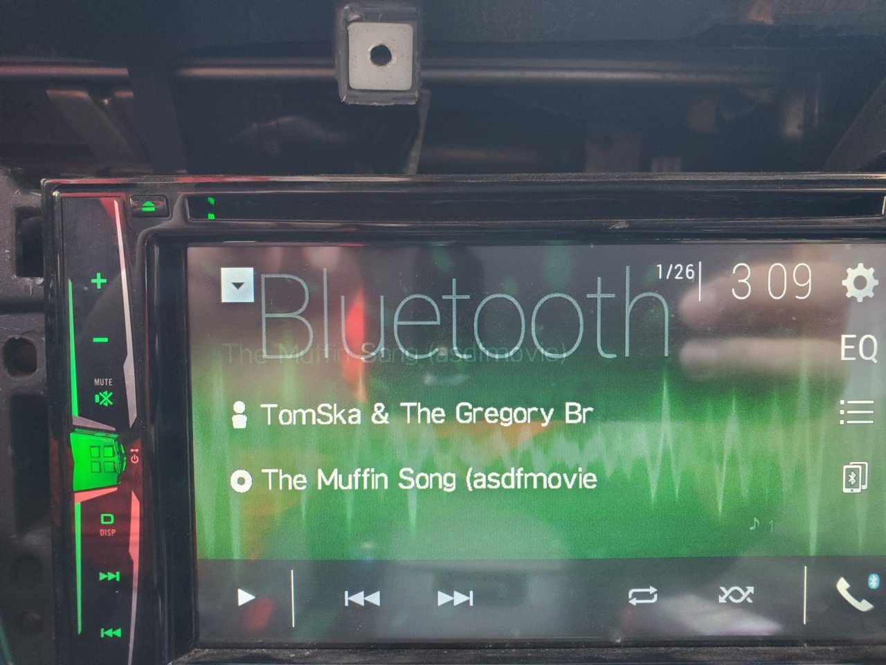

    How's the Muffin song sound on that MFR

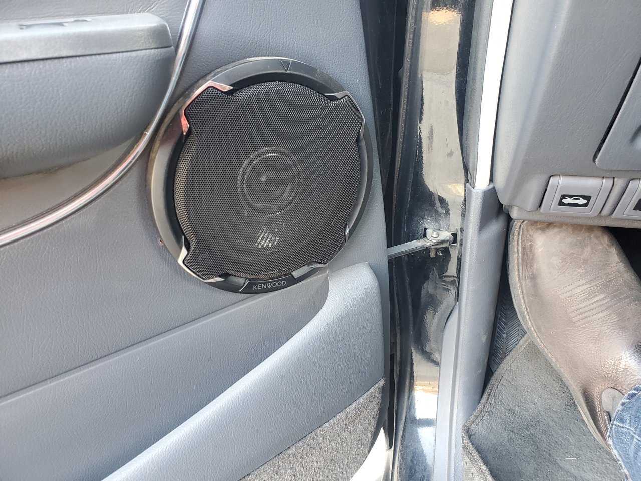

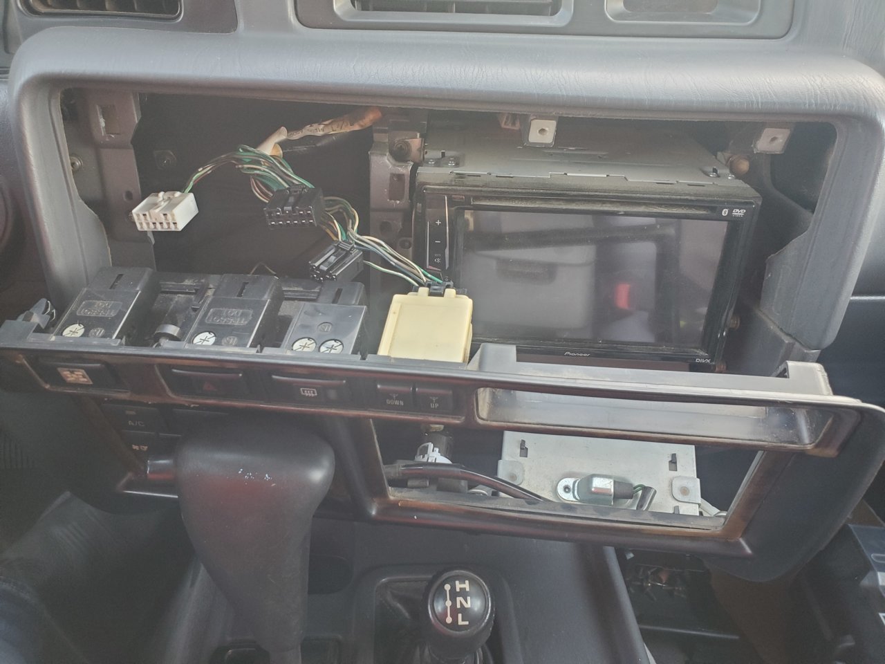

    What's nice is that the climate control/center panel is still available new, so I'll be ordering one soon.
    Only after I've taken this apart and fixed the wiring.
    So far, fading RIGHT gives me rear sound. Fading FRONT or REAR does not change things.
    Fading LEFT gives me right front sound.
    These speakers are wired fucked up.
    Also, I must have a subwoofer in the back somewhere as one was disabled in the stereo option. It wasn't until I grounded the E brake cable now that I was able to pair my phone. It was left unattached to anything.

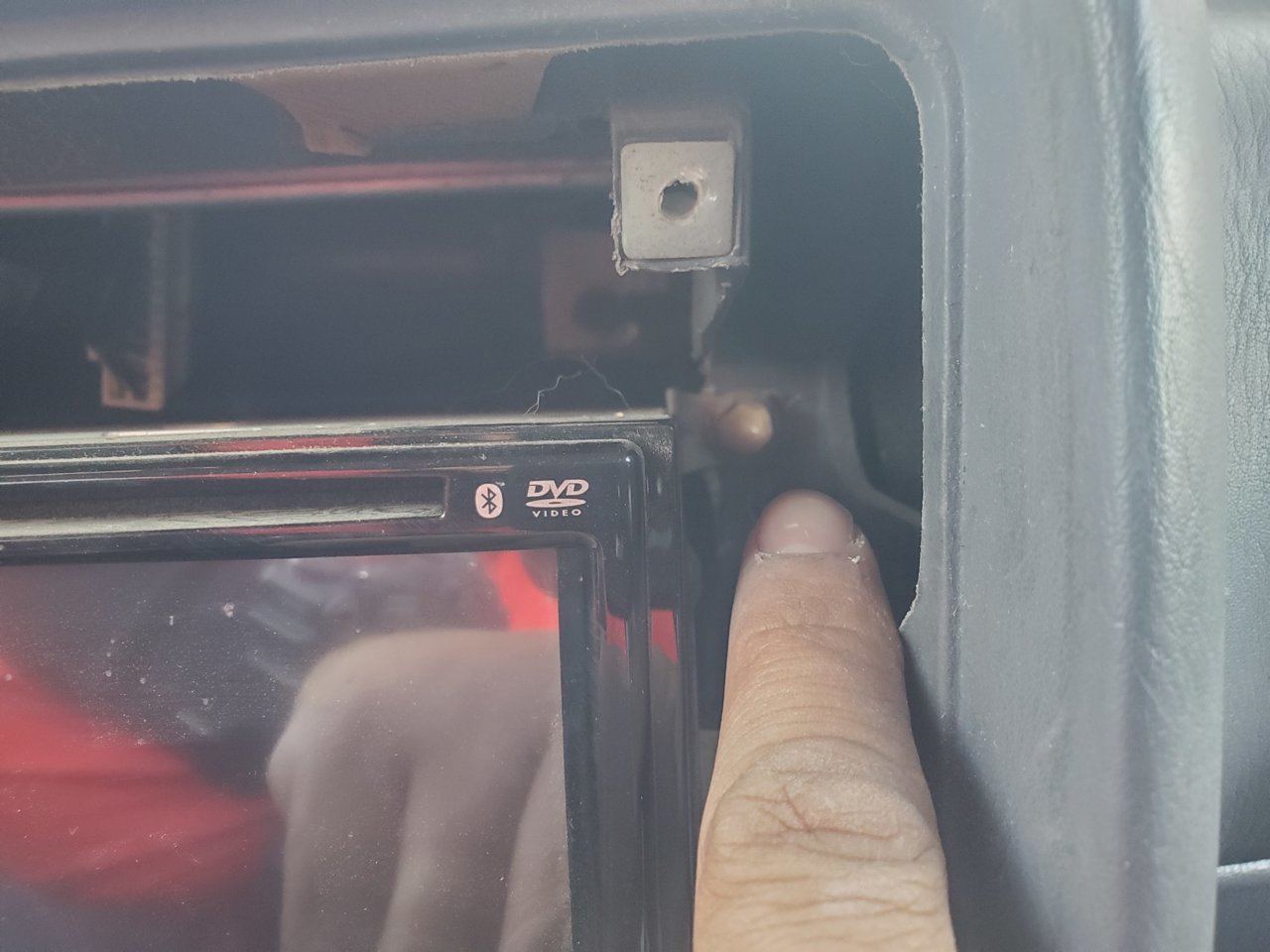

    That and I've got a damn bolt to remove
    Must've lost the factory screws.

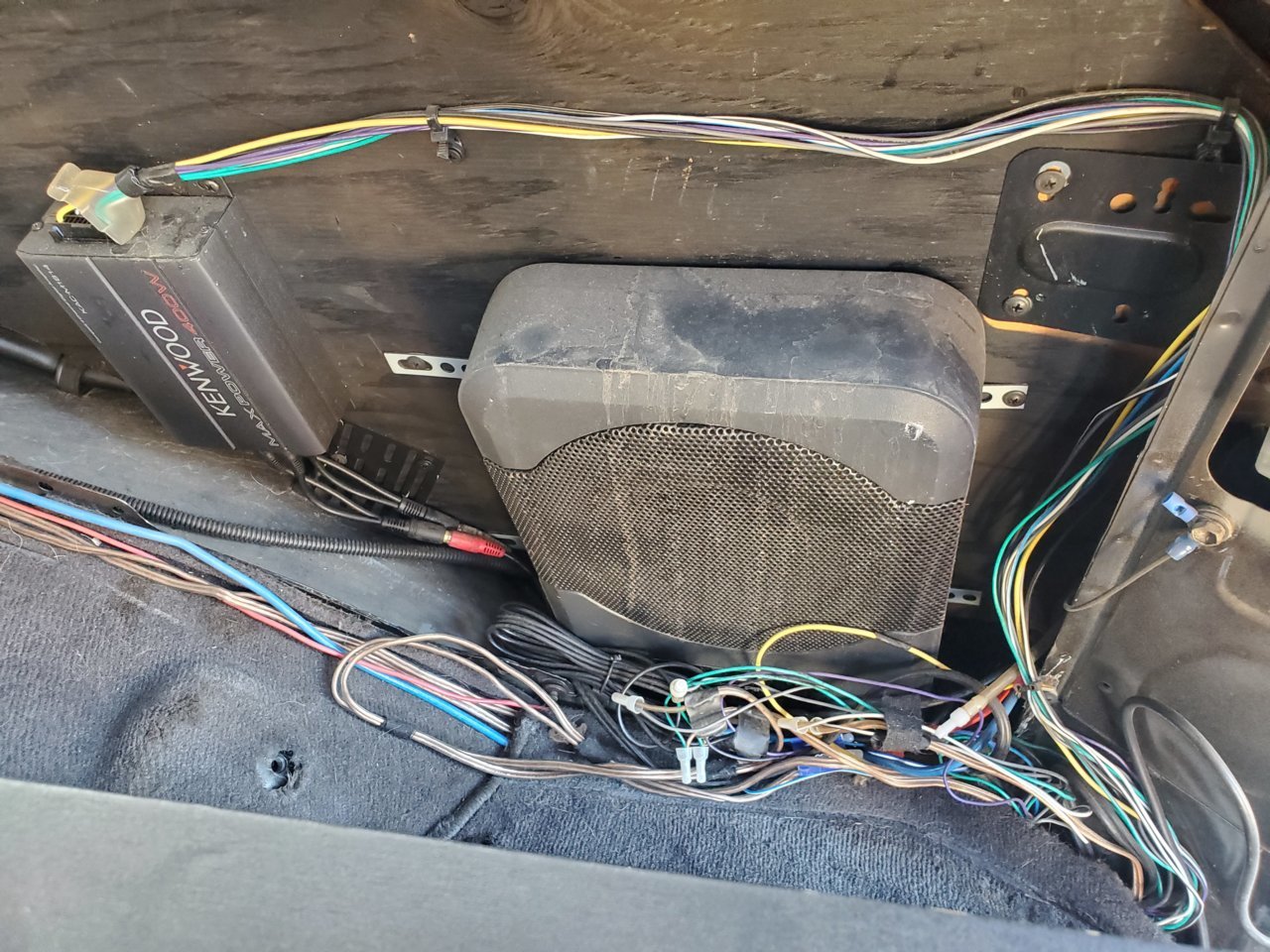

    Fuck me
    Aftermarket stereo harness in my left hand, and the two factory harneses to the right.
    They just spliced into them for power/ground/illumination it seems and that's only because I recognize the cables on the Pioneer harness end.
    There are two sets of RCA cables; one for the subwoofer (which I disconnected from the sub output) and the second I assume is for the factory amp? Thinking somewhere along the lines they tapped into the factory wiring and ran RCA plugs or used some kind of line converter.
