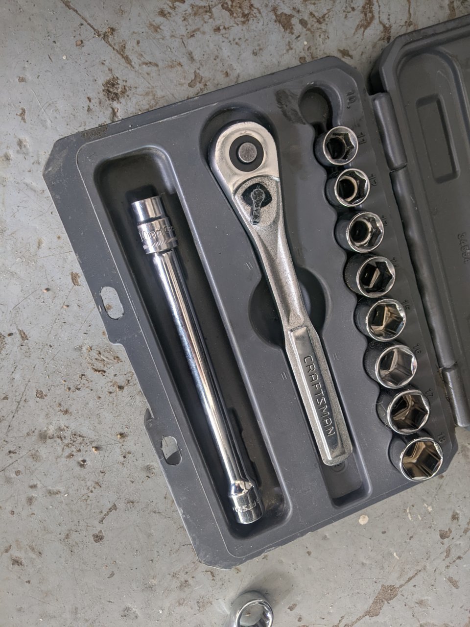

    I'm pretty sure there's a ratchet just like that one inside the cab beneath the drivers side rear window of an 01 extra cab I sold in 2015ish

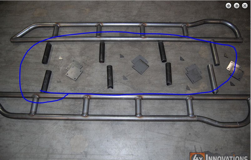

    4x look good, just surprised they do straight connections and not triangles

    Huh?

    You could always gusset the tube to the plate but i think it's overkill on a Toyota. They don't weigh enough

    You'll rip the entire side of the frame off before you bend those tubes, sliders that flex a bit are a huge advantage, if they were perfectly rigid you'd do a lot more damage to the frame.

    Ya. Doubt I'd ever break them but it's an easy thing to add if a weld ever cracks

    Gotcha
