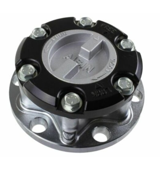

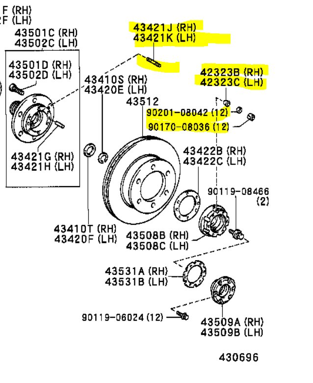

    Can any of you manual hub peeps lend a hand? Trying to figure out exactly what else I need for the lockouts. New AISIN FHT019 lockouts did not come with the hardware to secure to the hub.
    This sound right?
    cone washers (x12 42323-60010)
    plate washers (x12 90201-08042)
    hex nuts (x12 90170-08036)
    As for the studs, they are coming up as discontinued and it doesn't appear they are included with the hub - see second image.

    You’re killing me inside lol. Tacoma studs are out of stock worldwide. Pickup studs technically work but are slightly different in length.
    There is evidence/claims on the T4R forum that people that wheel hard deal with stud failure using the wrong type of studs but who knows. I have something wrong with me and I’m trying to find someone to replicate some Tacoma studs.

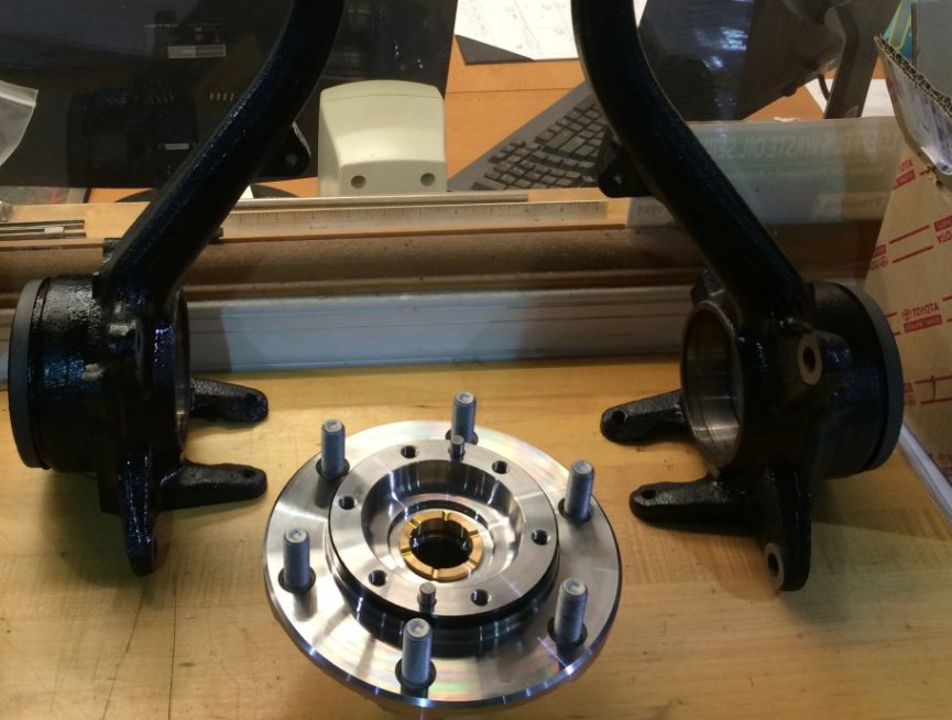

    time to buy a tabletop lathe to turn the pickup studs into tacoma studs :eek:

    It's less Tacoma and more mod
    I've got one, but I'd probably just buy grade 10.9 automotive studs at ace in the length I need.

    Your axle hubs, that get pressed into the spindle along with the wheel bearing, those need studs that the hub assemblies sit in.
    After you lay the hub assembly down onto the axle hub, cone washers go in each one over the hub body. Followed by a washer and nut and torqued to spec (torque values found online).
