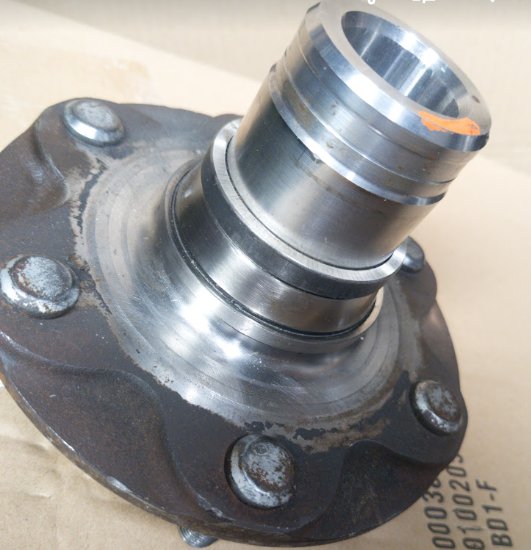

    Nothing, when I pressed out the ADD hub of course the bearing was shot and part of it is stuck on the hub. All good, I don't need them since I'm going with manual hubs.

    AH i thought you had a set of ADD hubs
    its easy to get those races off the bearing. all you need is something to put the hub on with a vise so it can easily spin and heat the race with a torch. it'll literally fall off
    dont get rid of the hubs.. i can make use of those.
