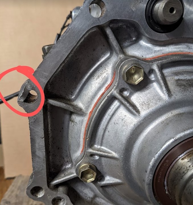

    You need to match that hole on the transmission to see if it's threaded there. All the bolts will thread into the trans tail housing. If it is, I don't know how well I would trust that hole. You don't want to skip any bolts going into the trans to hold that tcase in place.
    If there is a dowel pin in that location on the trans, then you might be all right. Just need to use a drift of some kind to try and get that hole round again and file the mating surface smooth.

    Oof, that looks important.. no threads, maybe a dowel hole?
    If it were mine, and was a pain in the ass to get .. and no way to complain to those who sent it... I'd heat it up gingerly (might be a magnesium alloy, dont wanna melt it) with an oxy/acetylene torch and then massage an appropriate sized punch through that hole, from the front face to the back. Then, on the mating surface, sand any possible deformity left over and permatex the shit outta it

    Wont be able to really confirm until I have a trans on hand to mate it up and see. Going to reach out to the seller and see what their response is, wasn't any mention of it in the listing. On the other hand, don't believe there was a mention of insured shipping either.
    It really comes down to rolling the dice on these salvage parts I guess, especially the ones ordered online. :facepalm:Lesson learned and hopefully it doesn't turn out to be a costly one.
    EDIT:
    Just looked at the original listing photos and its barely noticable in the image (right side).
    xtremewlr[QUOTED] likes this.

    That's freekin lame, I see it in the photo :(
    Heat and brass drift pin will be your best friend in this scenario, God's speed good sir

    So it's not a dowel hole. I've linked an image from @turbodb tcase swap writeup that show the alignment pins/dowels and the bolt holes. It's just one of the 4 bolts that slide in from the rear of the tcase and thread into the transmission adapter. The bottom four insert from the front of the case and thread into the tcase.
    I'd definitely make sure the rear flange that has the backed out stud didn't take any major damage from a hard hit. As for the noise from the front output. It could be a bent dust shield that press fits onto the output flange. They can sometimes contact the body of the transfer case if they take a hit. Sounds pretty normal but it's hard to tell from a video.
    Oh and the breather tube is 100% bent on the shifter plate. Those stick straight out.
