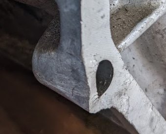

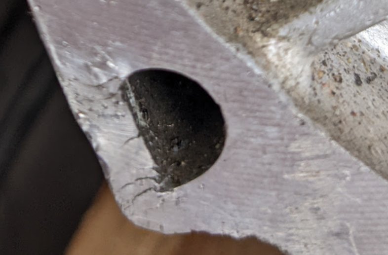

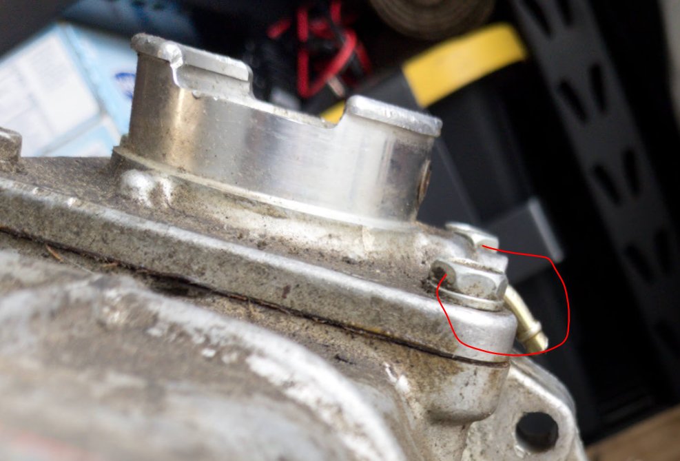

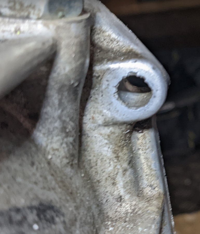

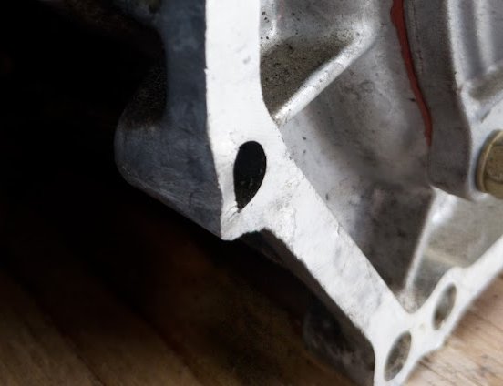

    Good find. I looked over his thread again last night. Should've checked his photos again today to compare. So it looks like the one alignment pin is missing. As for the damaged 14mm bolt hole, the front side of it is not damaged. I was able to track down the shifter plate with the vac line attachment. McGeorge actually does have it at 50 bones but ebay has it for 29. Not going to worry about it until I figure out this bolt hole issue. As for the flange, it appears fine - no damage.
    Will send a message to the seller tonight. At least I know now it wasn't damaged during shipping. Thanks for the feedback :thumbsup:

    "Part Grade: A" ----- my ass :mad:

    That hole in 90% sure is for a bolt.
    To be honest missing one bolt isn’t the end of the world. But drilling it out and putting a bolt in the hole will be fine.

    Thanks Dan but don't think I'm going to risk drilling it out so it will take that 14mm bolt. Looking at it, not sure how much (not much I think) padding there will be lol. My luck judging by the visible fracturing, it will probably break right off :bananadead:

    14mm head is a 10mm thread. It’s not the end of the world. If they offer to take it back, let them. But if the offer like half off or the such, I wouldn’t hesitate to run it

    Send a drill bit and a helicoil in, boom better than new

    Worst case, weld it shut and drill a new hole.
    You'll fill any cracks, if any.

    The threads are in the transmission. All he needs is a hole

    Perfect, drill the mofo, plenty of meat left, this is not a high stress fastening location or it would be a bigger bolt
