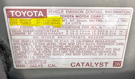

    So the way it works (at least to my knowledge) is the aftermarket CAT not only has to be CARB certified but it has to be a match for the engine "Test Group".
    When I replaced the exhaust manifold cat in the wife's lancer, magnaflow offer a CARB compliant and matching test group.
    With this PZEV (Partial Zero Emissions Vehicle) camry, no dice. OE or nothing. Magnaflow does offer a downstream CAT for it but not the exhaust manifold cat.
    When I smogged the lancer after installing the magnaflow, the cert wasn't good enough. The tech put the car up on the lift and visually confirmed the aftermaket cat was the same as in the magnaflow doc I provided.

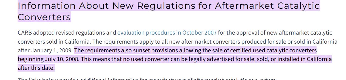

    The toyota parts counter kid suggested I check the salvage yard. Hell, I'm not even sure you can purchase a used cat legally anymore. All those damned CAT thefts.
    eon_blue[QUOTED] likes this.

    Yep, illegal to sell a used CAT in California. Meow.

  20. Feb 23, 2022 at 2:00 PM
    eon_blue
    Mar 4, 2016
    #180213
    70,130
    Azusa, CA
    Huh I didn't know that, well I guess its not like they're VIN matched so they wouldn't know if you did. Unless you get busted as the seller
