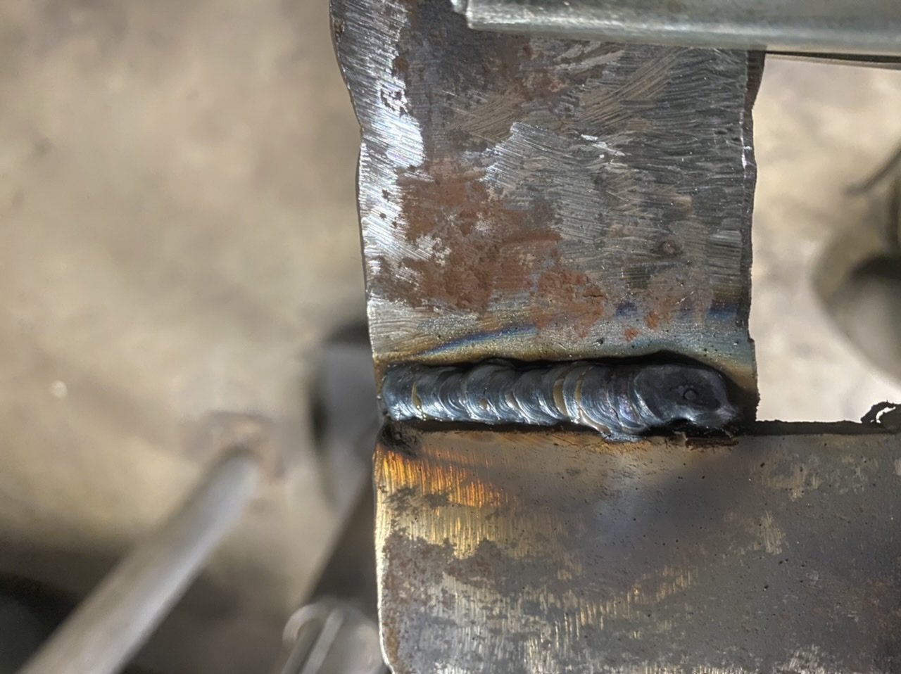

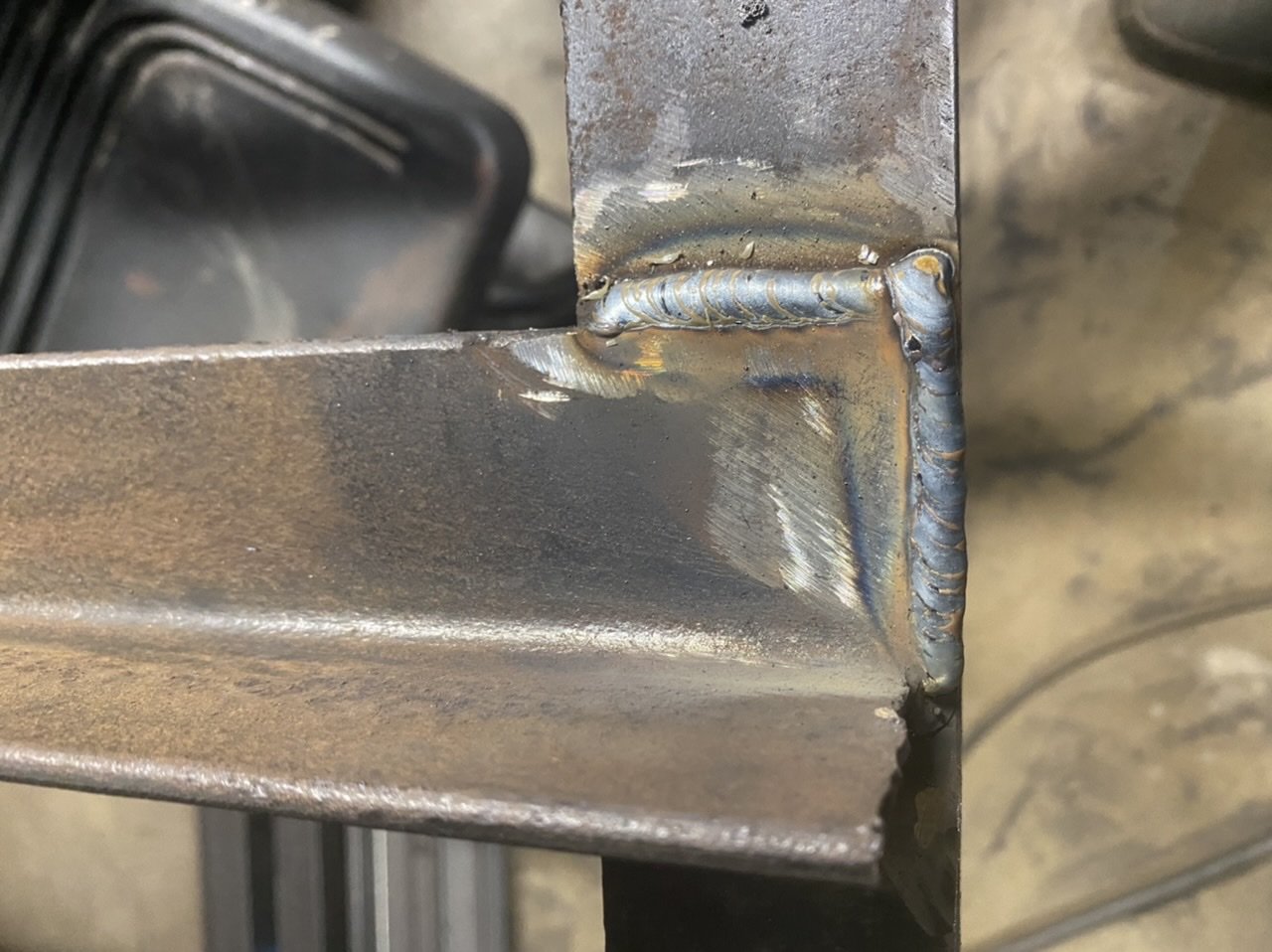

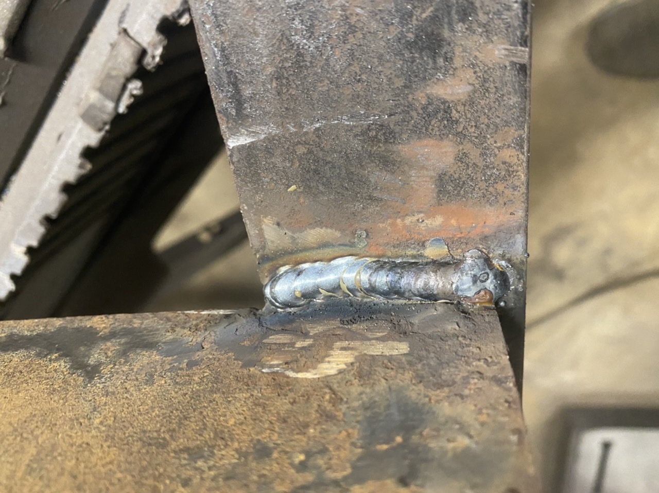

    4416CBC9-2196-4C54-AE63-83B510EC90C7.jpg 4416CBC9-2196-4C54-AE63-83B510EC90C7.jpg395D968D-0EF2-4BEE-A185-A91FE04949C3.jpg
    Welded that last one twice, and 3/16 is probably too big for this welder

    Tons of rust; can't be good for your health!
    Hope you hit a lot of that with a flap disc.
    I can't even begin to describe the nasty ass shit I had to weld last Thursday...

    Last pic looks like you are gettin it dialed in good.

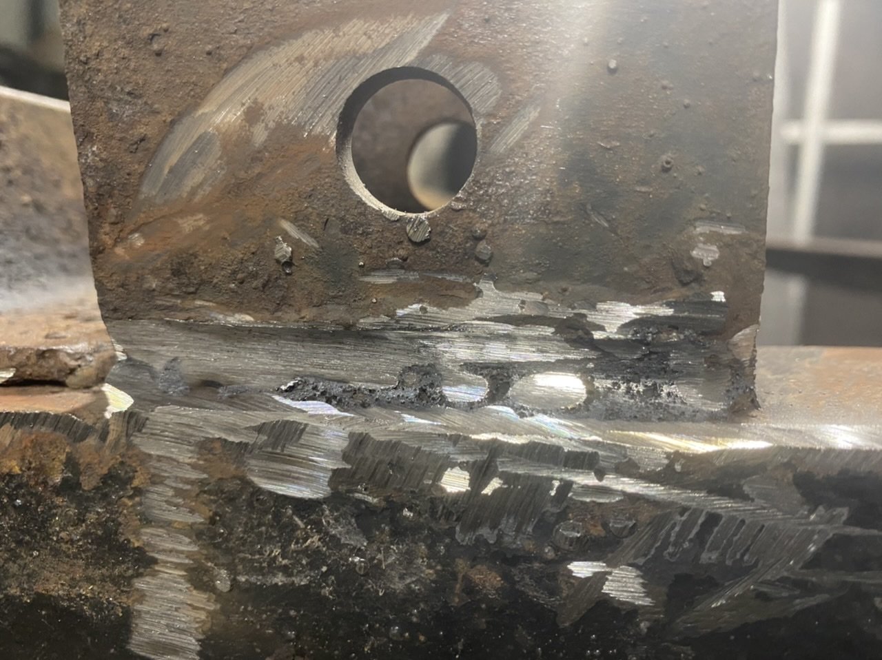

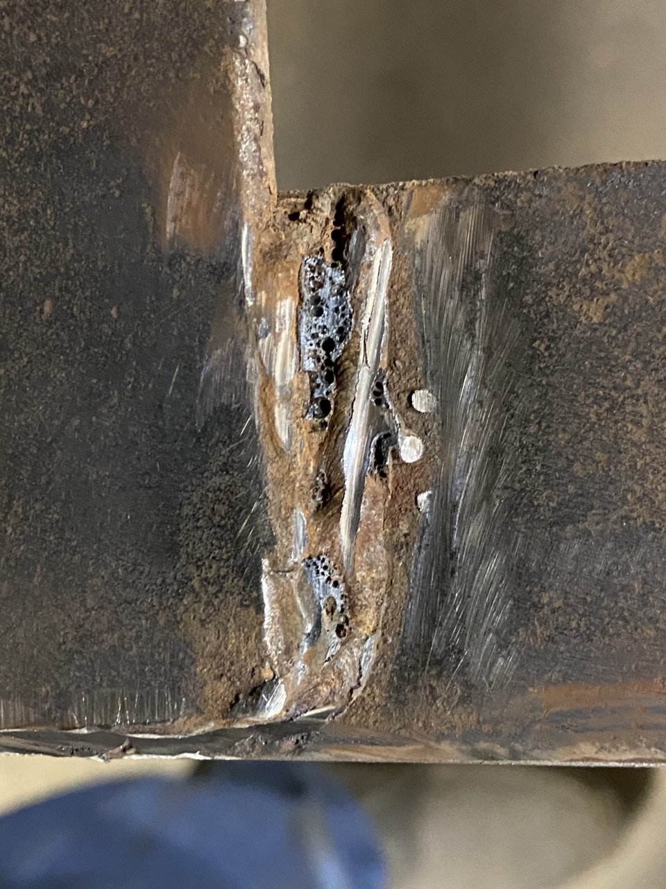

    Yeah I cleaned the welds themselves first. This thing is kind of an experiment anyway. Whoever welded it the first time was…. Well, I dunno. Gf is doing welding school and knows all the right words now, gonna keep me on my toes :laughing:
    some stuff that was pre existing

    Lol fuck, tons of porosity.
    Whoever welded that was long arcing like a mother, had no gas, or was doing this shit outside in the wind...or all of the above :rofl:
