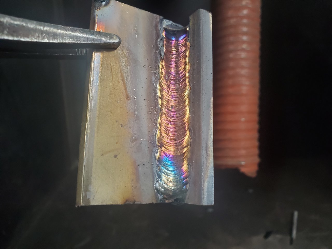

    Different rods for different applications.
    6010 will be your root weld for a lot of things whether it's on pipe, I beam or what have you.
    If you do stainless steel, you'll only ever use 308/L. You learn 70xx rod, you'll easily run 308/L. You'll never realistically run verticals on stainless, but it's fun to learn as it helps you learn vertical with other rods on ferrous steel.

  3. Feb 24, 2022 at 7:34 AM
    Kwikvette
    Feb 27, 2019
    #284735
    81,580
    Fresno County
    4 run, 2 don't
    @0xDEADBEEF
    308/L vertical up on stainless
    Same rod, same metal, but flat
    And 6011 on mild steel

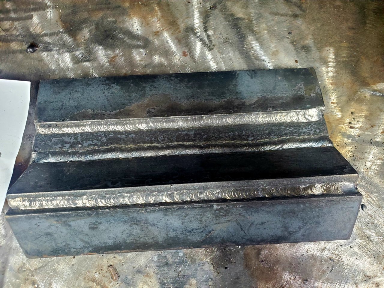

    All is correct but the 70xx part... The first 2 numbers in an electrodes designation is the tensile strength 7018 is 10k psi stronger than 6010

    I do understand tensile strengths, but 70xx rods don't penetrate as much which is why 6010 would normally be run as your root weld.
