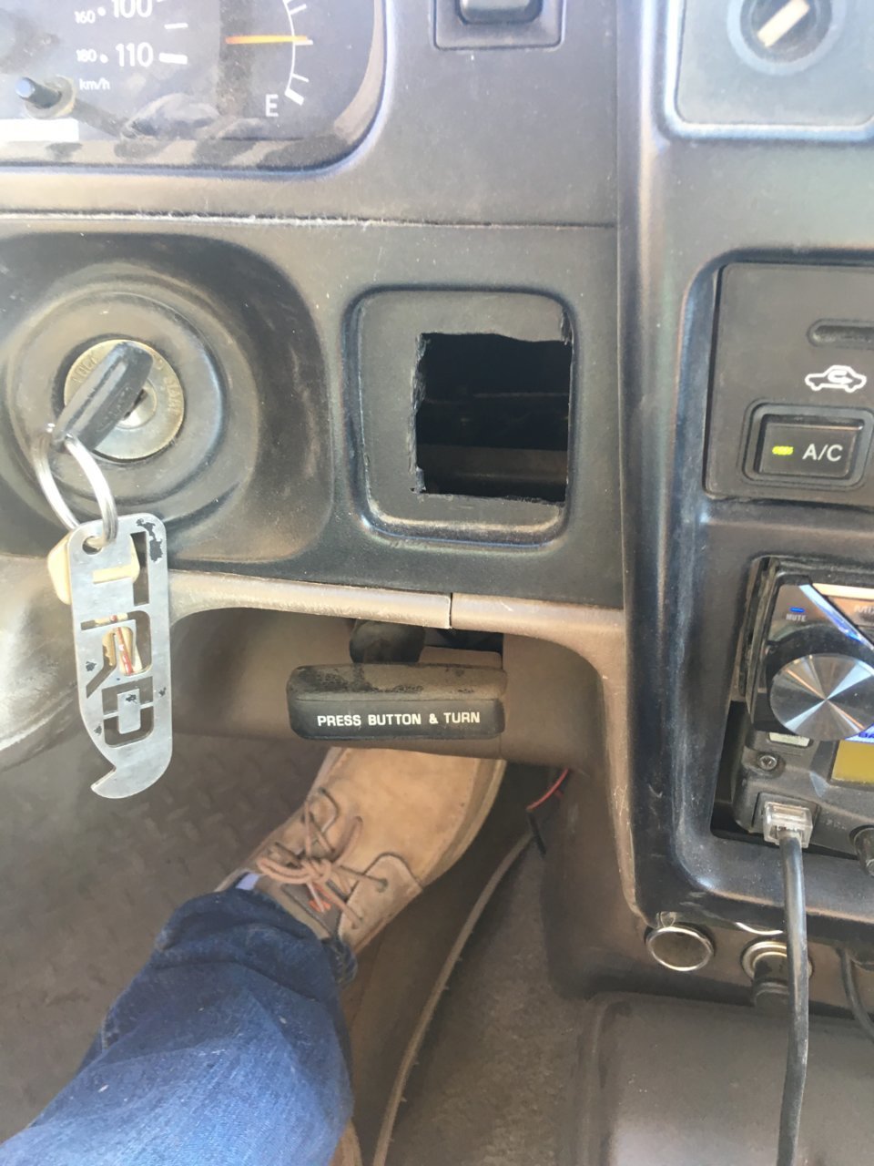

    Hmm, nah everything looks good here.
    :p

    Just draw a clock on a piece of paper and tape it over the hole...it'll be right twice a day at least

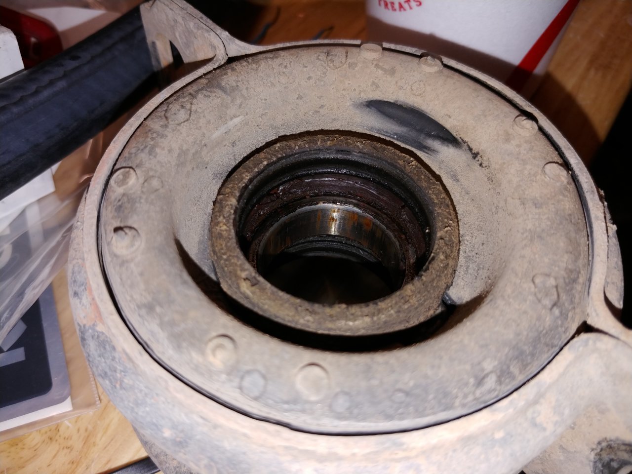

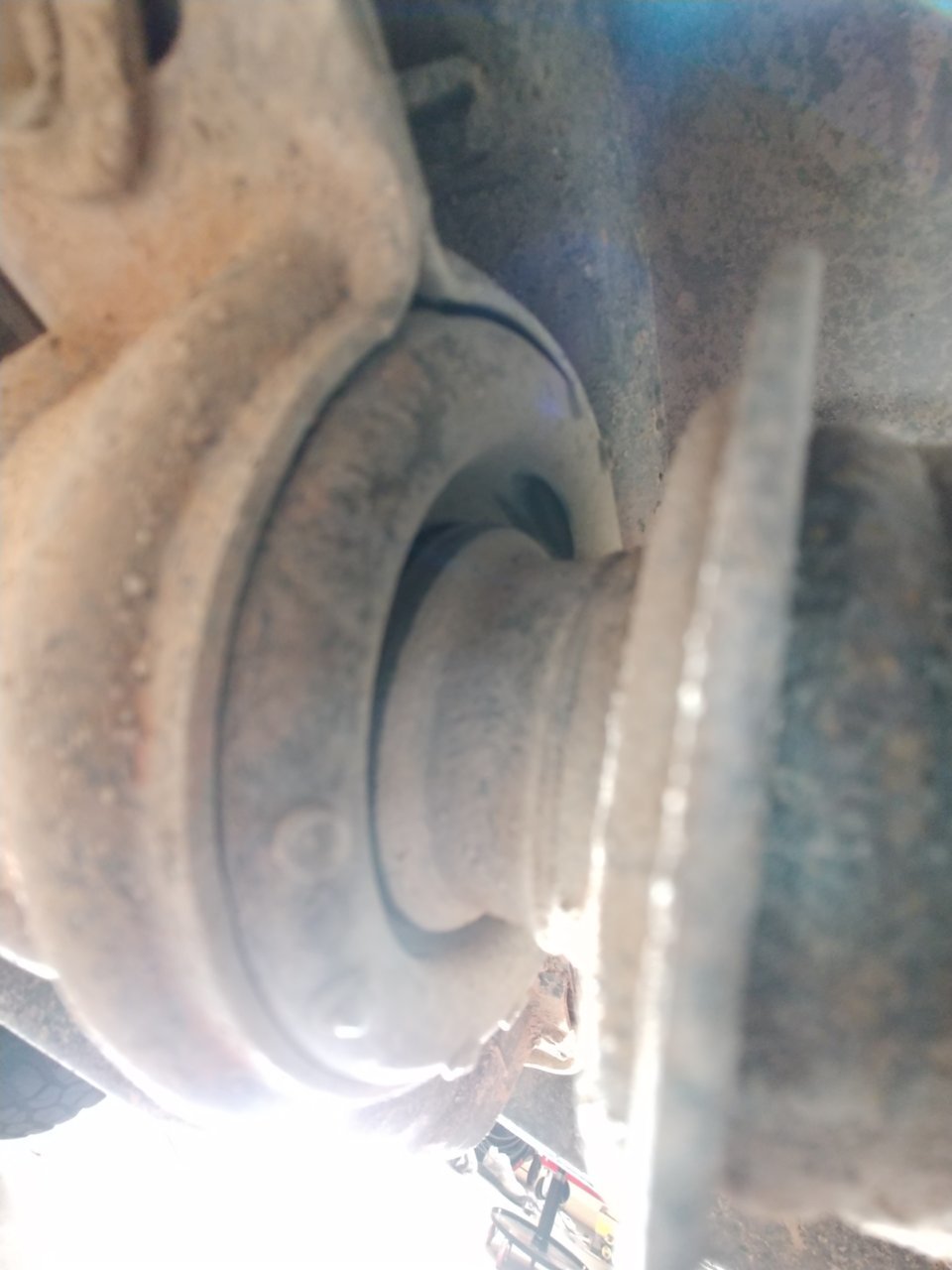

    These things are kinda annoying to change.
    Looks like it was bouncing a bit...

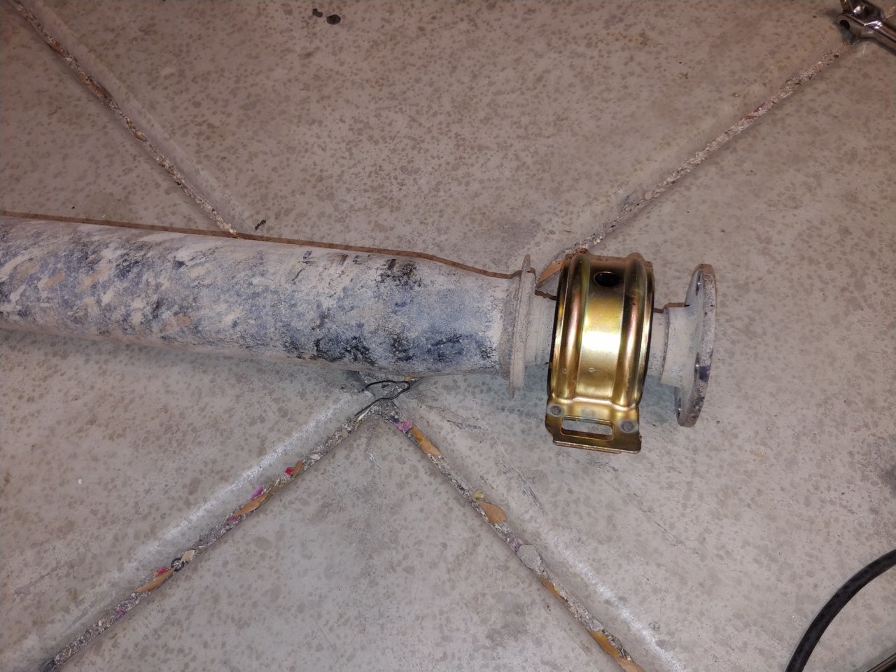

    The way the Toyota FSM says to torque it is pretty strange. You have to take the stake nut on, and off, and torque it again to get it seated.

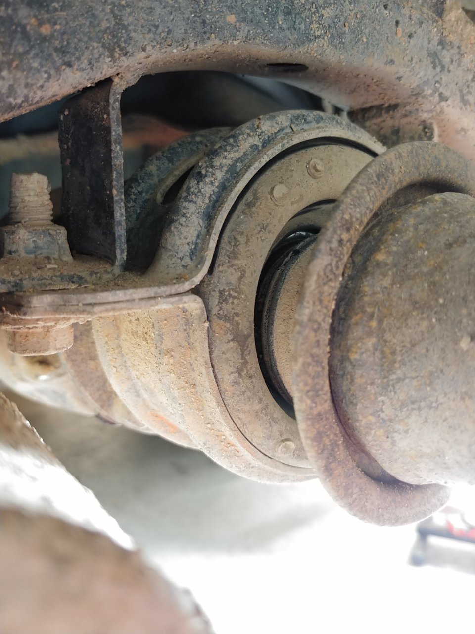

    I changed mine like 3 times this winter.... Old bearing didn’t care about the lift. New one, not so much.

    My old bearing is silky smooth but the rubber has given out

    Yeah torque to 134 to seat it fully on the shaft race, then loosen and retorque to 51 to hold it

    My bearing went bad going home from school one day. Sounded terrible.
    So I changed it, didn’t know about the fancy torque thing Tyler mentioned and just got it good an tight. Pretty sure that gonzo’d the first one.
    Second one I think the driveshaft wasn’t straight, gonzo’d that one.
    3rd one I used some spacers and lowered it, pretty sure I got everything right that time. I think.
