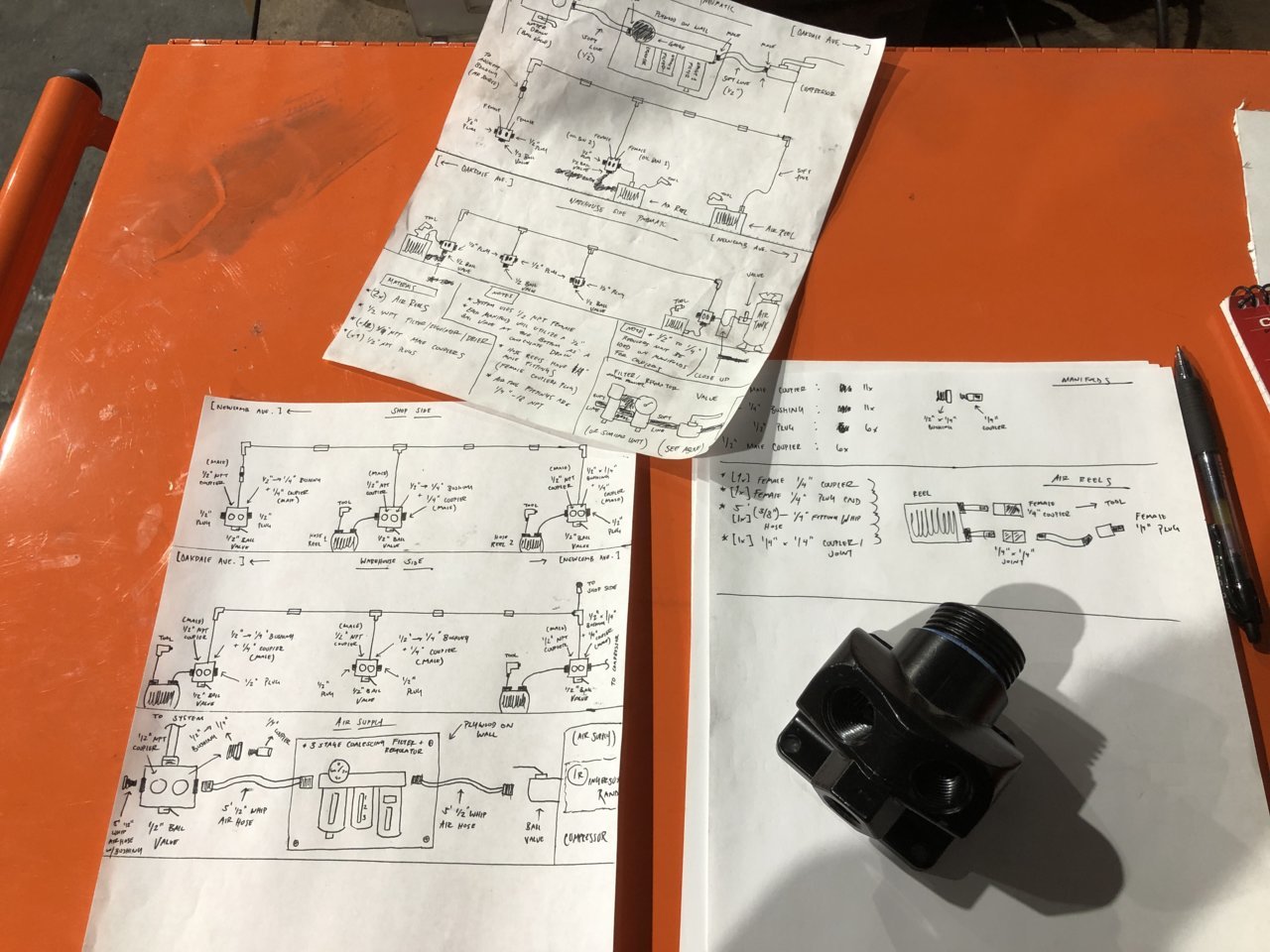

  11. Mar 11, 2022 at 3:01 PM
    BartMaster1234
    Aug 21, 2016
    #195197
    45,868
    Tyler
    Pittsburgh, Pennsylvania
    Flux Capacitor
    They have me designing the central pneumatic air system at work. My brain hurts from all these god damn fractions.
    Our impact gun for the lug nuts use 1/2” NPT, so I have to design the system to accommodate 1/4” and 1/2” air tools.
    Abeyancer and Wulf like this.
  12. Mar 11, 2022 at 3:20 PM
    Blue92
    Blue92 Well-Known Member
    Aug 26, 2017
    #228071
    16,479
    Daniel
    North Carolina
    2018 Sport
    It appears you are vastly over thinking it. 1-1/2" npt main supply in a loop around the facility, ball valves periodically so you can shut sections off. 3/4" npt drops with standard Milton or whatever quick connects on the end to accept hoses. On each drop, extend the line past the quick connect to the floor, screw valve down there so they can drain any moisture out whenever.

    He refurbishes Boeing coffee makers as a hobby
    OF COURSE he's over thinking it:laughing:

    This
    This why you dont let a computer boy do a pipe fitters job

    1/2 hose directly out of your compressor is gunna give you a bad time
