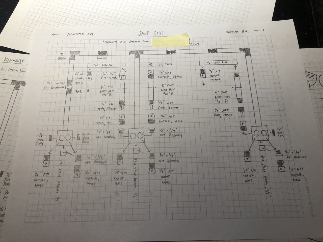

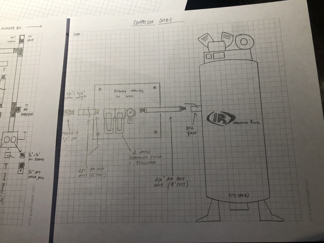

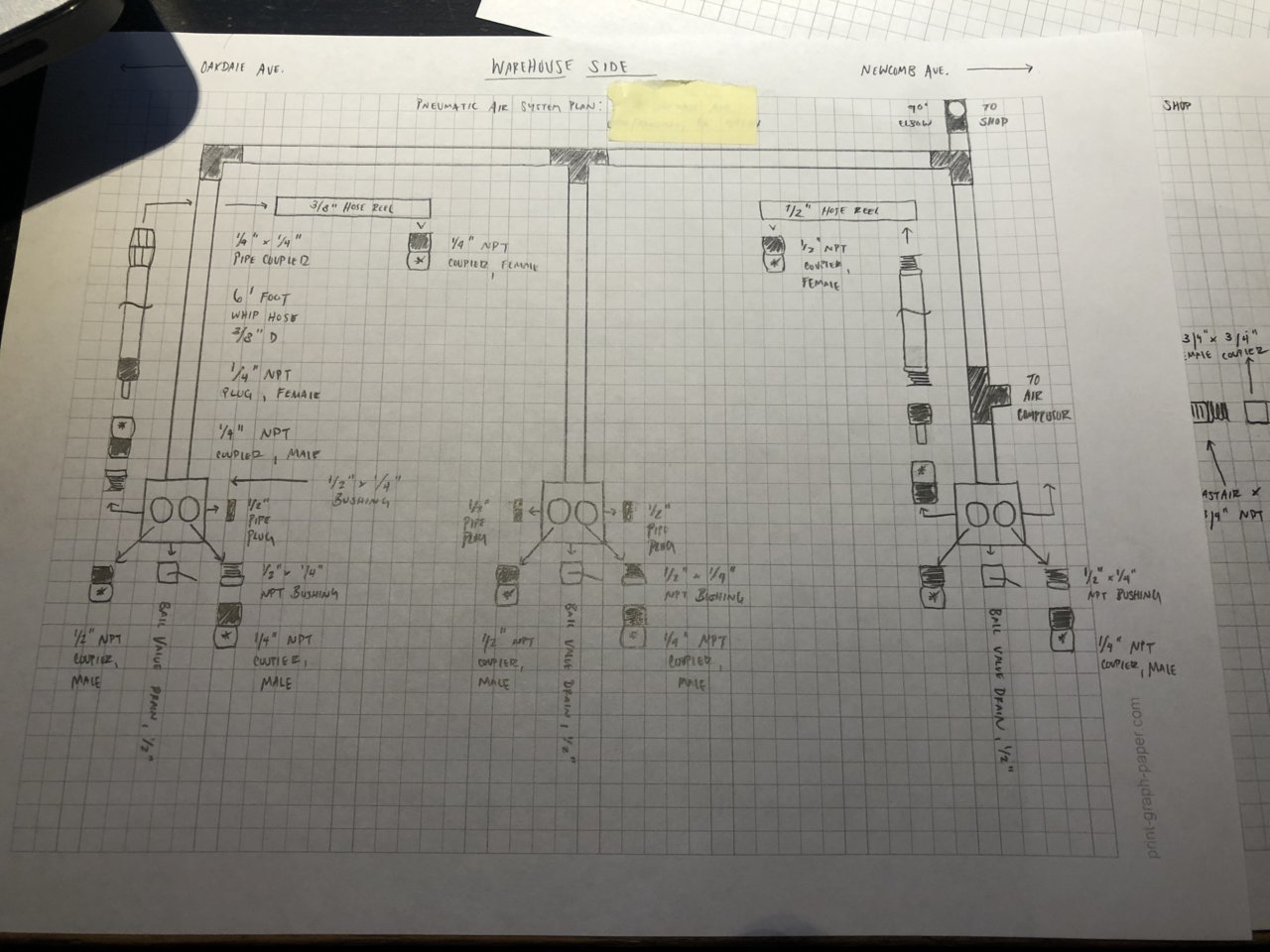

    @Abeyancer @Yota X @Blue92
    OK, this is my final iteration. I did a 3/4” air filter at the compressor instead of the 1/2” to avoid the bottleneck.
    Thoughts? This consists of two buildings. The shop building, and the warehouse. The system allows us to use both 1/2” air tools (mainly for lug nuts) and 1/4” air tools (for painting and powering the pneumatic oil pumps).
    AD091DB3-D6FC-42C3-9BD0-49CBE31675D2.jpg 810564D2-4615-4A18-93C1-2FEF56EA0F07.jpg 1ED627D4-4510-4199-B247-DED91058C4FE.jpg
    To give some context, this is what I’m working with. The Fastpipe air system utilizing 1” diameter aluminum pipe. It uses manifolds at each “drop” with four air ports each. In each building, there’s - 1/2” and 1/4” air reel in addition to a standard coupler to plug normal hoses into.
    If it were up to me I’d be doing the system with copper, but caveat empetor…
    unstpible, treyus30 and CS_AR like this.
