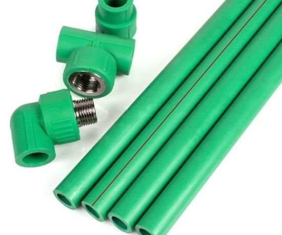

    @Black DOG Lila and if you wanna se shitty pipe this stuff sucks. Every store ive seen with this aquatherm pipe always has leaks, and it’s never at joints. Just pops up mid pipe, sometimes you see multiple leaks im one section of pipe

  16. Mar 19, 2022 at 9:31 PM
    Black DOG Lila
    Black DOG Lila Well-Known Member
    Jun 14, 2019
    #296344
    9,116
    Virginia
    2003 Tacoma SR5 2.7 5 speed 4WD
    Stock. EZ pass.Dump pass.Inspection sticker.Convict printed lic.plates.FG cap.
    Yeah, Copper Iron alloy has density.
    The Iron Copper alloy well head fittings are even denser.
    A 3" 90° ell is HEAVY.
    Abeyancer and Sperrunner[QUOTED] like this.

    @Black DOG Lila you a pipe fitter by trade? Or just like laying pipe lol
    Abeyancer likes this.
  19. Mar 19, 2022 at 9:36 PM
    Black DOG Lila
    Jun 14, 2019
    #296344
    9,116
    Virginia
    High Quality PPR should come with a child warning sticker and an adult
    DO NOT USE warning printed every 2"
