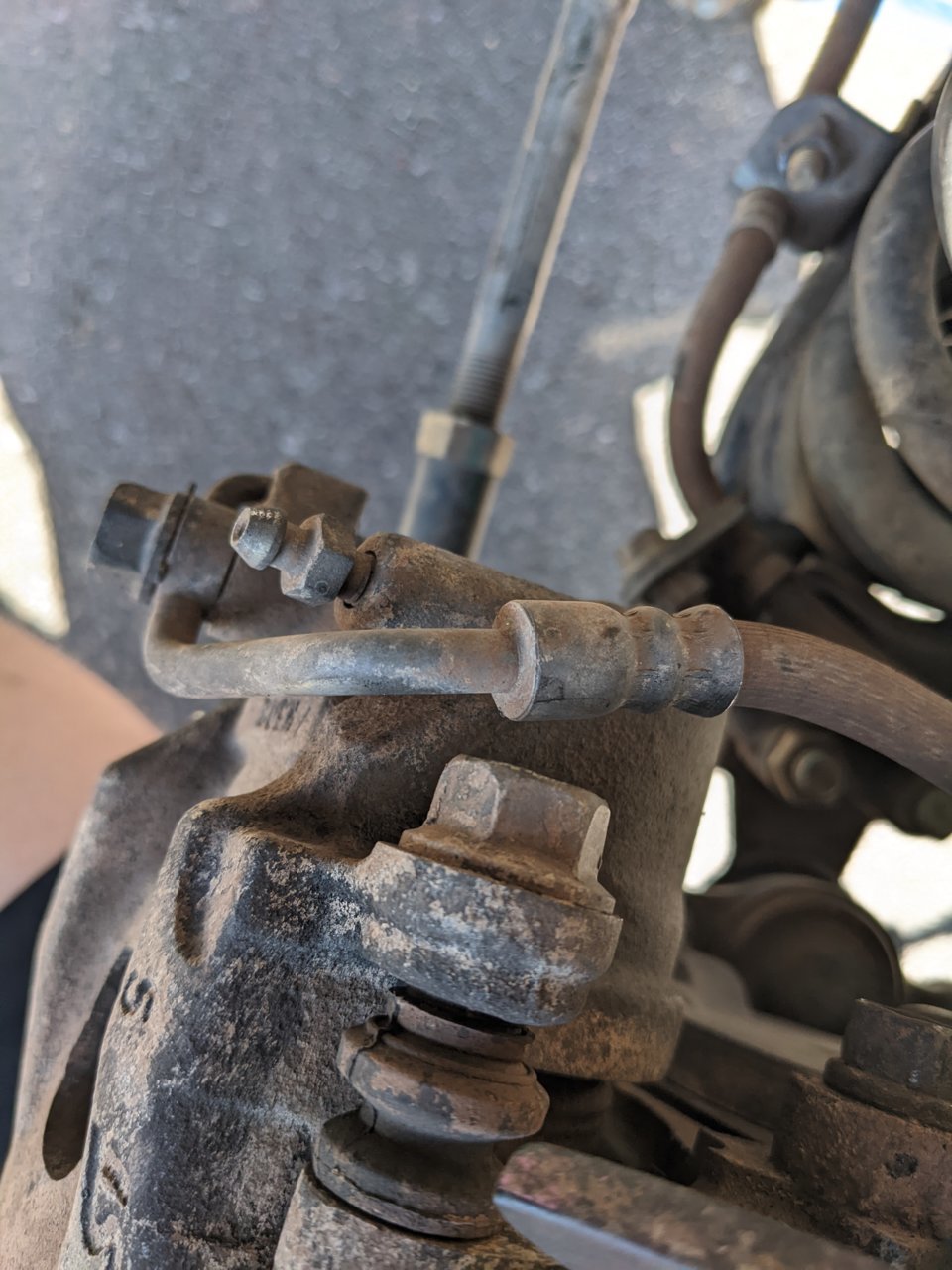

    How tf do i get this caliper bolt out with this design Toyota

    looks like you gotta disconnect the brake line.. which means bleeding the brakes too

    Loosen the hard line and move it

    Is there enough room against the rotor (without the pad) to pull the caliper back as you loosen?

    That works because they're still on the truck

    Remove the bottom bolt and rotate the caliper

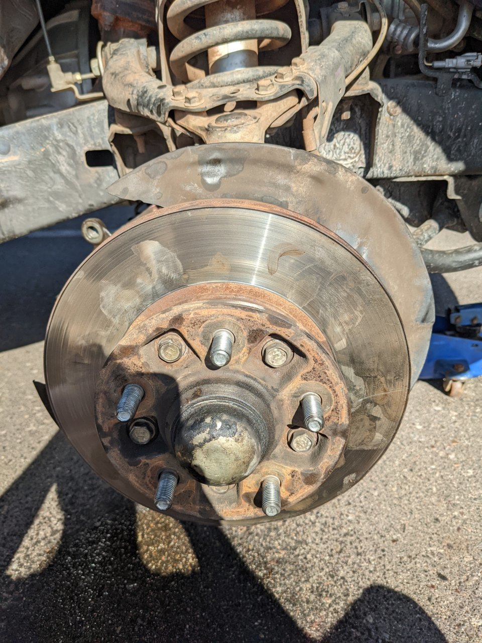

    Got it off now these bois are in my way but hard to break loose with free floating rotor... Hmmm

    Flat head screw drive up the middle of the rotor or put 2 lug nuts back on and use a bar of some kind to keep it from spinning.
    don’t wanna replace the lugs

    The Ryobi isnt breaking them loose hmmm
