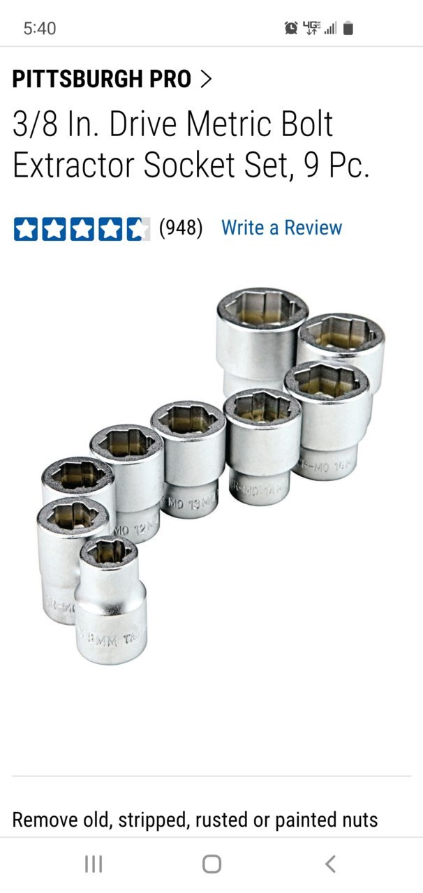

    They are definitely worth trying as they are one of the only options. I know Irwin makes a set of sockets that are helical looking on the inside that do good at grabbing rounded bolts. Forget what theyre called though. Seen em at the homedepot and we had a set at my last job for oh shit kinda moments when the torch was too inconvenient.

    I've had good luck with those @Das it mang
    For a baller on a budget HF has a set as well

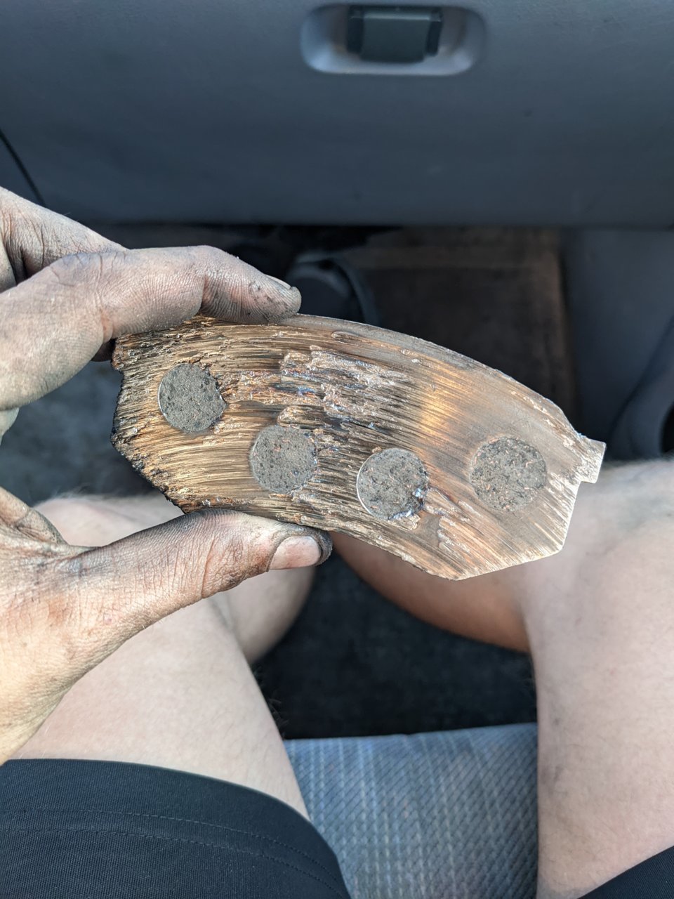

    My pads for reference

  13. Apr 5, 2022 at 5:42 PM
    Abeyancer
    Abeyancer Not so secret, secret van guy
    Mar 28, 2019
    #288326
    13,245
    Jimmie
    PNW
    98 4x4 ex cab tacoma 3rz
    Yea, this has been quite the learning experience for you :oops:

    If you get those sockets just use the 14, it'll be snug because it's designed to bite into rounded off nuts and bolt heads
