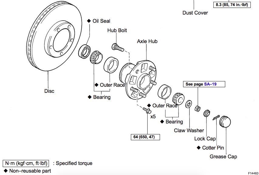

    I smacked the rotors kinda with a hammer lol. This will be a last choice just due to that

    If he breaks off the head he can just replace the rotor and bolt.
    Its the rotor thats thread not the hub. If I remember right

    So if the extractor sockets and heat is a no go just drill it out thru the head?

    Ill be surprised if those sockets like Jimmy linked wont work. Thats probably your best non heat related option. EZ outs work best when stuff isnt torqued down a whole lot, like little 1/4-20 bolts and screws. With bigger bolts you run the risk of snapping the ez out off inside the bolt.

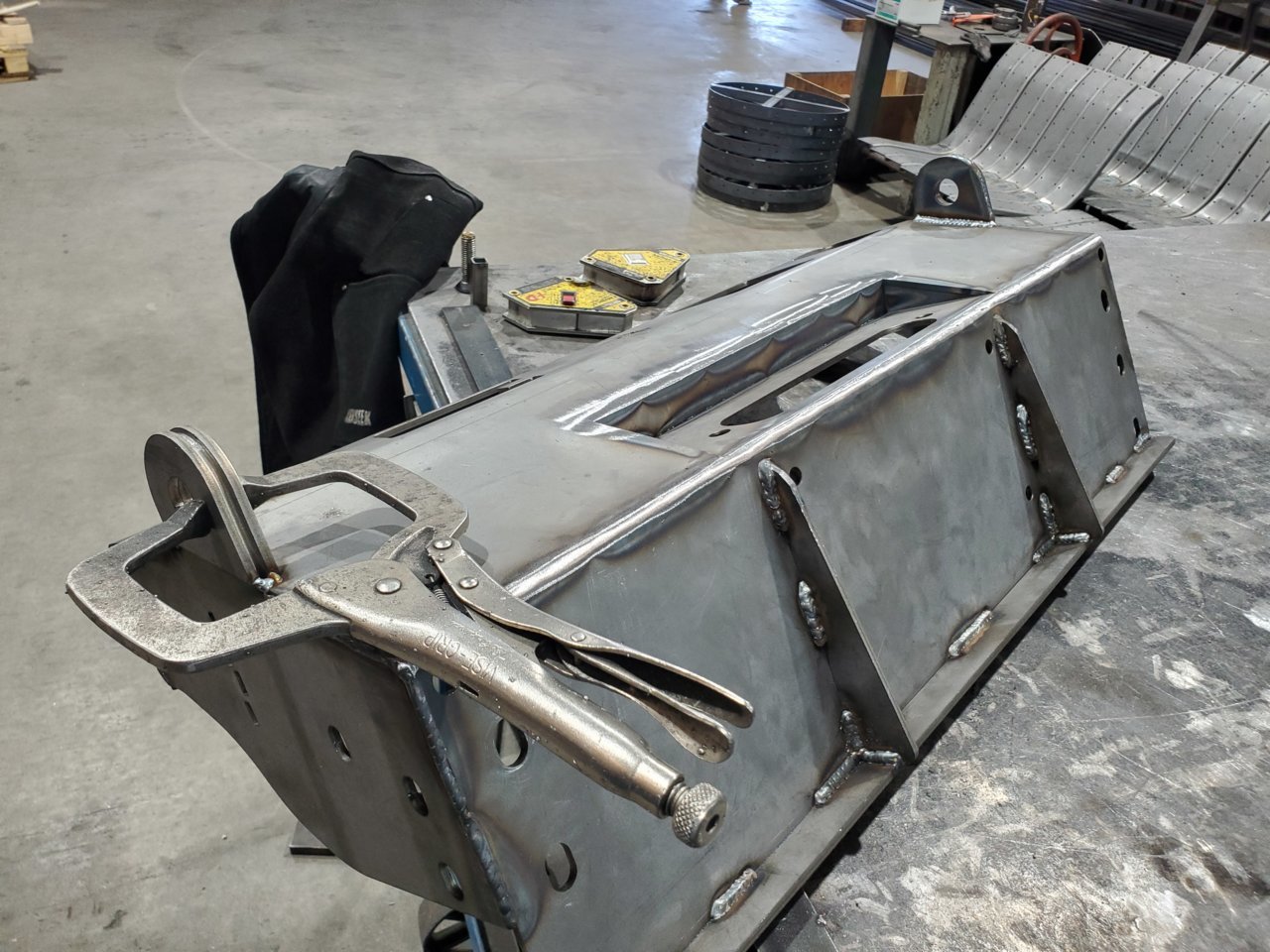

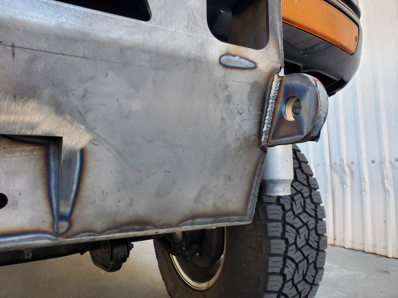

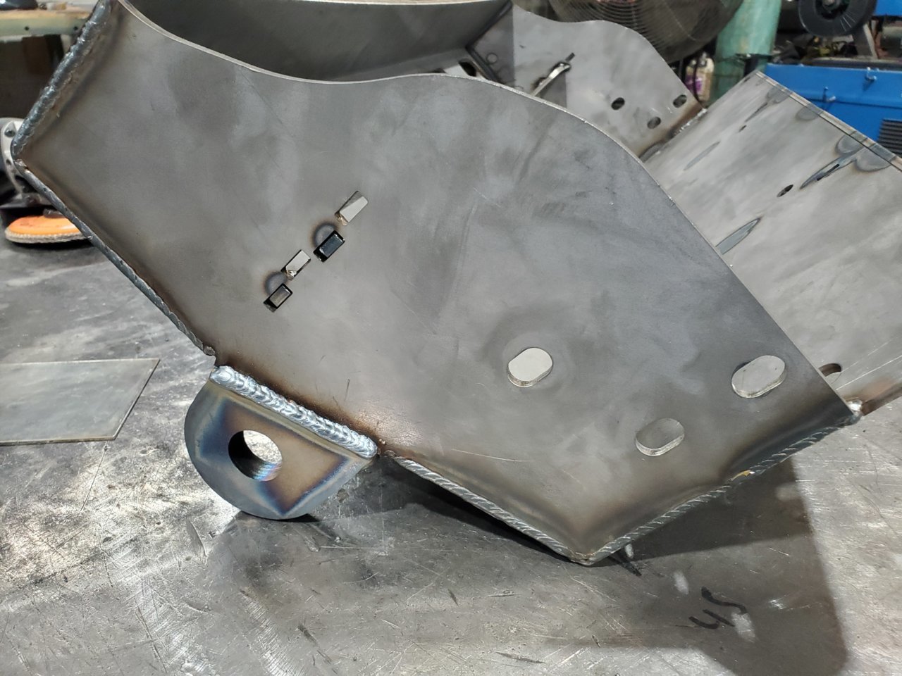

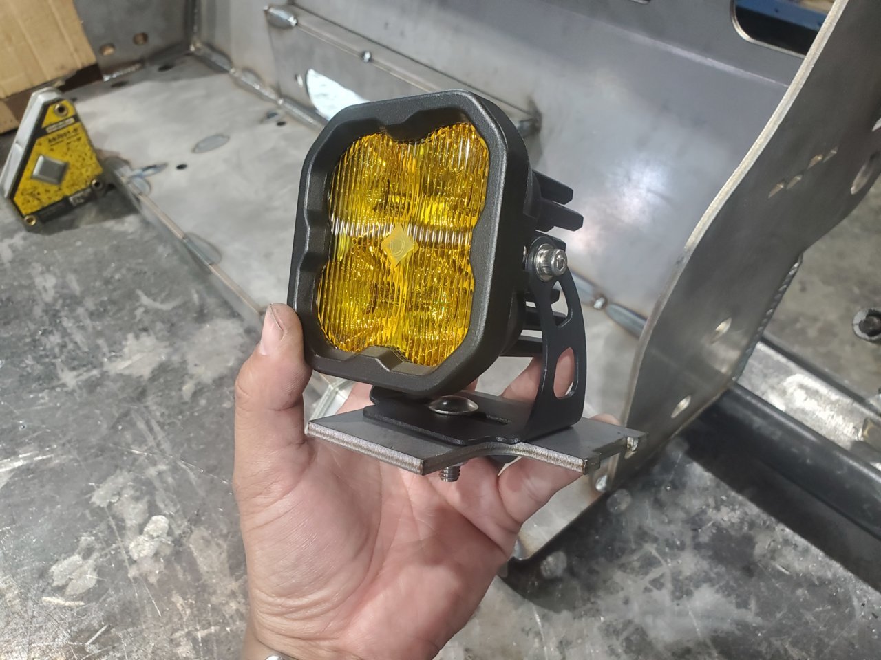

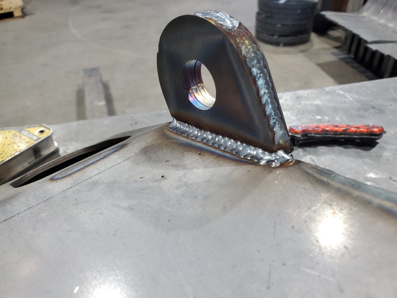

    Just for those that don't watch my "build" thread.
    Testing the position needed before welding the light brackets on -
    Then went on to weld the recovery points -

    to replace the rotor you have to pull the whole hub off the spindles anyways I would just pull it now and you can heat it from the rear

    Thanks miguel, does standard high temp grease work fine to repack after?

    Yeah any axle grease will be fine

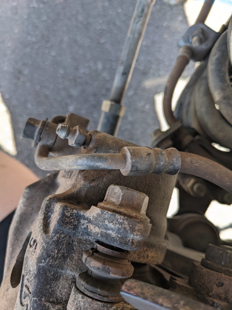

    Thank you! Btw the hard line was in front of caliper bolt, was that positioned wrong? I had to unbolt and move it to access, leaked all over

    I couldn’t tell you, been alone time since i looked at my brakes. Maybe check the other side?

    Good lawd, its like like Im looking at a 90's Ford. Why is that a thing when Im 90% sure every other vehicle Toyota made in the 2000's had slip on rotors?

    Yeah idk, its a dumb design. Annoying as hell when you gotta do anything
