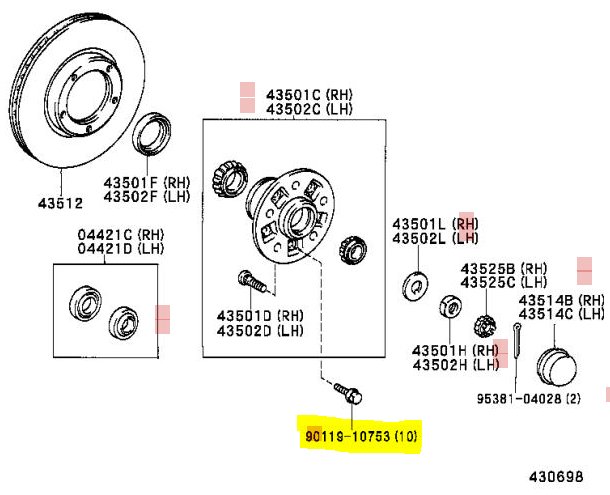

    I'm gonna quote you here to avoid the shitshow of the daily thread, but you really should get all matching OEM rotor bolts. You have a couple cheese grade fasteners in there and a couple of high strength but still weaker than stock replacements. Not a good place for compromises on parts.

    They're all grade 10.9 with one 8.8, cheese grade?
    Edit: they only had 9 of them, guess i can change that one 8.8 if needed?

    The stock Toyota rotor bolts are beyond the 10.9 metric bolt grade. I'm letting you know for your own info, insurance isn't kind in cases like these if you have a brake failure and take something/one out.
    Toyota is using a Class 10 JIS bolt which has different strength characteristics than a Class 10.9 Metric
    If you plan to get OEM bolts anyway, you can disregard this

    Part # to save for reference?
