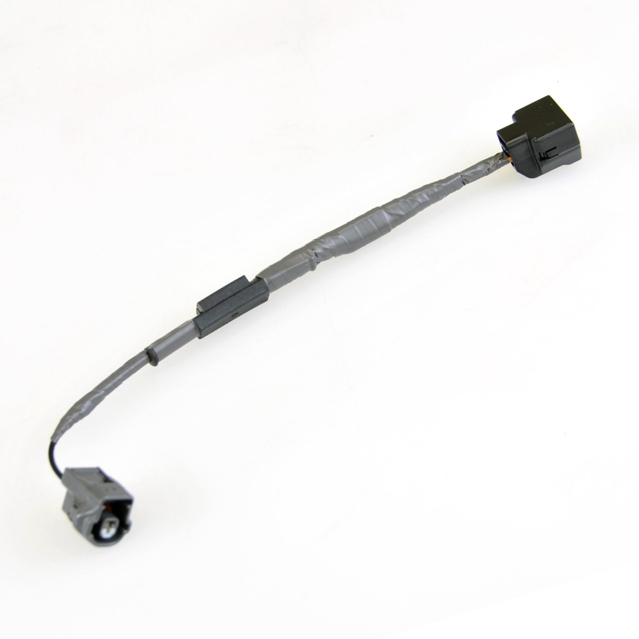

    Got the infamous P0325 knock sensor code this morning, and I'm about to start class soon so I won't be popping the hood until later.
    Most times it's a broken connector? I had already purchased a replacement from Wit's End coincidentally enough :laughing:

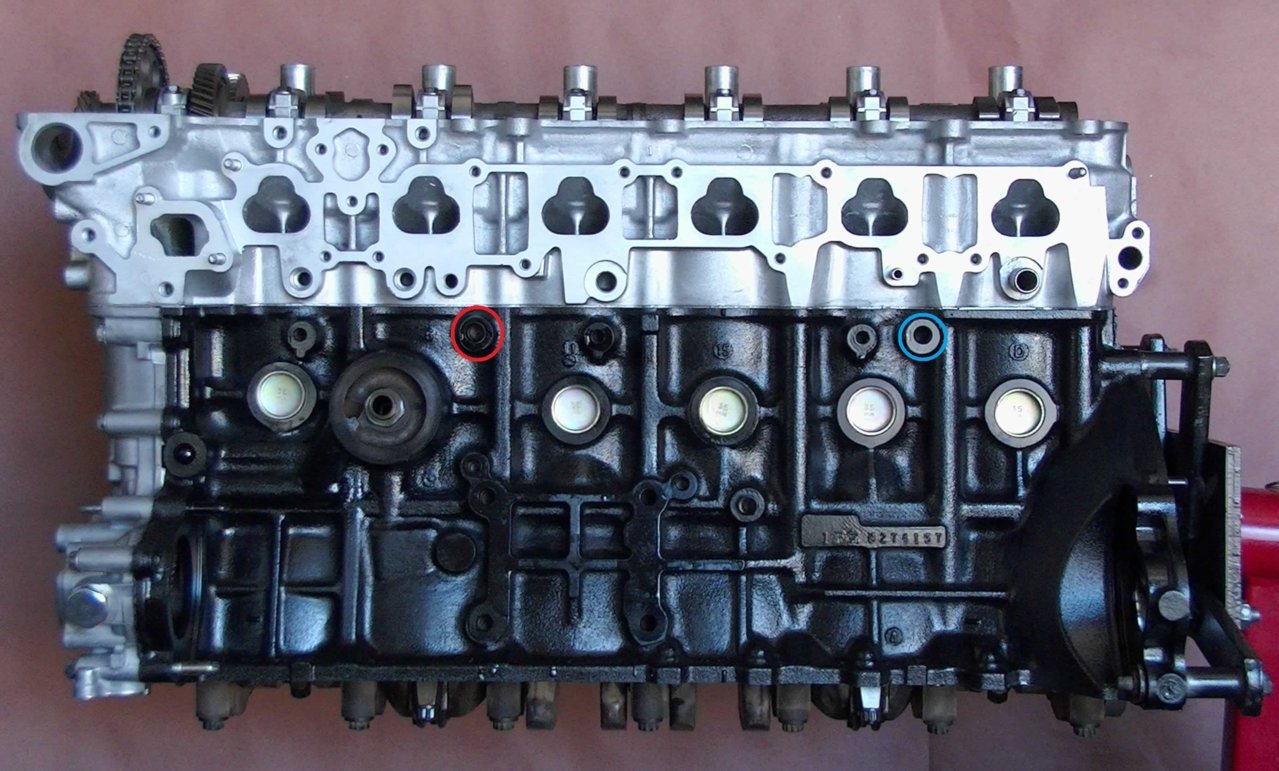

    That's the bank one knock sensor (front most), the easier of the two to reach and near less stuff to break by reaching it. Start by checking the wiring, sensors go sometimes too. Only buy the OEM sensor if it did and it's worth getting the right socket to install it or they break. I don't think you get fully reduced power mode unless both break

    It's right there below/next to the oil filter right?
    This is the plug I got thinking I *may* need it down the road. Seems I'm already at that point now lol
    https://absolute-wits-end.com/80-series-knock-sensor-connector-wire/
    Where the 2 connect is where I'd just cut the fucker in half.

    They're unfun to change, but the rear is the worst since it is near coolant lines and vacuum.
    If I remember right Bank 1 is red and Bank 2 is blue...
