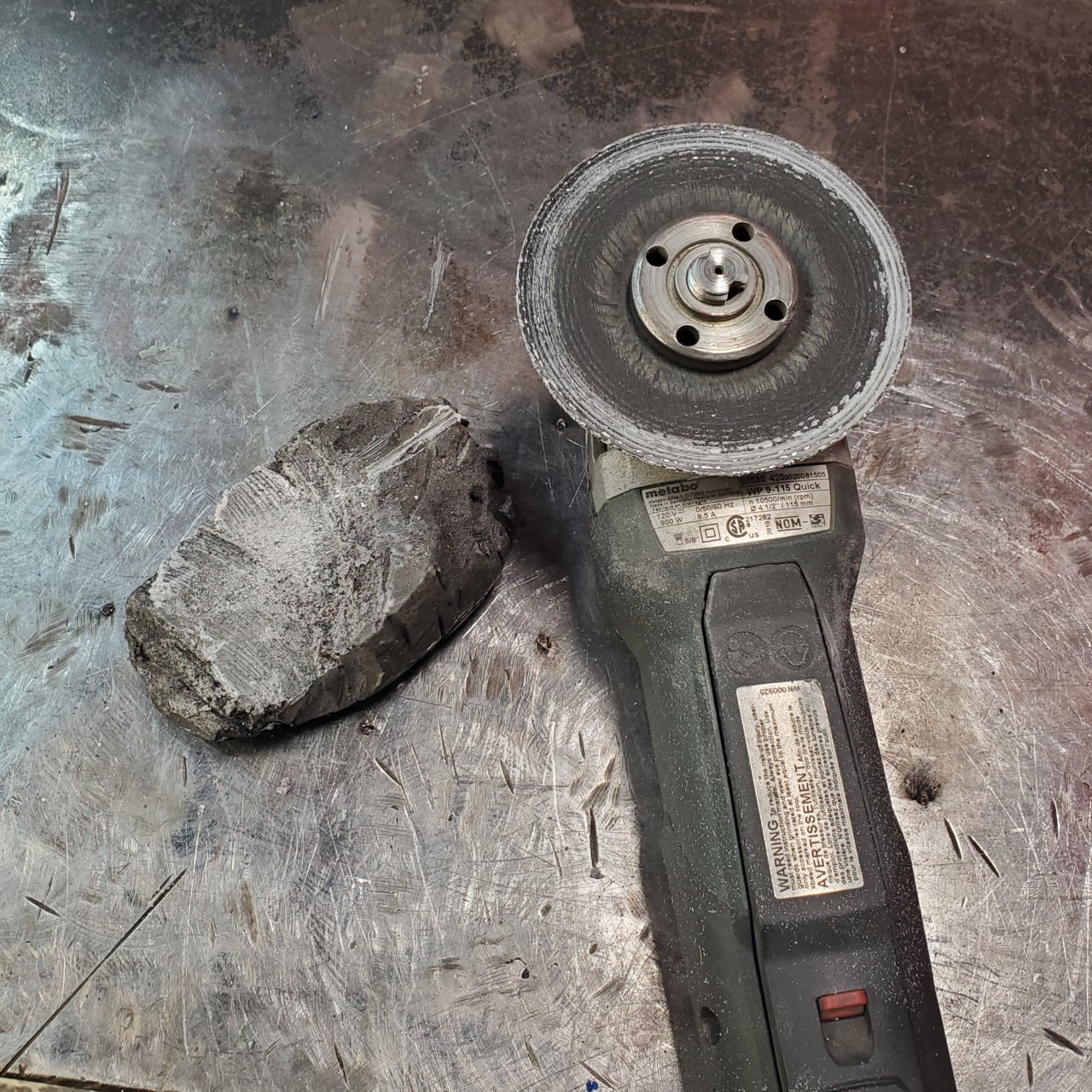

    @Kwikvette @0xDEADBEEF @Wulf and @ anyone else who likes/wants to be a garage fabricator
    This may not apply cause not alot of people work with aluminum but cutting or grinding is made soooo much easier if you "butter your disk" get yourself a big dollar store Jesus candle and bury the dusk into it anytime you're about to make cuts into aluminum. The wax will melt and prevent the aluminum from bonding to the disk, significantly reducing clogging

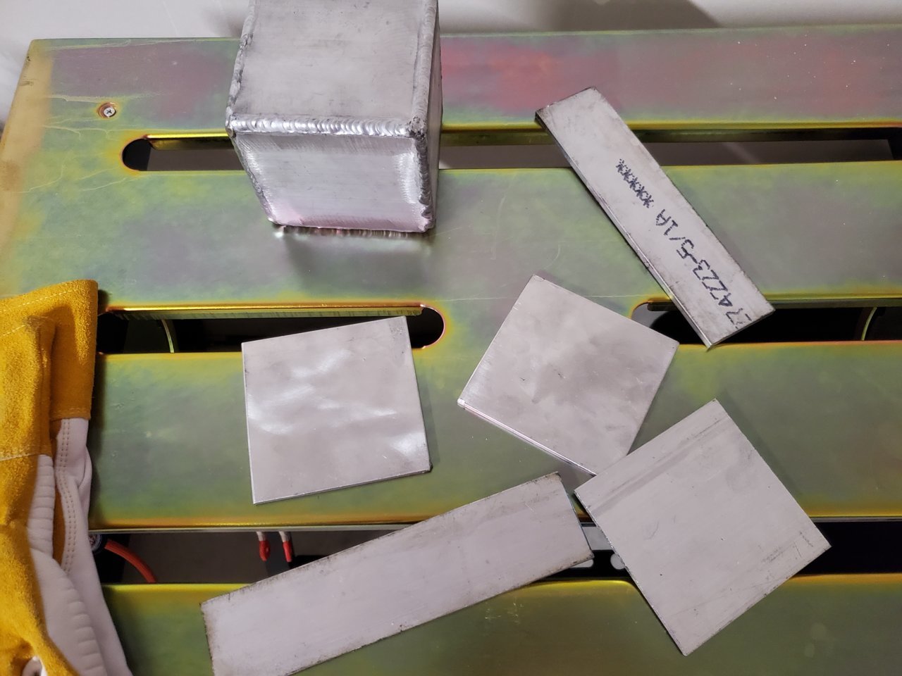

    I brought some aluminum coupons today to dial in my gas lens once I get some gas.
    I've always cut aluminum with a miter saw or plasma cutter; on the miter saw that shit flings everywhere and embeds into your clothes even.
    Abeyancer[QUOTED] and Wulf like this.
