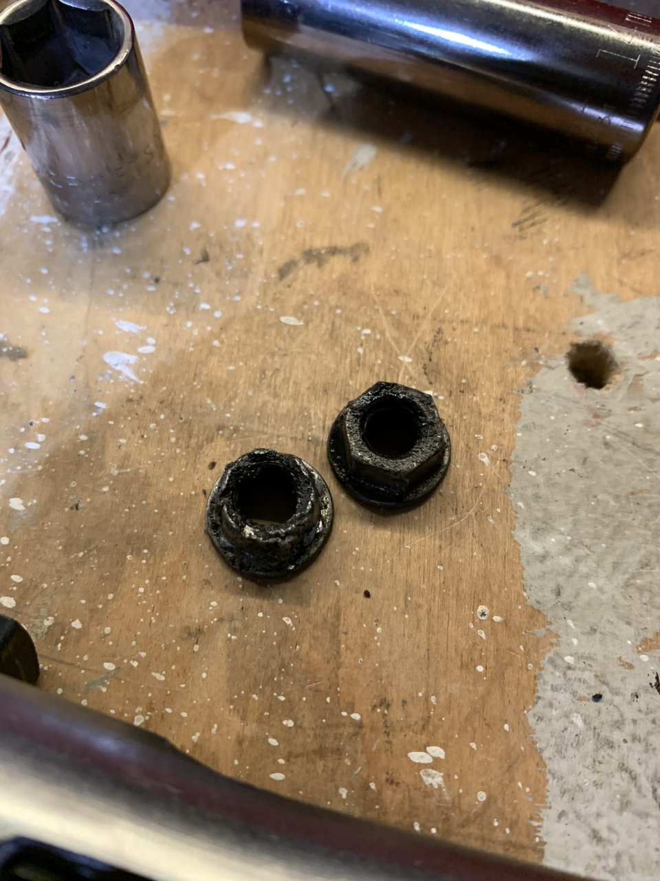

    The guy who had my truck before me completely rounded off the bottom nut on the housing. I had to take off the alternator belt and lower radiator hose and spend probably 3 hours with vice grips and spiral sockets to finally break it free. F819D34E-9027-49D8-B42E-21F42050C85A.jpg

    Yep!
    Specifically need those sockets that grip the walls and not the corners of said bolts. That and if the socket is shallow enough, both those factors will easily round them off.

    Yeah it sucked ass. The stud came out with it so I tightened it by hand and needle nose as much as possible before twisting the new nut on.
