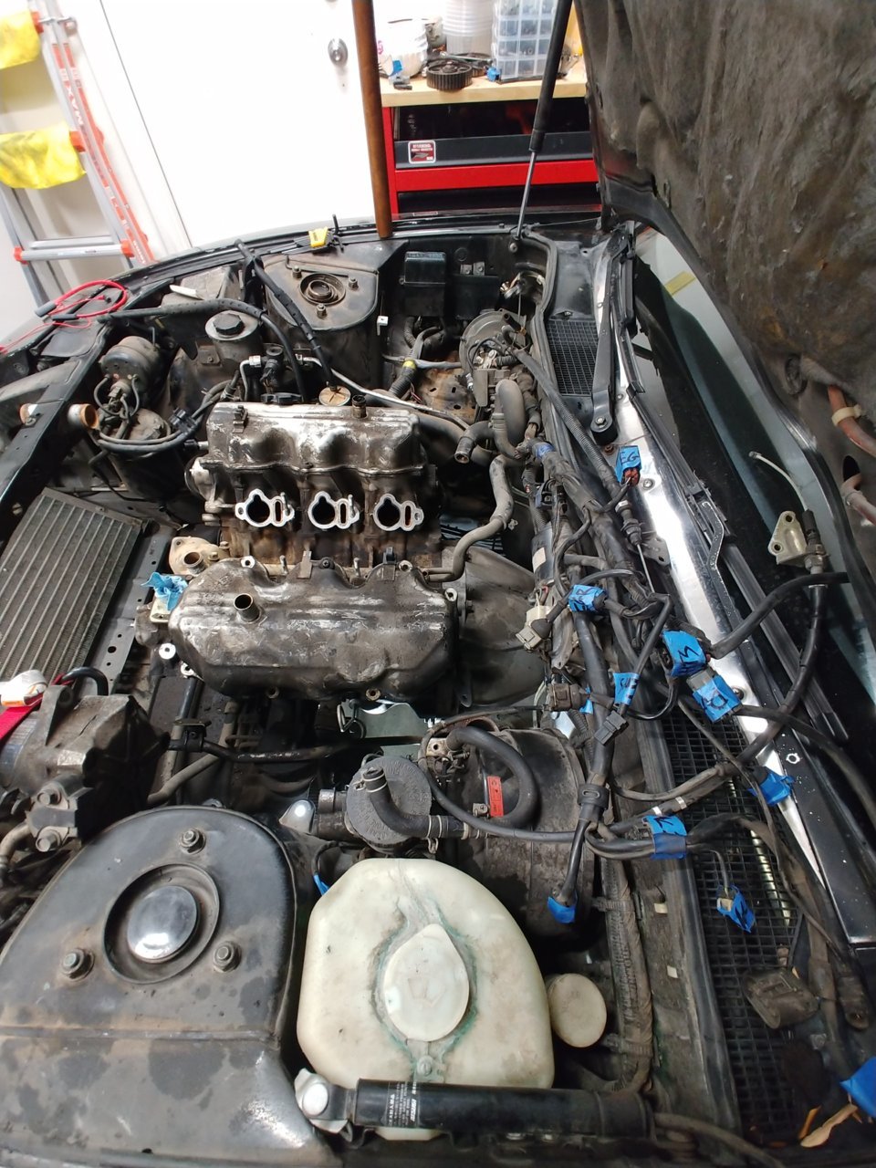

  3. Oct 5, 2018 at 11:58 PM
    Speedytech7
    Feb 20, 2014
    #123587
    58,247
    FCQM+VG Cheney, Washington
    It's less Tacoma and more mod
    Nah it's just for ones with too low of a charge for the charge controller on the car to consider safe to recharge. It's really mostly for lithium cells.
    Also, no more anything bolted to the heads, it's ready to be pulled off for the shop. Gonna do the rear main cause why not it's so easy to reach the bell housing bolts right now...

    Very nice sir. Your moving almost as fast as I did when I pulled my motor and trans... took me 9 hours roughly to do it... just don’t be like me and end up having the thing sit apart for over 2 years lol

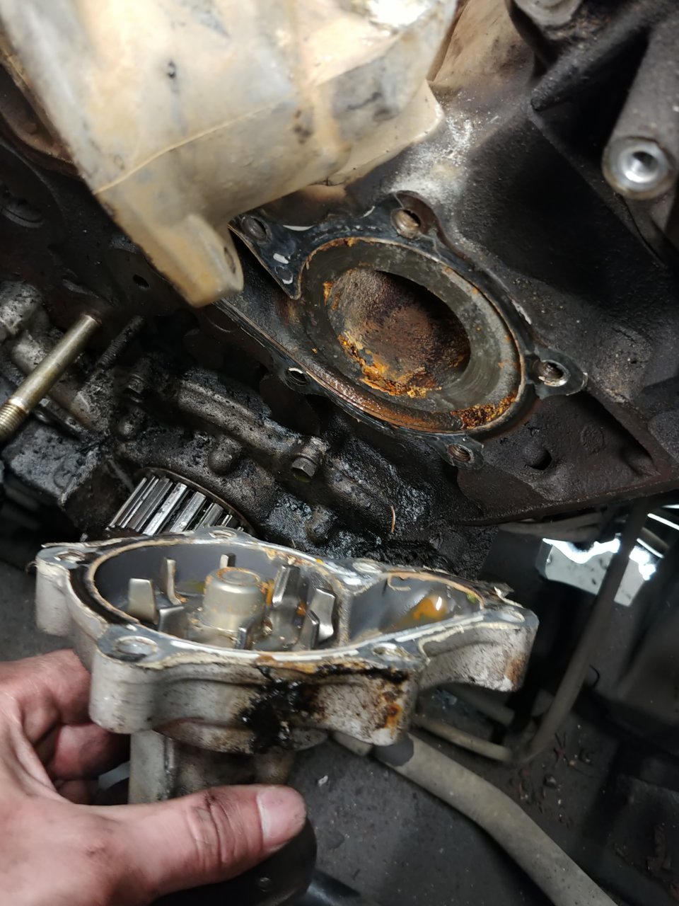

    Metal Impeller. They actually knew what they were doing.
    Why would Toyota make it out of plastic?

    Cavitation.

    put a metal impeller in a Corolla xrs and they overheat at high rpm because the speed of the engine and the metal impeller causes the coolant to boil around it creating basically an air pocket

    How would a plastic v. metal impeller help against cavitation?

    The newer 3.5 is a metal impeller. But from my understanding the impeller isn’t moving near as fast as it was in the 1mz and 3mz thanks to how it’s deisnged
