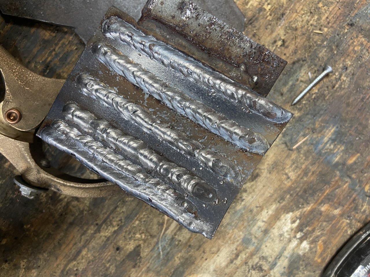

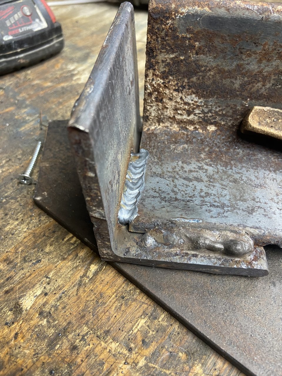

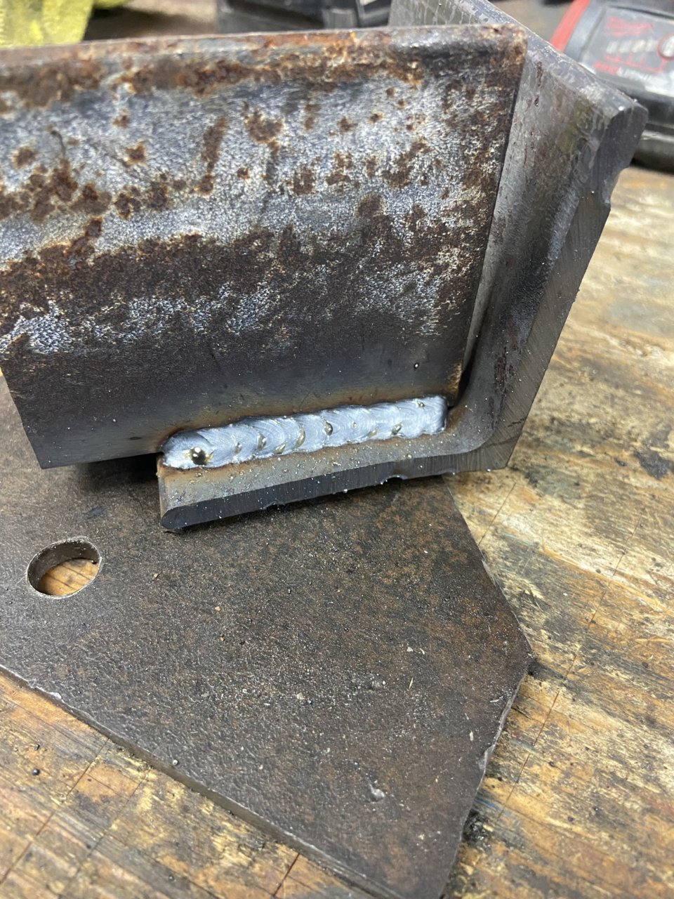

    Practicing welding. Frustrating. Beads looking ok 1 outta 5 ish. Idk why I’m so inconsistent. Laying dimes on mig is def an art.
    then when I don’t even clean it and just rip they turn out nice. (Stick welds not mine btw) Wtf
    794E0A0A-2AF4-4372-8070-844609757987.jpg 2026722A-1B9D-4281-8DCD-411568F4E92F.jpg

    Your welds have always looked strong and decent, at least the ones I've seen on your truck build.
    The number one thing you need to remind yourself every single time before you lay a bead (especially out of position), is that you need to be comfortable.
    Do a dry one, don't cheat yourself. Even if it's a short one. You need to find that you can do said bead from start to finish without anything getting in the way. You also need to start off as comfortable as you can. The less you twist your arms and body, the more consistent you will weld.
    It's like when I used to teach precision shooting. Number one rule was natural point of aim. If you get in position, and then adjust yourself to point at the target, you're using your muscles/etc. and you'll literally 1. exhaust yourself and 2. be inconsistent due to your natural point of aim being away from the target.
    To alleviate this you simply, pick yourself right up and move until you're naturally pointed where you need to be aiming.
    I'd use the same mentality for welding to just be in as much of a comfortable, and natural position as possible.
