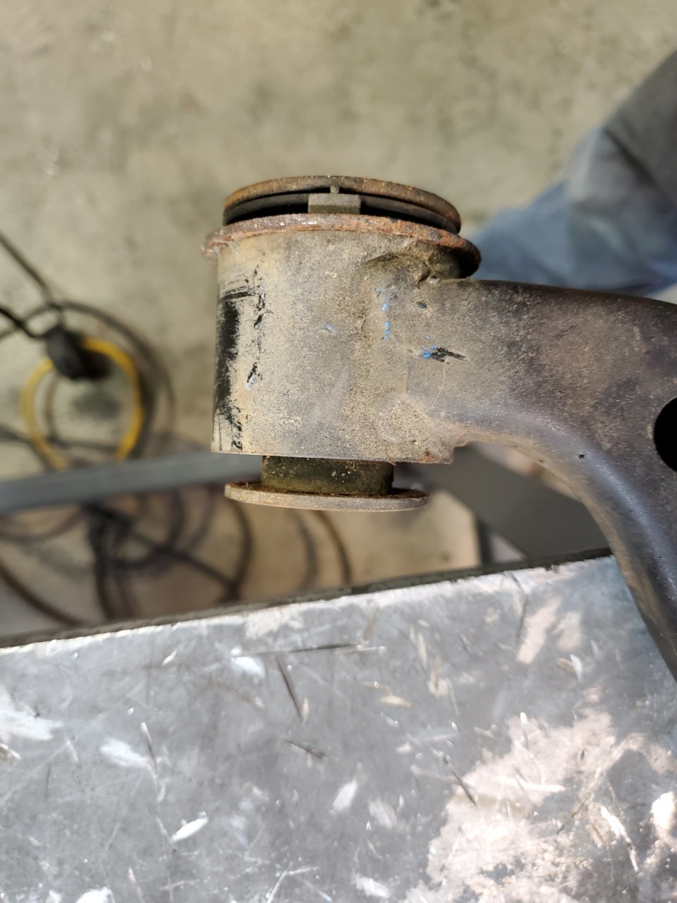

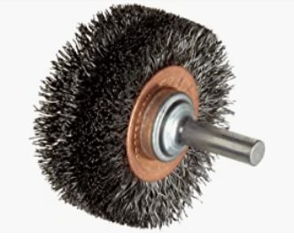

    Tim sure makes it look easy... What did I do wrong? The inner sleeve came out easy, the bushing on the other hand - pain in the ass and I think the neighbor wanted to call the fire department. I also killed a screwdriver.
    Maybe I should've just left the original in.
    CS_AR, unstpible and Abeyancer like this.

    Duro bumps makes a good bushing you simply slide into the inner sleeve after you brush off the rubber bits

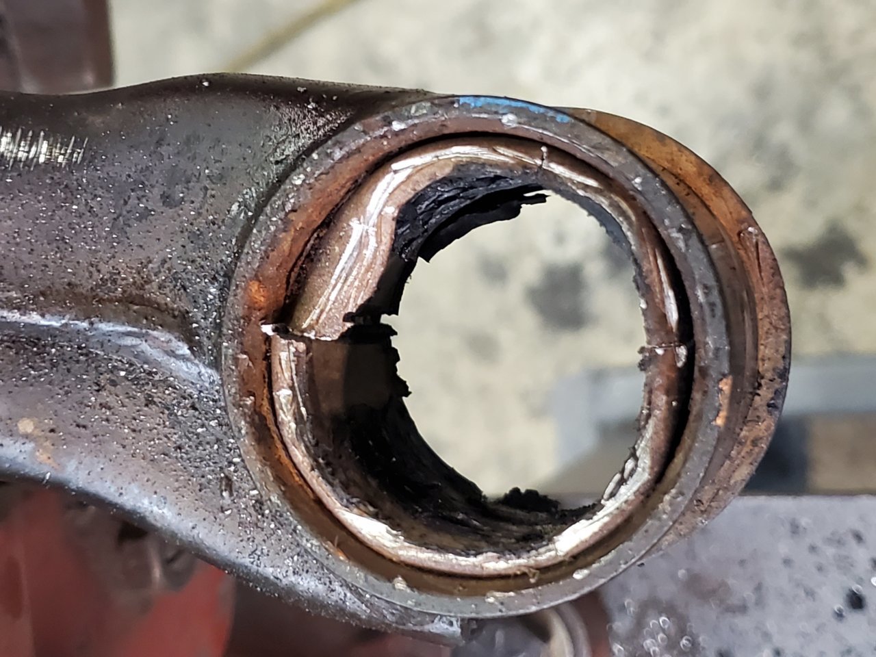

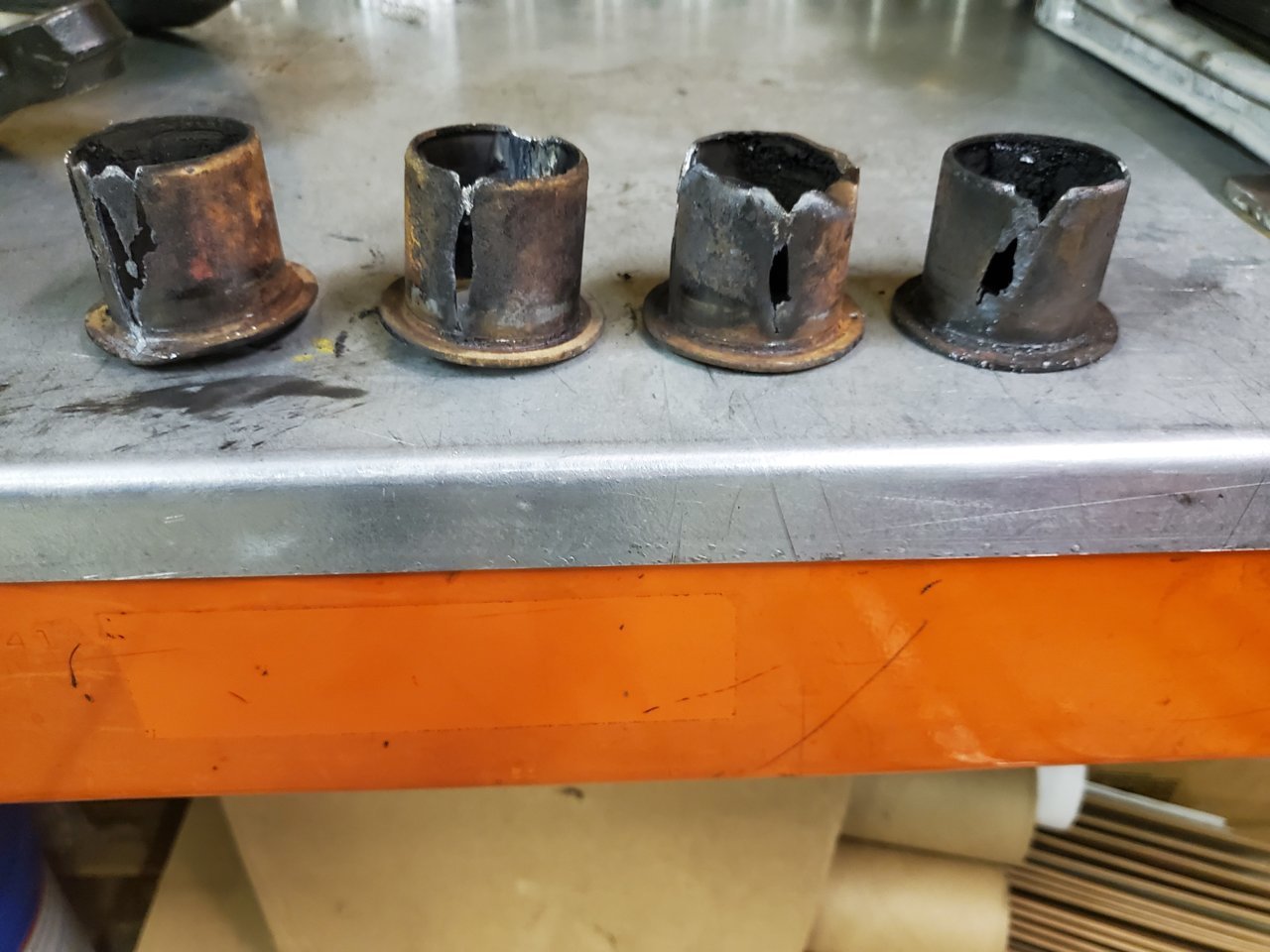

    I know the feeling.. I watched that video and figured I'd have zero issues since I bought a set of used CA arms.... wwwwooooooo buddy was I wrong. Here's a montage of my comedy of errors, I eventually had to pull out the oxy acetylene and carefully burn the outer sleeves out20200918_081100.jpg 20200918_103615.jpg 20200918_103327.jpg 20200918_132307.jpg 20200918_170718.jpg

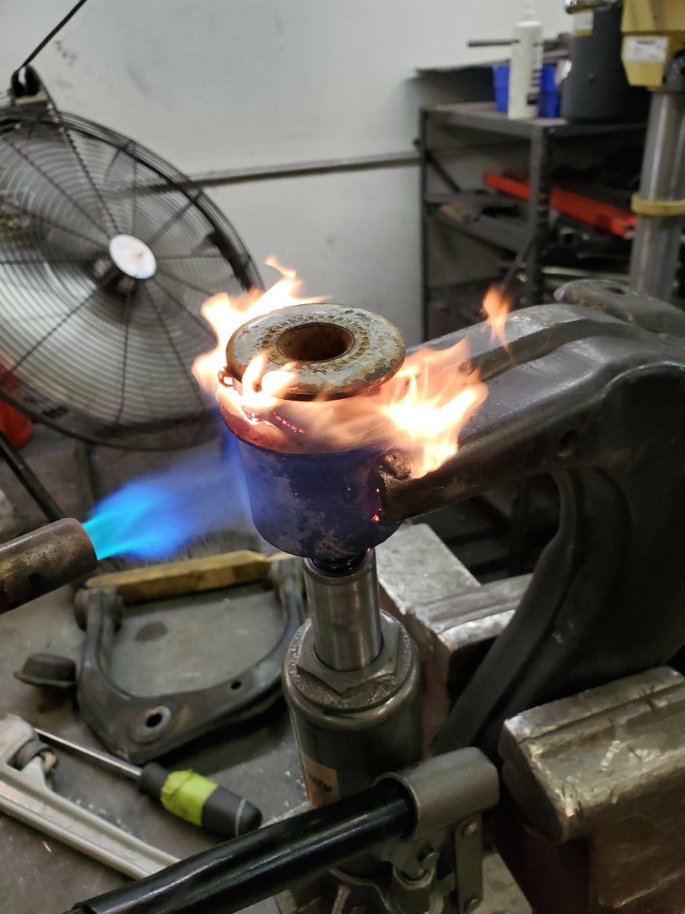

    Yeah, why I ordered them :thumbsup:. I'm going to kill the rest of it with fire and then follow up with something like this. Hopefully, that will do the job.
    Ouch, definitely feeling the same pain you endured.

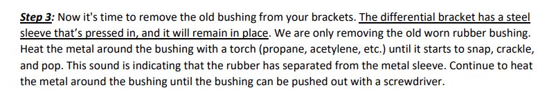

    So you actually removed the outer sleeve? I thought that was supposed to be left in (according to the instruction PDF) -

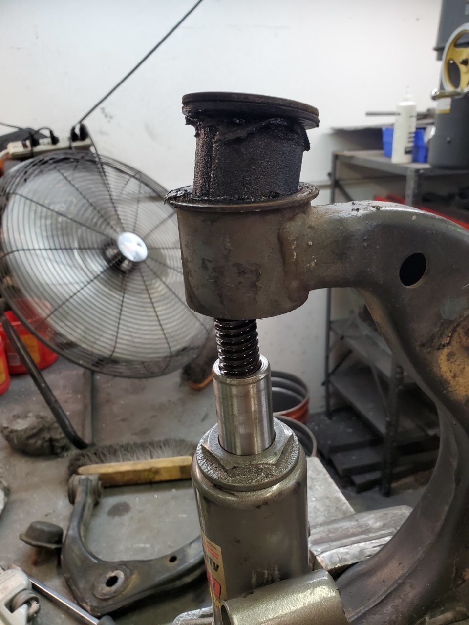

    Part of the trick is to find a press adapter so the jack pushes on the outer sleeve. If you push on the inner sleeve, the rubber just stretches. A bit of heat helped, too.
    That depends on the bushings you're installing. Energy Suspension keeps the original sleeve. Whiteline replaces it.

    The snippet I pasted above is from durobumps which is what I ordered. Thx for clarifying. Glad I don't have to worry about that part.
