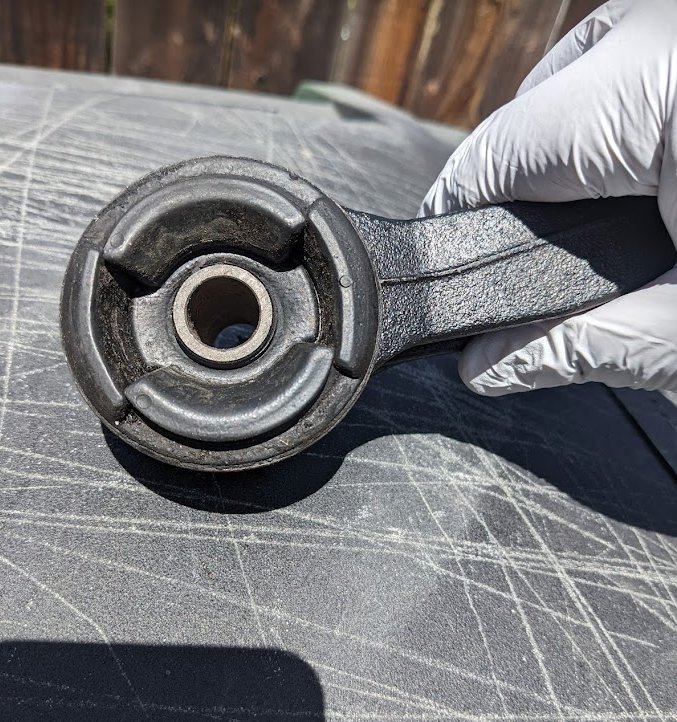

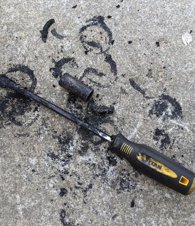

    Ok. Second try on the other arm. Much better progress. This time I only heated the sides of the arm around the bushing. Didn't let it catch fire either. When I started to hear popping, was able to push out the bushing 1/4 way with another screwdriver. Going to give it another go.
    Word of advice, don't do this wearing shorts and flip-flops lol.

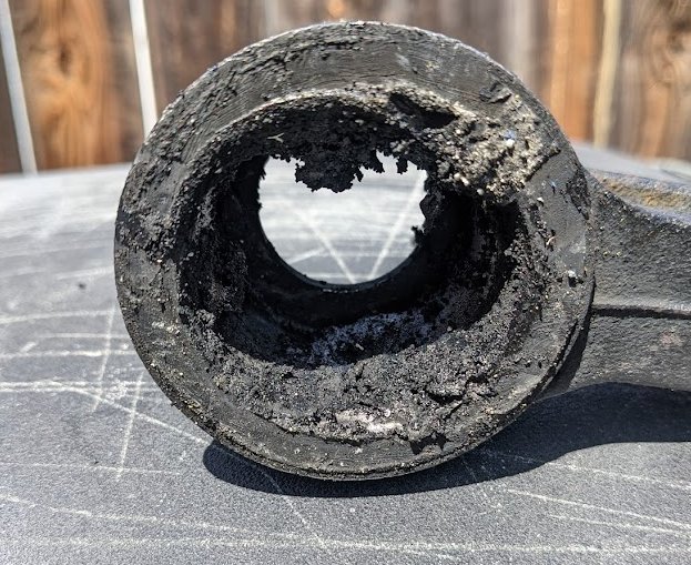

    As for the other bushing which I mangled, wire wheel on the drill wouldn't remove it.
    **Is there anything which will eat up or degrade that bushing rubber without damaging the arm?? Gasoline soak?

    Melt it out.

    Crap load of rubber still in there. I'd have to let it burn for more than a few minutes.

    We burned the center of mine out with an oxyacetylene torch, then pounded out the remainder of the outer sleeve with an air hammer.
    that rubber is pretty tough, I doubt gasoline would help much unless you have a very long time to wait
