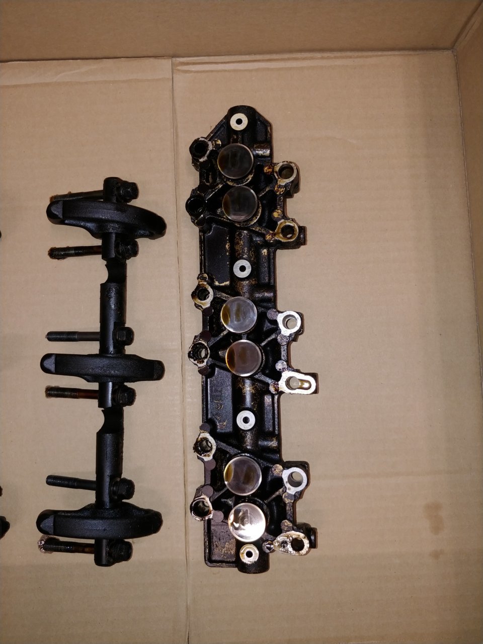

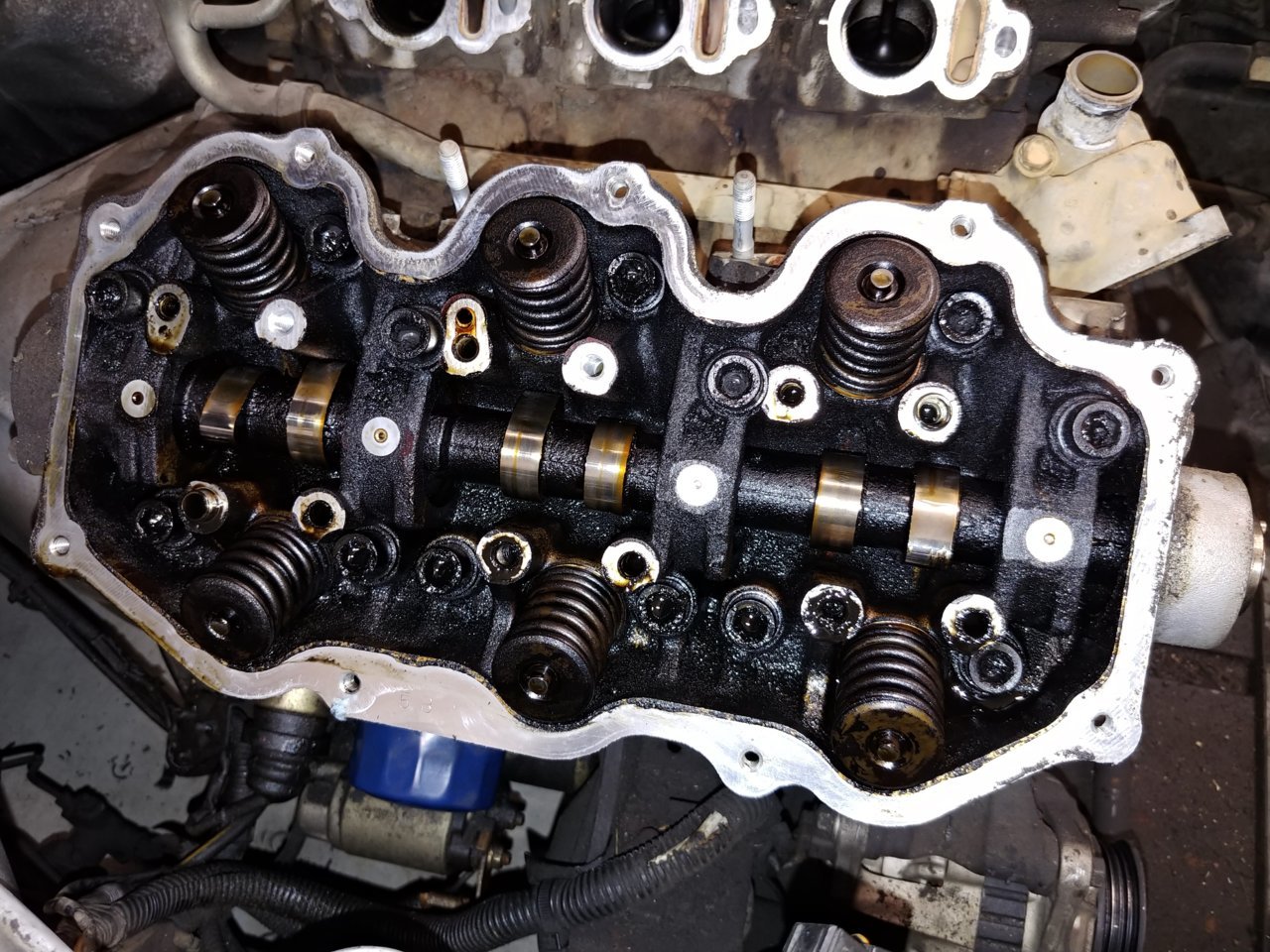

    She's got some nast, but the cam and lifters are perfect, no pits or anything...

    You’re having a machine shop rebuild it?

    Sorta, they're gonna check for warpage, cracks, if there are none then they'll clean it fully and replace the valve stem seals and regrind the valve seats if needed

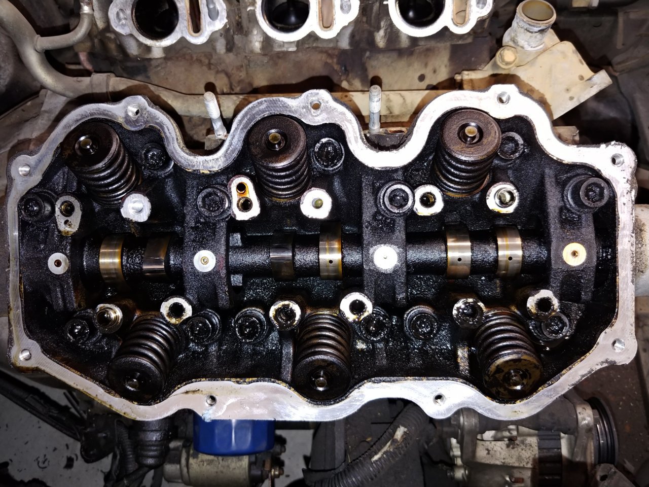

    Nissan sells you this old car in the turbo version with 6psi of boost stock. But they knew what you're gonna do so they built the heads with 13 head bolts per head, that's insane. 13 bolts for just 3 cyls. Go look up how many studs/bolts most common cars have... Even v8s.... This thing was built to take boost
    Look how many freaking head bolts there are
