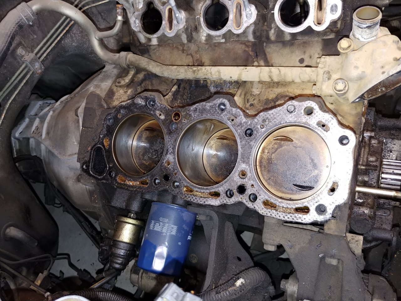

    I had a good feeling about this this old girl. 31 years old and 194k mi and she has clean piston tops and the crosshatching is still there and unmarred...
    And the HG was not blown on this side

    Oh gawd those coolant veins look scary. Is that rust, or just accumulated crap you can flush out?

    That's normal, the head has more water jacket cutout than the block so sediment and rust sits at the border like that. But yeah it's rust and sediment and I intend to flush most of it out, doesn't need to be perfectly bare metal to transfer heat well though so I'm not gonna acid bath it or anything. Just don't want chunks or huge buildups.

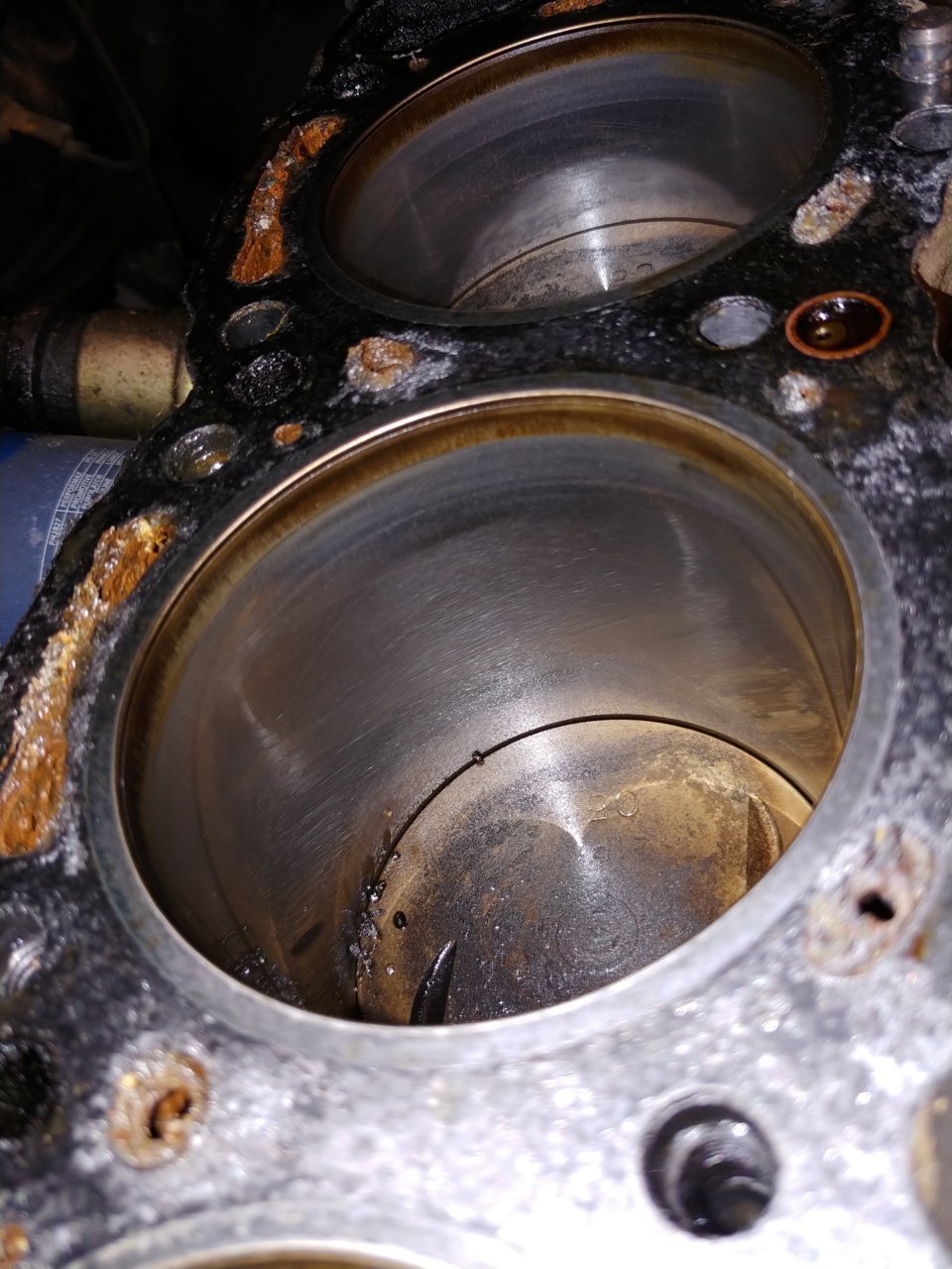

    On the piston tops or walls? Tops have some glaze but no huge carbon chunks so they'll clean with just chemicals. The walls are bueno though

    They don't feel glazed, I mean it's high mileage but not damaged by any means, might have more blowby than new though for sure haha

    You can identify glazing by a mirror finish that no longer retains the cross hatching in that portion or has new vertical scarring.

    Yeah they should be shiny unless newly honed
