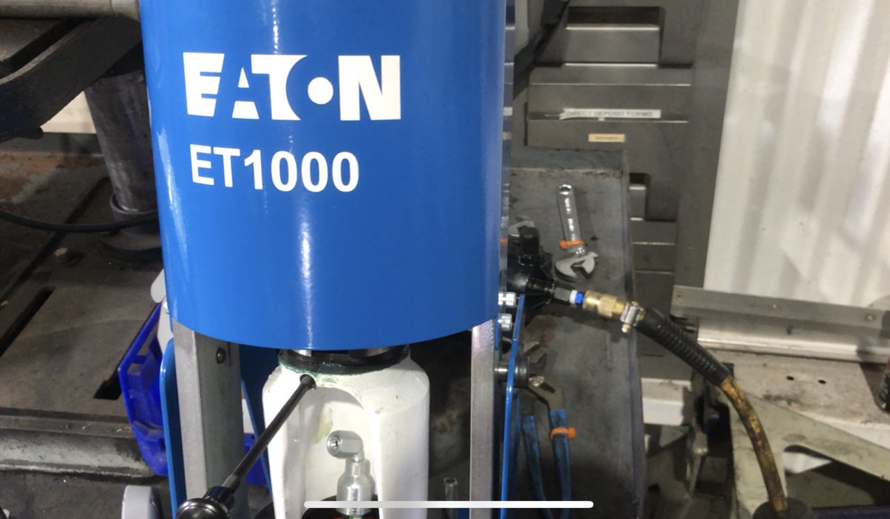

    Always always always make sure they only buy hose and fittings to match the crimper, in your case Eaton. We use Parker at my shop, brands do not mix well so don't let them start buying cheaper fittings.
    Make sure you get a lubricating spray (like a Teflon spray or something) and spray the die every couple uses.. it'll make em last longer and give a smoother crimp. Also make a guide to verify you have the hose seated fully in the fitting. we use a hunk of pvc cut to the depth of the fitting recess and then mark the hose with a paint marker, so when you push the fitting into the hose you have a visual mark showing you're in deep enough. Lubing the inside of the hose end will make fitting installation easier, I just use engine assy grease cause it's waaaaaayy cheaper than the stuff marketed directly for it

    Good advice, thanks! All this stuff is stocked by Lawson, and it’s all Eaton branded.
