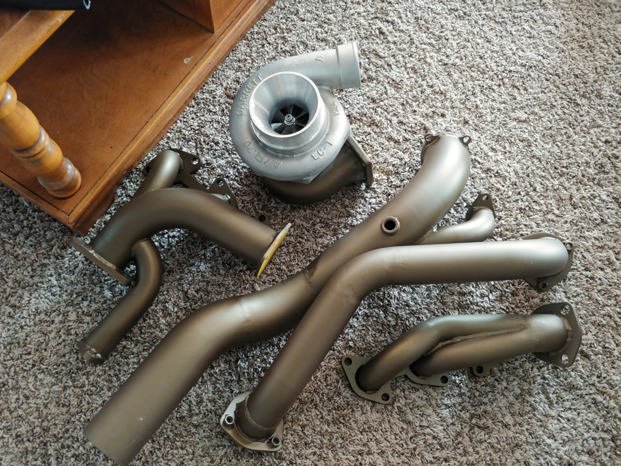

    It's less Tacoma and more mod
    Haltech baby, no more stock computer at all

    Ah fuck yeah, doing it the right way.
    Can't wait!

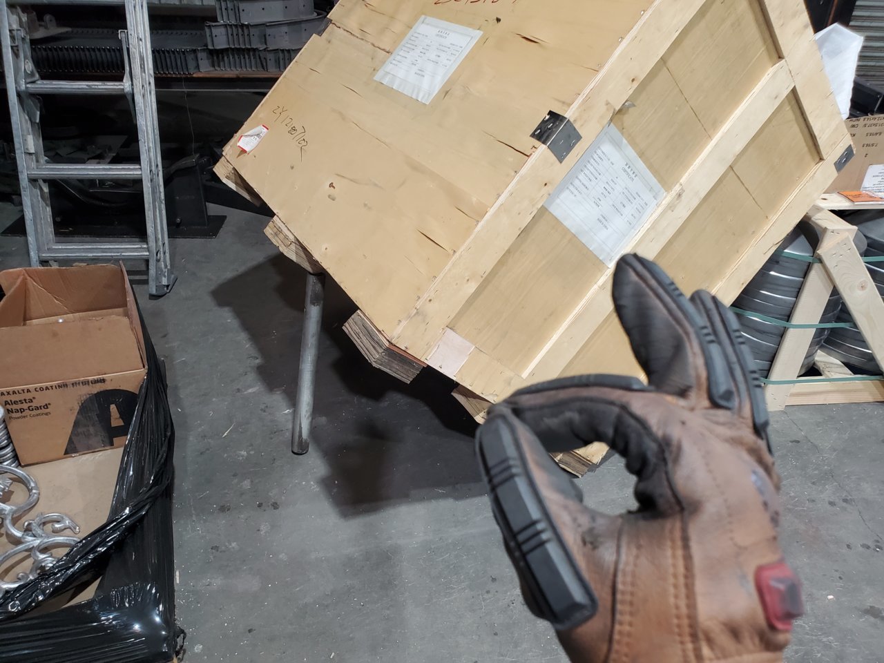

    Gonna catch a OSHA trainee in there

    I got hired at ups and was tasked with loading trucks with a forklift
    I had never used a forklift and I've destroyed thousand of dollars worth of shit learning
