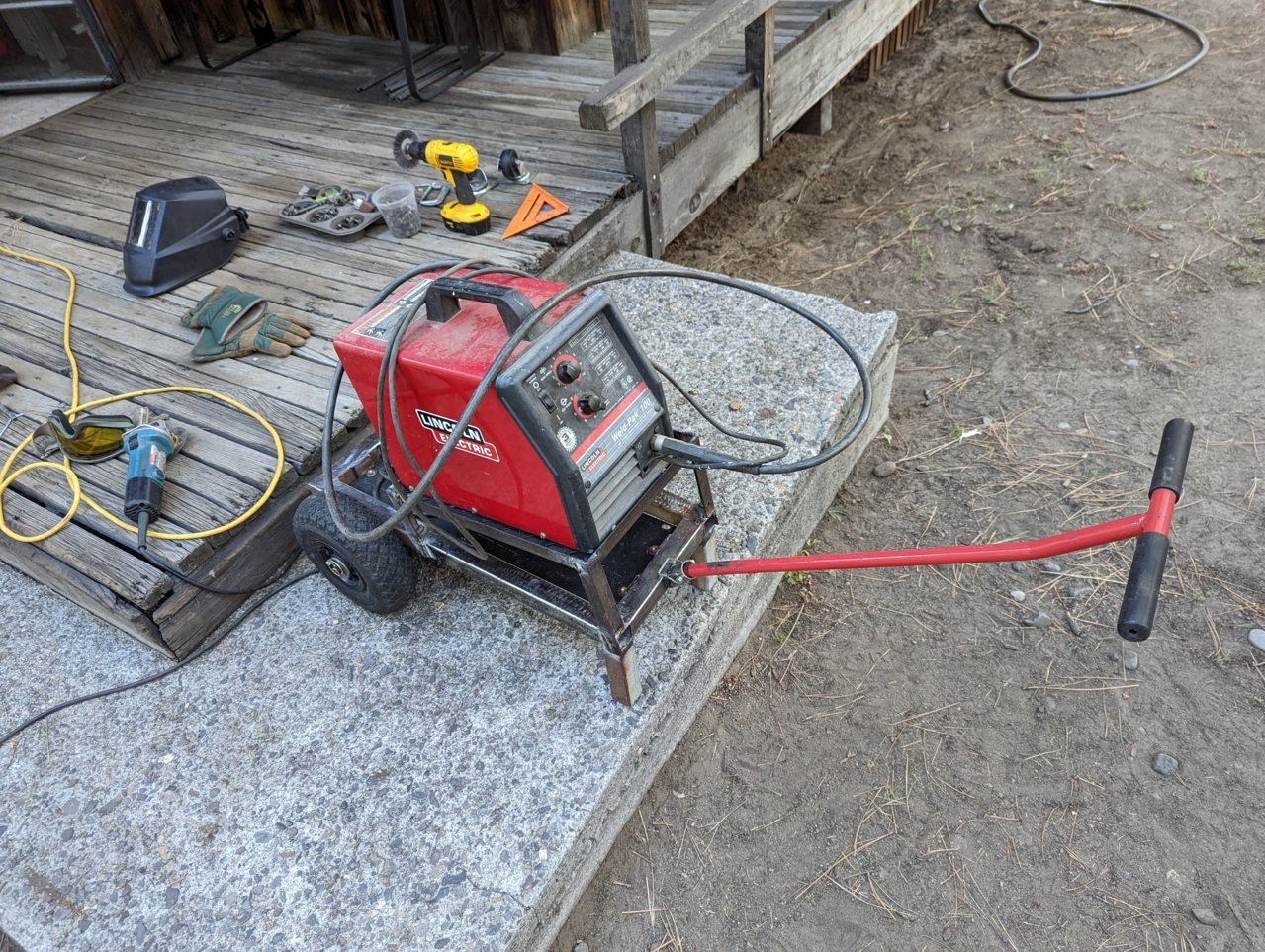

    got tired of dragging around the welder on my dirt driveway so I made an off-road welding cart yesterday out of scrap metal I had laying around. Still need to add some accessory hangers, clean it up and paint it.

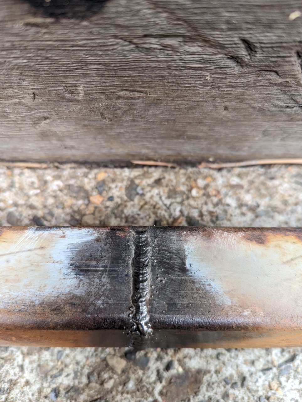

    Now let's see those welds!

    Not my best but not my worst. Getting a lot of spatter from the Flux core.

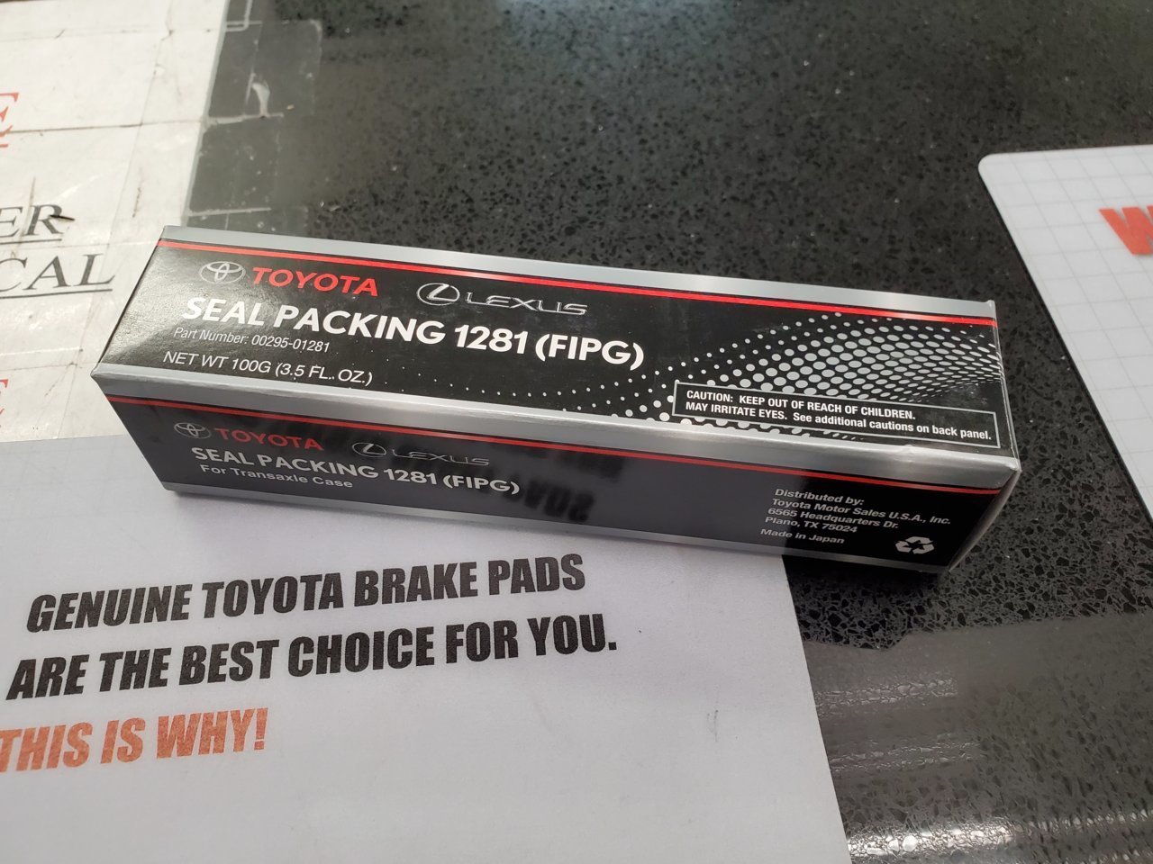

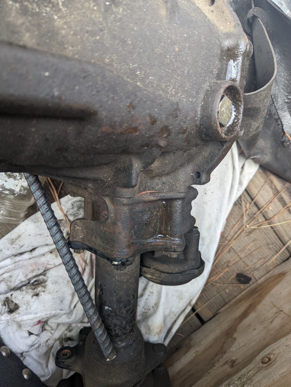

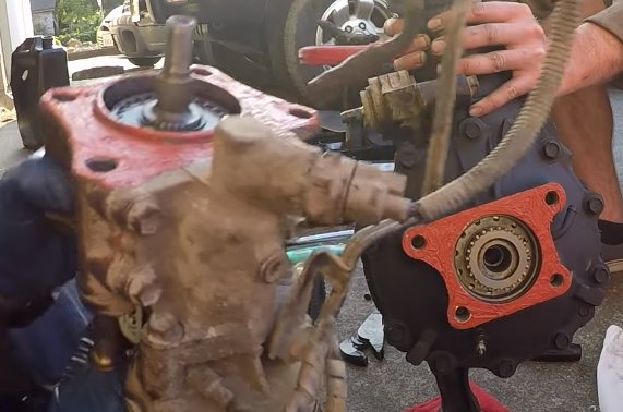

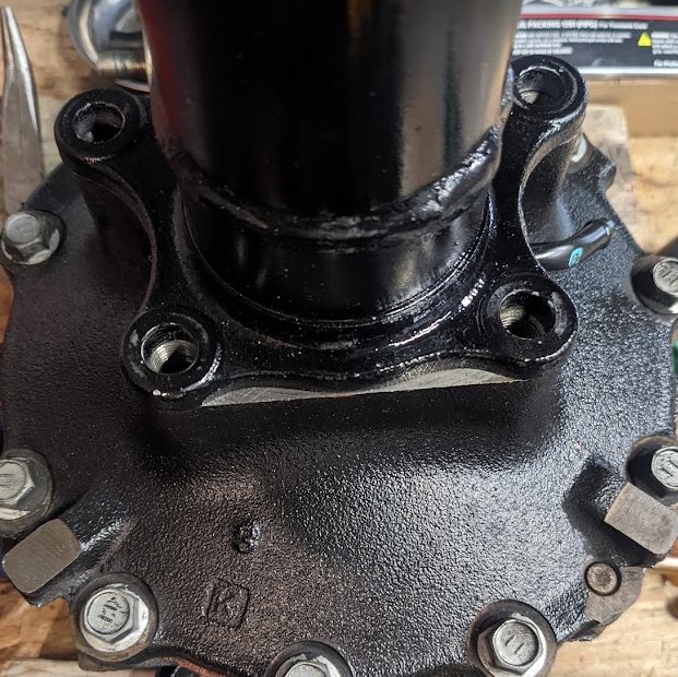

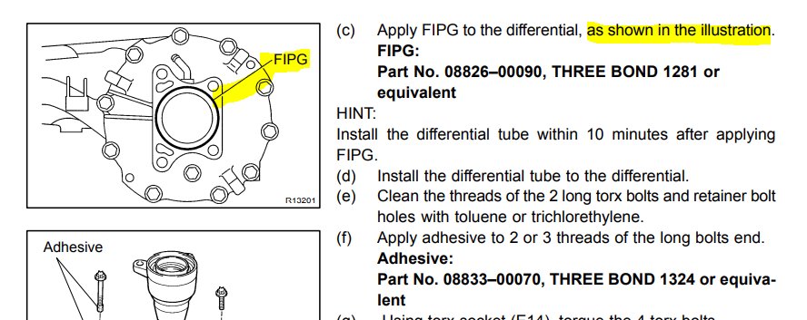

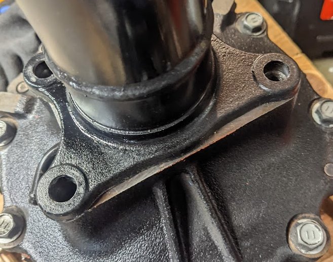

    So I am buttoning up the front diff, manual tube. Going to use Toyota's 1281 FPIG. Haven't worked with this stuff before and definitely do not want to :annoyed:
    The FSM shows - a bead like this.
    Also saw a YT vid showing this... isn't this a bit excessive? Looking for useful tips on applying this stuff. Thx.

  14. Jun 12, 2022 at 12:28 PM
    Kwikvette
    Feb 27, 2019
    #284735
    82,741
    Fresno County
    4 run, 2 don't
    Not bad at all, just use the little tool it comes with to roll/squeeze it out.
    Same stuff is used on an A340 pan -
    Used it on both the Tacoma and 4Runner.

    Never applied any but also never seen that much on any I have taken apart. Looking at the t100 diff I can see a little squeezing out.

    What's not bad? The sealer itself or the application in the second picture (which was done by squeezing it onto a finger and sandwich spreading it out)?
    Yep, that is how the one I have here looked from the factory. Doubt it was ever opened. Just a little bit visable. Also wasn't as much to scrape/clean off. That second pic, damn if it doesn't seem like way too much. Again, I've never worked with this stuff so WTF do I know... lol

    Holy smokes batman

    Both, although I probably wouldn't use my finger.
    You'll find that Toyota was a bit excessive themselves with the use of FIPG. If you've taken apart a front diff, transmission pan, and other stuff where FIPG was used, you'll see it seeps out along the edges.
    I'd run a thick bead and let it work itself outward as intended.
    Of course, ensure all mating surfaces are clean.

    That tool it comes with is perfect for toothpaste, down to the last drop

    The transfer case was slammed with excess when I took it apart. Not so much with the diff tube though.
    Ok, thanks all. I'm going to follow the FSM's example for the diff tube since it doesn't really have that much of a mating surface area.
